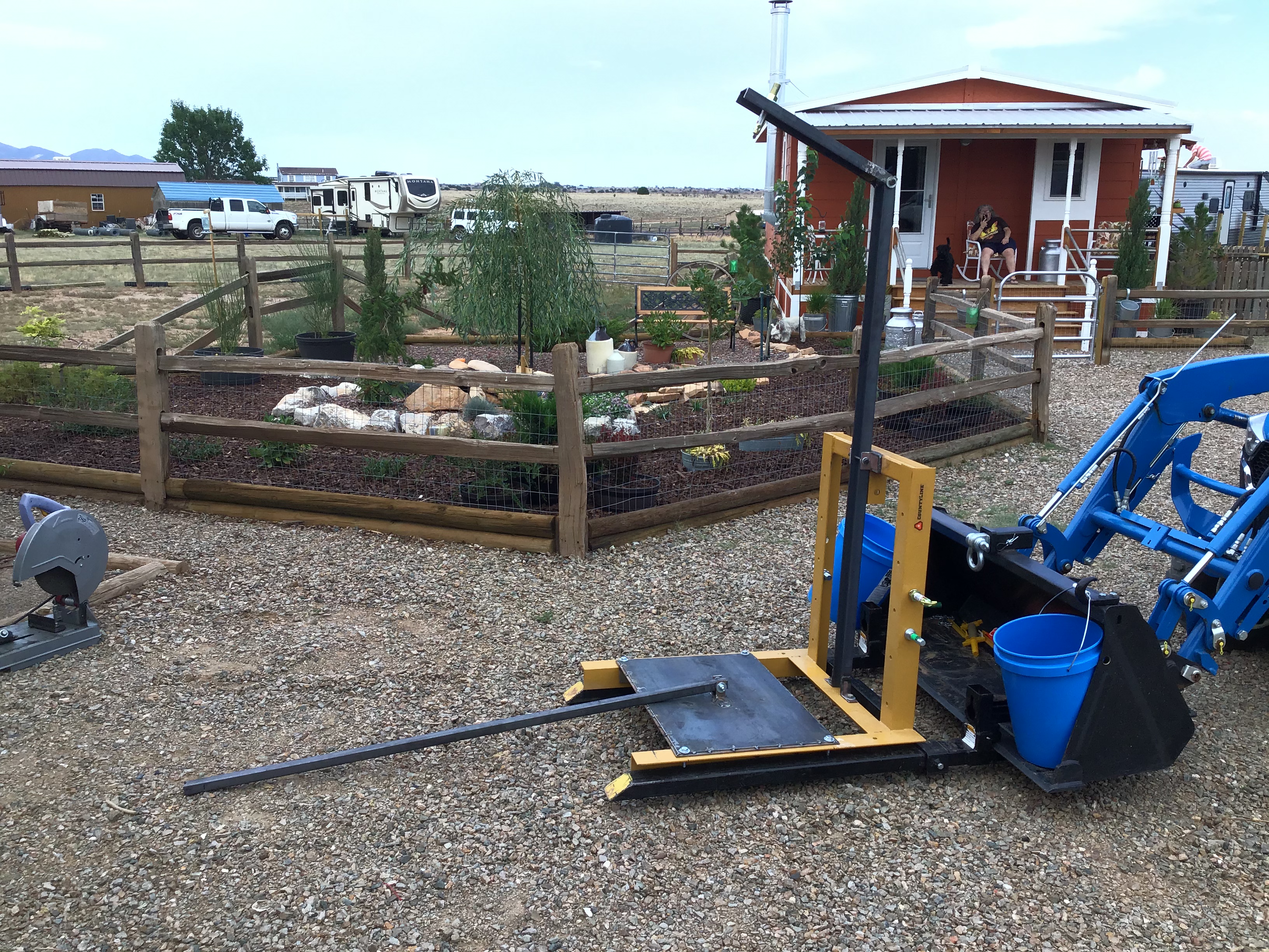

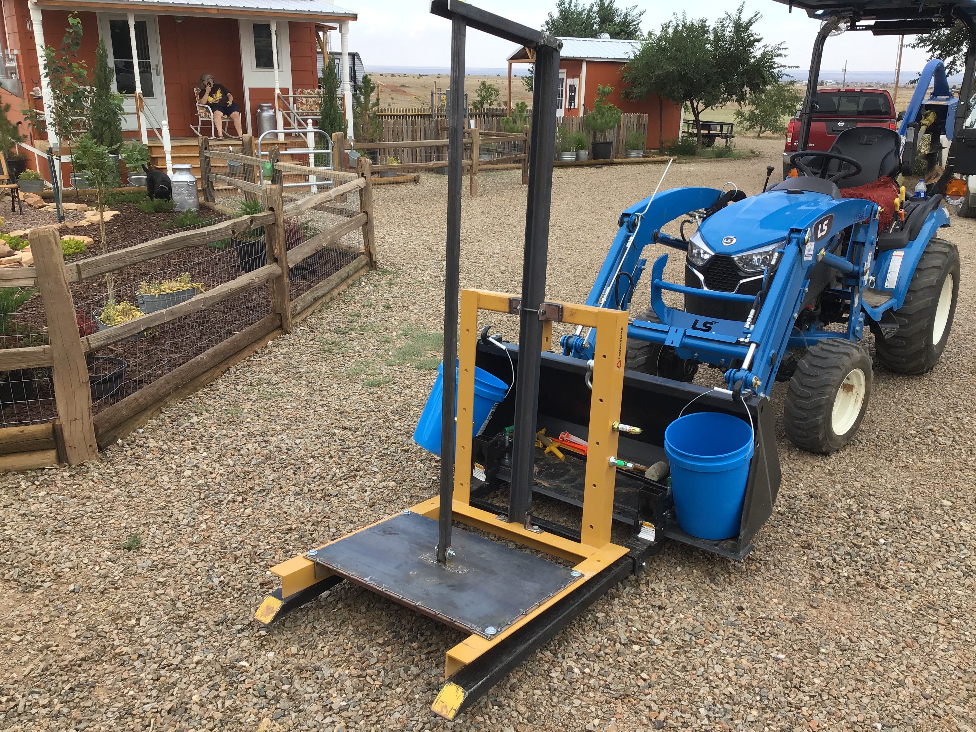

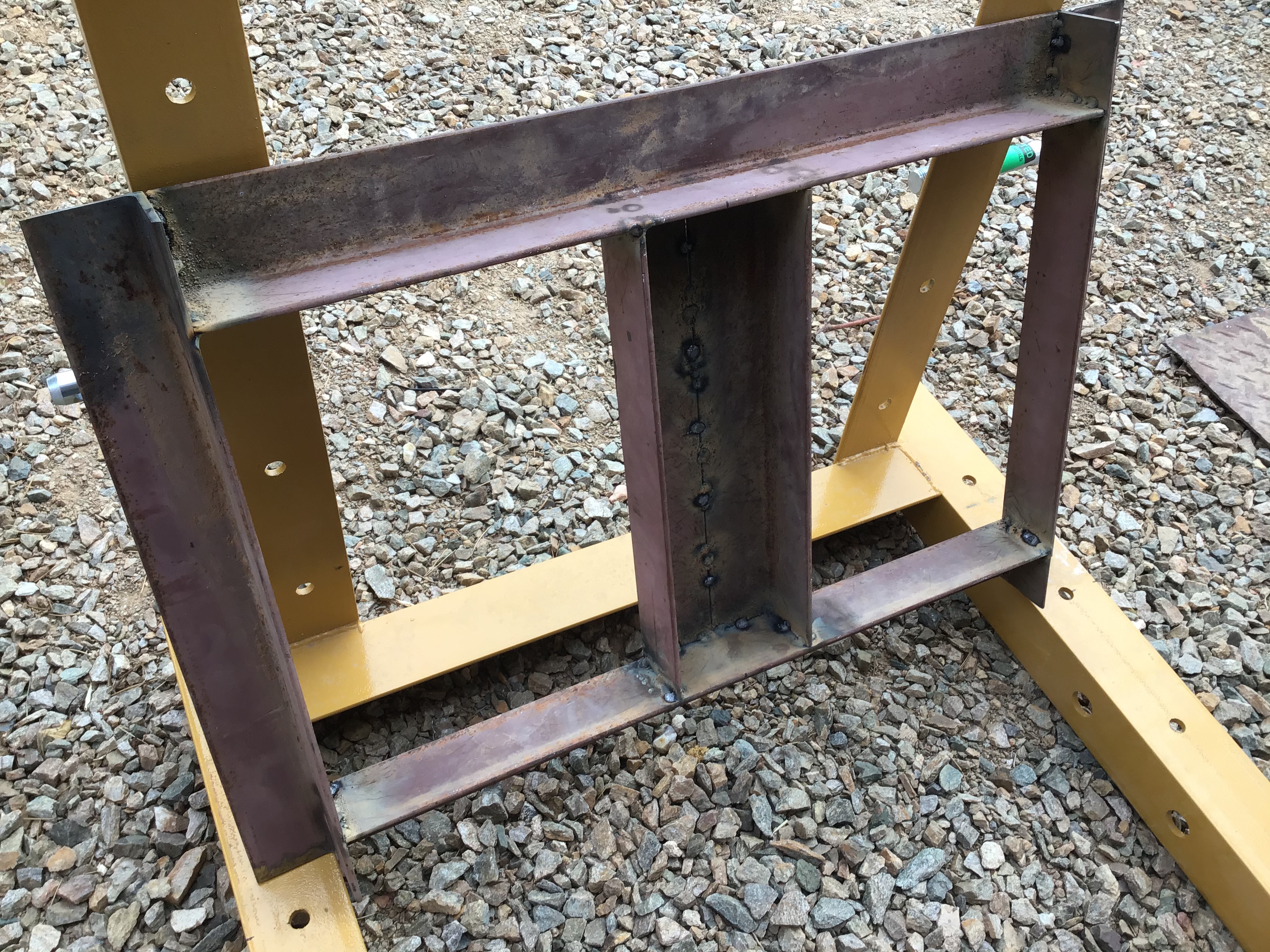

My neighbor tried to order a Titan wire fence unroller from TSC. After 2 weeks, TSC told him that it could not be shipped to our local store.... REALLY? He ordered it in the store, right off of their own website!

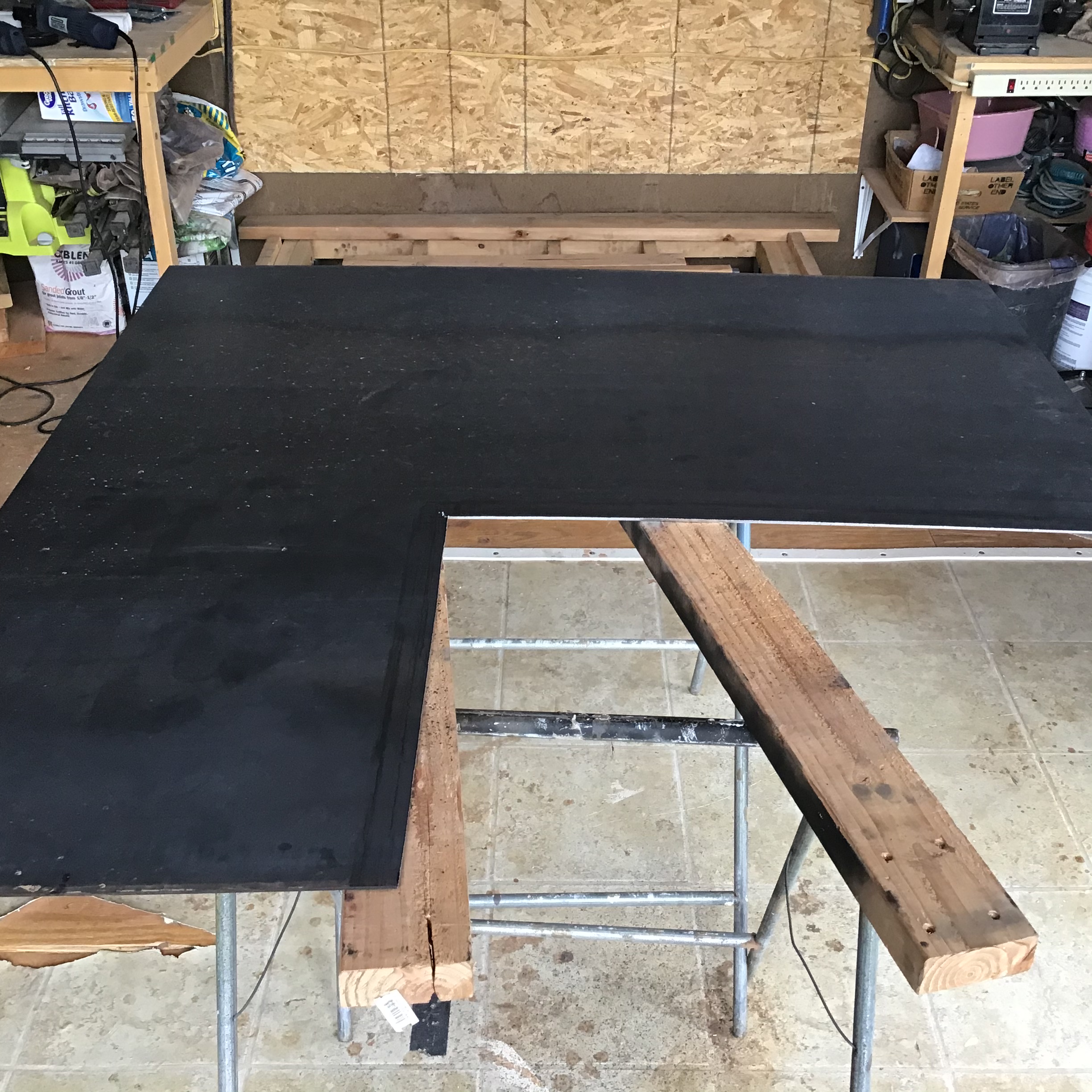

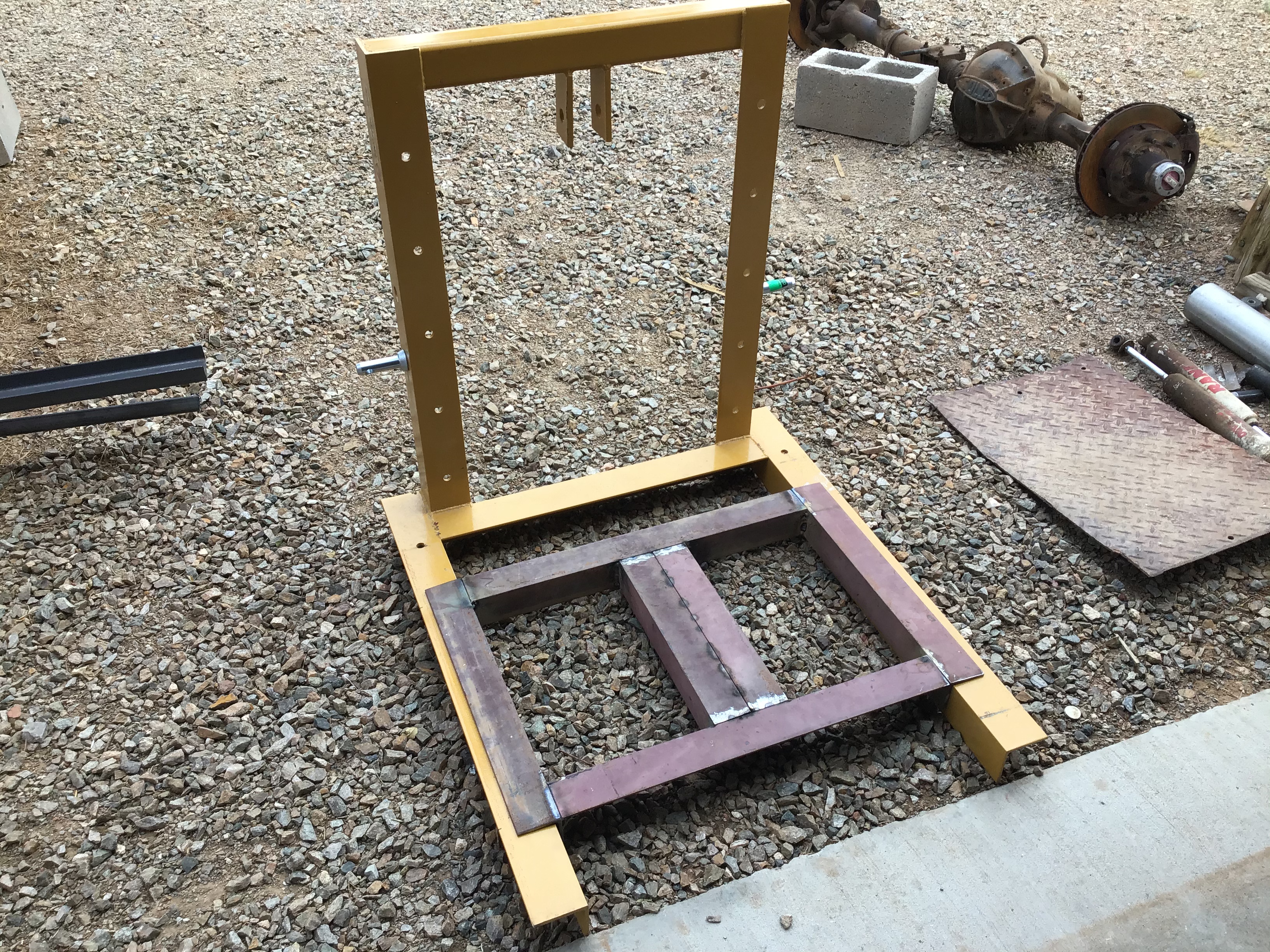

So, fall back and punt.... he bought a carry-all at a third of the price. I made a frame to go between the carry-all arms, put some steel plate on it, and welded a bracket on for the post. Added a c-channel frame to the back, hinged at the top to lower onto the center post. Everything is bolt together, so it can be multipurpose as a simple carry-all too!
Here are a few pics....
   / Homemade fence unroller
#2
Well, here they are...

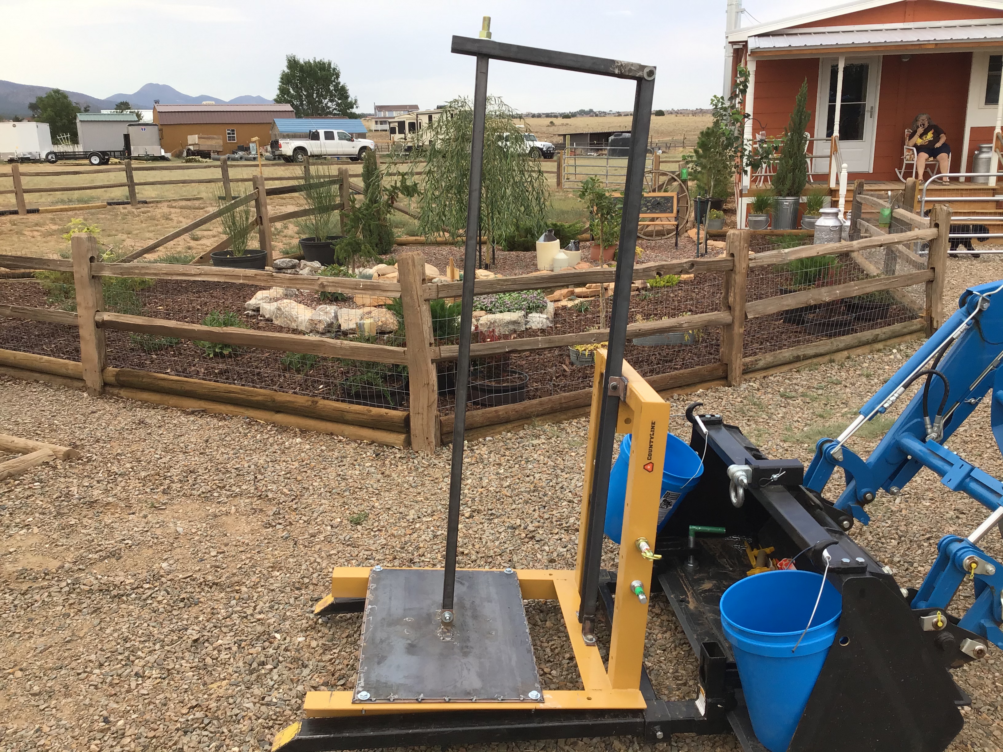

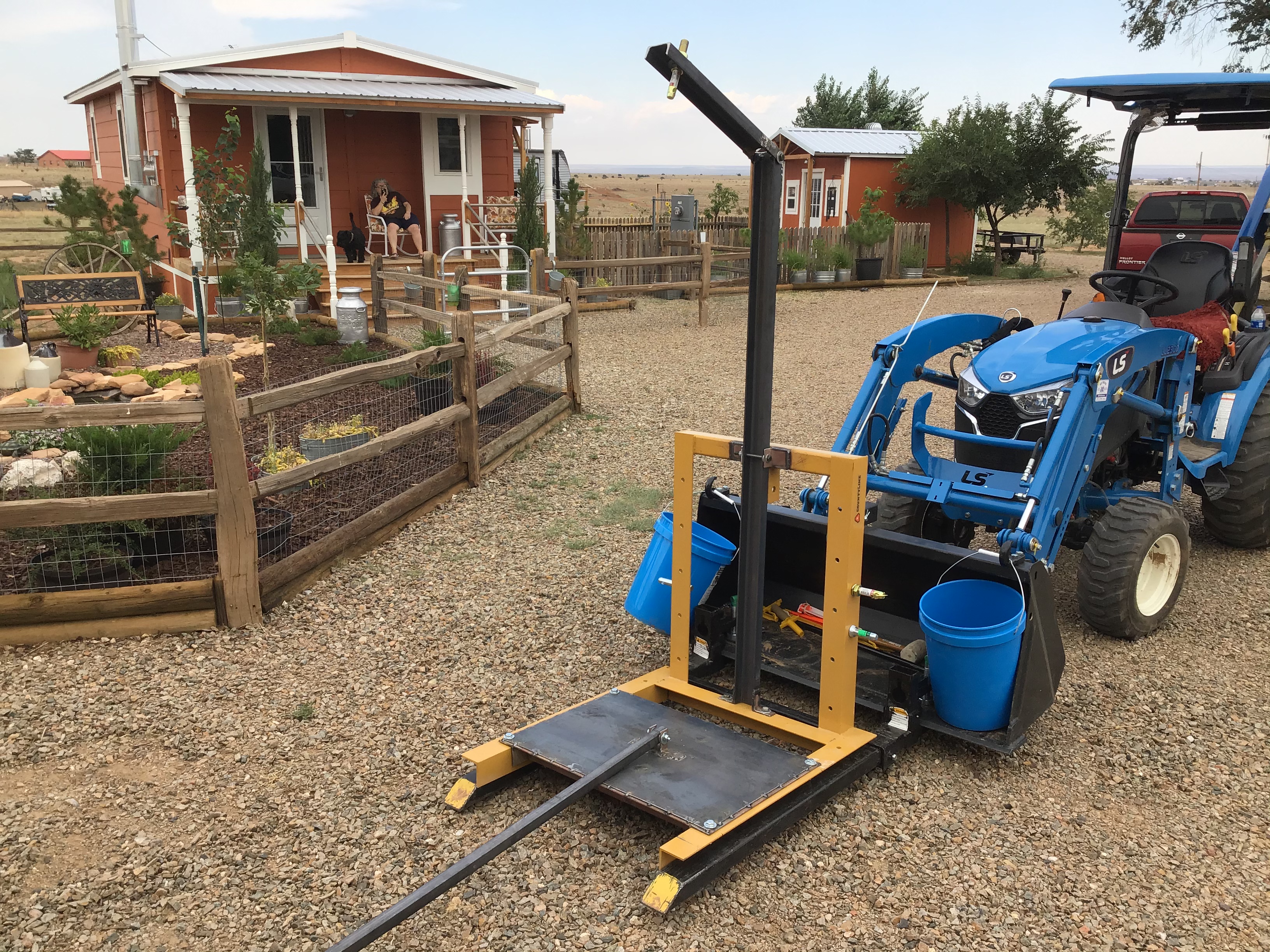

And a few of the finished fence unroller....

   / Homemade fence unroller #5
Great piece of engineering. My only concern is that it "appears" as though the bottom bolt on the vertical shaft to hold the fence roll, may protrude enough to get hung up in the fence roll. Could be just the angle of the pic, but wanted to share my 2¢.
I was concerned about that too, so the bolt is sideways to start, we'll see if it does snag. A simple solution already planned if it does, is a roller guide at the base. Just some 4" bolts vertically, with some 1" pipe around them. I'll mount them just behind and off to the sides (about 10 and 2 o'clock). Might add one on the top arm also to keep the fence roll vertical.
