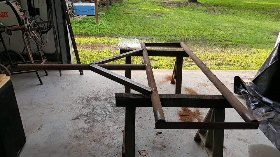

Good Morning All,
I have been browsing the interweb for some time now getting ideas for building a cultipacker to use on our few acres of food plots at the property. I got quite a few ideas from this site as well as others. My original intention was to build this nice quality showpiece with my amateur welding skill set. However this weekend I was over at my folks house and we were discussing the build and ideas. Well the redneck ingenuity of my Step Dad sparked off a good and cheap idea. He had an old piece of 2.375" downhole tubing and a piece of 2x2 angle laying around, which he was sure we could whip up a frame out of. Well he was right. Due to the recent installation of a pacemaker for my Step Dad, the welding was left up to me with my very limited practice. I think we are making good progress though and I am keeping my fingers crossed that the welds hold up. The welds are ugly, but I think they will do the trick.
We built it a little oversized, so I think it might end up looking funny with the 9.5" wheels, but as long as it gets the job done that's all that matters. It's 6' wide x 2' deep with a 4' tongue.
All that is left really is some flat stock to make a hitch, the cultipacker wheels that I will be ordering from Agrisupply, the bearings, and an axle. After we get it all together, Mom wants to pretty it up by knocking all the rust off and painting it Kubota Orange.
Can someone point me in the right direction to get some quality pillow block bearings?? I have been trying to find a source, but not having much luck. I either find the cheap bearings from Agrisupply/Northern Tool or ultra expensive. If the ones from Agrisupply or Northern will work fine then I will go that route, just read were some had issues with them. I don't mind paying for quality, but don't really want to drop a couple hundred bucks on bearings either.

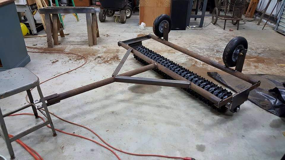

Made some more progress. Decided to pick up some 13" wheel borrow wheels from TSC for the flip over wheels. I have a feeling its going to be a pain to flip over, but we will see. Might have to find a different way to mount them if it's too hard to flip. We will see. Also welded up a hitch. We are also going to extend the bearings down for the packer axle about 4" so the packer will be closer to level during packing. Plan to use a 2" receiver hitch without a ball to hook up. Going to use one with a 2" drop and turn it upside down to use on the back of the UTV. Will hopefully have it operational by the end of the weekend.

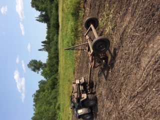

Here's the one i built out of an old car dolly frame. I got the axle and packer wheels off from a brillion packer that was being torched for parts. The tounge is from the original dolly frame and is pinned so after it's flipped i can pull the tounge out and flip it as well. The only problem is flipping it back from packing side to transport side. Wheel location and weight didn't turn out like i wanted it too. But it works.

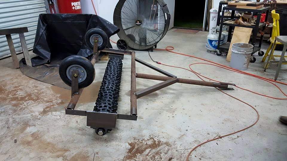

Finished up the cultipacker earlier this week, just haven't had a chance to update till now. Overall I am happy with the way it came out. It's a 2 person job to flip it over due to the weight coming down. In hindsight I should have thought the design out a little different to move the wheels forward 6"-8" so you could stand it up on end easier and move around to the other side. I think this would have made it a 1 person job to turn over. Either way I think it should do the trick. Ended up with 64" of packing width and I am estimating it to be around 400 lbs. Hopefully that gets the job done. If I need more weight I have room to weld on some expanded metal to the top side so I can add weight when needed. Can't wait to get it up to the property and try it out.

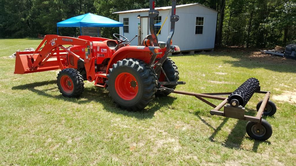

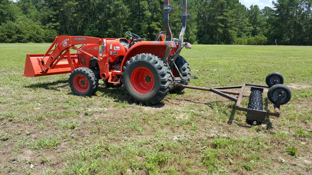

Well it works! Went out next to my fall plot that failed last year, due to my bad planning and follow through, and disced a few rows then pull the packer over it. I didn't do a real good job discing and compounded the old rows that are already in the pasture from a previous owner, which caused some pretty bad high and low spots. I will have to make sure and try to get rid of those rows this fall and probably pull a harrow behind the disc to level it prior to packing. I will probably need to add weight to it as well. It was doing a pretty good job, but think it might do better if it were a little heavier. May weld up some expanded metal to make a place to throw cinder blocks on it or something. Should be fun to see what difference it makes for this years fall plot. The packing height behind the tractor is a little low cause of the height of the draw bar, but behind the UTV it should be perfect. The traveling height is perfect behind the tractor, but will be a little nose down behind the UTV but that isn't a big deal. Overall I am pleased with how it came out and how it works. Hopefully it makes all the difference when planting this fall.

You may not need to add weight if you can smooth it out prior to running the cultipacker. Where it contacts the soil it looks pretty good to me.

It looks great, and I'm sure it will serve your needs, but... you mentioned adding a "basket" that you could throw in some cinder blocks, to add weight. That would certainly work to add weight, but I am guessing it would be a pain to have to remove them every time you flipped the unit over to transport. Now if you don't need to do that often, then it wouldn't be a prob. However, if it needs more weight, I would suggest just welding some extra steel weight on it, or attaching something permanent (like the blocks) where they couldn't "fall out" when you flip. Otherwise, great job!

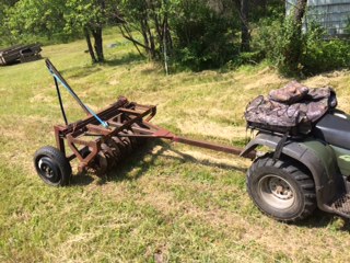

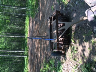

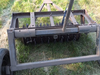

I found an old cultipacker in a farmers junk pile and bought it for scrap price. The intention was to build it for use with the atv. The 6 foot lead was in bad shape as were the two side pony sections. After disassembly and rebuild from available pieces there was one complete four foot section. The hunting land has several food plots with some rough trails that need to be traveled. Travel wheels where added. Works good for the intended purpose.
