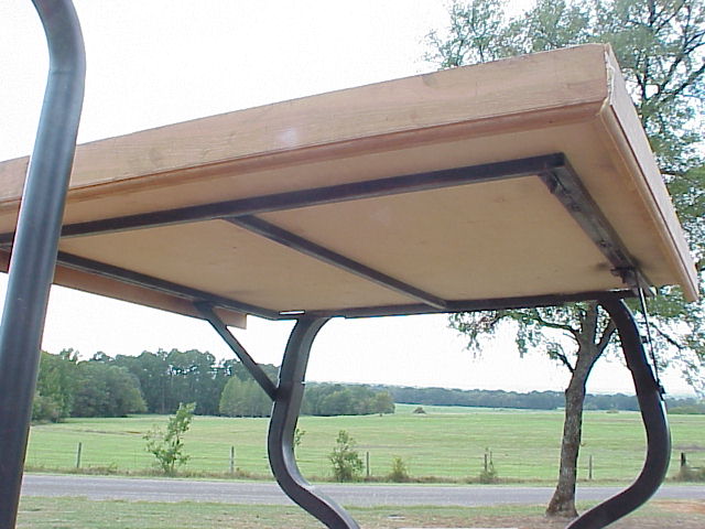

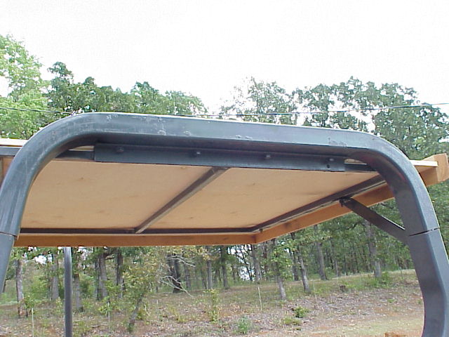

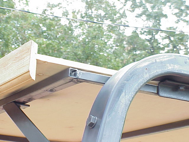

Of course, this one takes a beating to!! Simple 16ga square tubing frame and 1/2" ply. Drilled and tapped mounting holes in the top of the rops, using the rops bolt for the support arm.

:D Just under the height of the rops. But this one is pretty strong, if I'm going through the woods slowly, it'll stop the little tractor. The other day I caught a limb gong a little faster, it bend one of the supports and angles the top down. Couple wacks with the 6 pounder and it was as good as new!! Lets see a tufftop do that!!

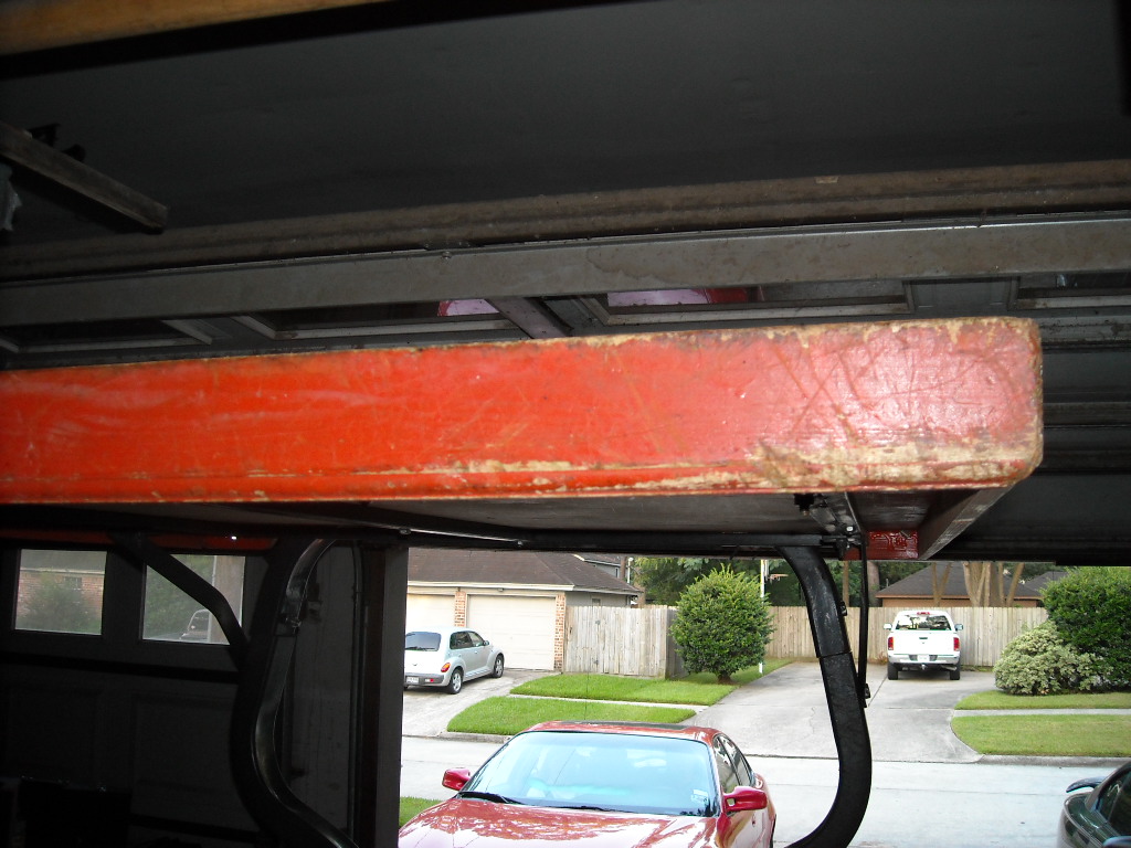

For years I never had a tractor with a ROPS. Then my "helper" borrowed my little Bota and slowly rolled it onto its loader frame while trying to carry a rock over uneven ground. When I arrived he was just changing his drawers....My next tractor came with a ROPS. Now it has a 1/2" plywood sun/rain/snow roof. This roof holds the radio,speakers, front and rear driving lights, cigar lighter/power outlet etc. The rear is clamped to the ROPS and the front is supported by two uprights bolted to the loader frame.
These uprights are in just the right place to grab when climbing onto the tractor and have the light and radio switches mounted one above the other on the left hand one. This winter I hope to hang a piece of lexan between them for snow plowing

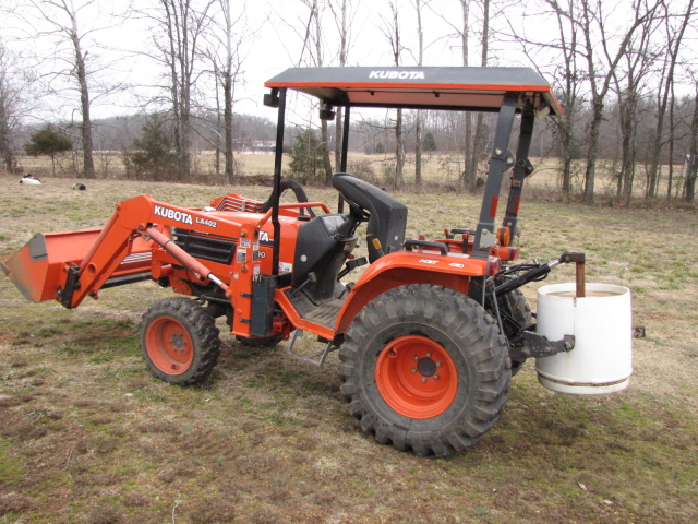

There are kits that mount to the fender frame, etc. My BIL uses one on his Ford 6600. they are not very strong so you have to stay out of the trees. Aprevious one he had was sort of nice, it would lay back flat if you get in the trees.

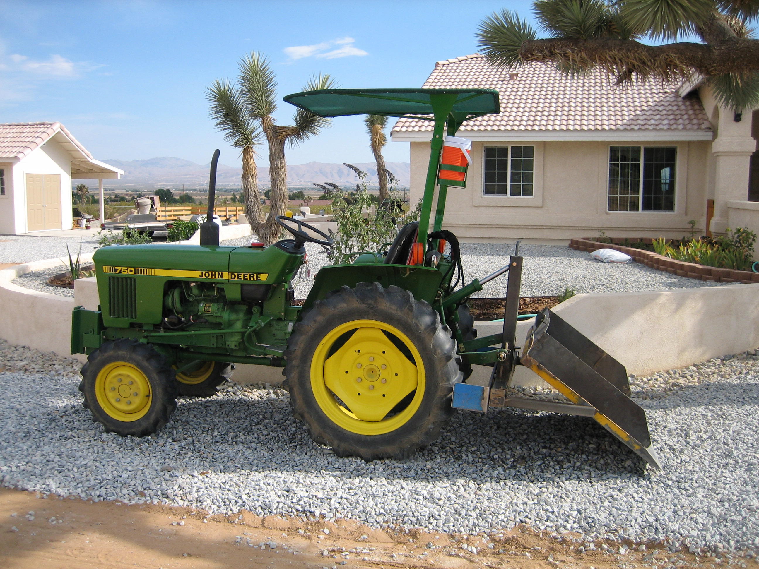

This the one I made for my B7800 and it not cost much at all maybe $75.00 to $100.00.
