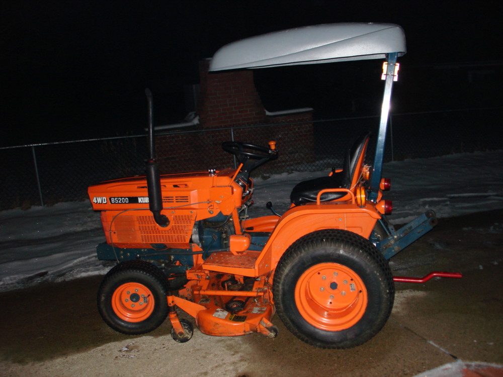

Well, my car luggage carrier conversion canopy is finally done.:D

Neat idea Camo. Looks good. You should start a new thread and tell us the story behind the idea.

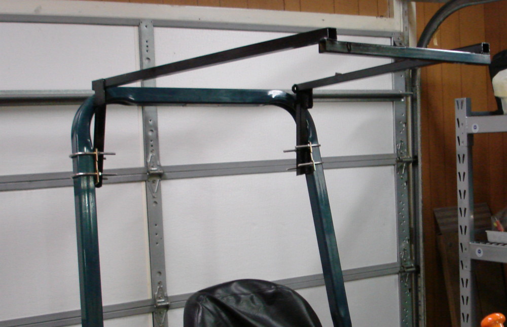

Not much of a story really. A member on another site actually mentioned it, and had a full luggage carrier lid on his tractor. I looked at it and thought how much it would look like a purchased canopy with just a little trimming. So I located a used luggage carrier locally that someone was giving away, and bought 116" of 1" square tubular steel, 4 u-bolts to go around the ROPS, and some misc. plates from around my shop. About $80 in steel, and about 4 hours of my time to build a frame and trim the lid. The sizing was perfect!!!! it makes it to the end of my steering wheel. Will make my work alot more comfortable.:)
