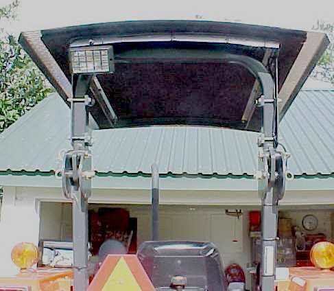

Well, my car luggage carrier conversion canopy is finally done.:D

/ Homemade Canopy #24
Neat idea Camo. Looks good. You should start a new thread and tell us the story behind the idea.
/ Homemade Canopy #26
Not much of a story really. A member on another site actually mentioned it, and had a full luggage carrier lid on his tractor. I looked at it and thought how much it would look like a purchased canopy with just a little trimming. So I located a used luggage carrier locally that someone was giving away, and bought 116" of 1" square tubular steel, 4 u-bolts to go around the ROPS, and some misc. plates from around my shop. About $80 in steel, and about 4 hours of my time to build a frame and trim the lid. The sizing was perfect!!!! it makes it to the end of my steering wheel. Will make my work alot more comfortable.:)

/ Homemade Canopy #30
NH1520 and others:
The only thing I can suggest for any canopy is to add a set of front posts to it. No matter how sturdy the frame, and how tightly its bolted to the ROPS; there is a heck of a lot of cantilever in every canopy design whether factory or home made. Mine bounced around and made a lot of noise with every good sized bump I hit. Adding front posts got rid of the bounce, vibration and noise.
Though I doubt nh1520's canopy mounts will break, having an 80 pound roof hanging out there like that could be dangerous should there be a structural failure and the canopy decides to get up close and personal with your body.
In any case, having a roof over your head in the sun makes a canopy well worth having.
/ Homemade Canopy #31
This roof probably weighs in at around 10-12 lbs, so the weight is not nearly what a metal one would be. On a smaller tractor like this one, space is at a premium for me at 6'2" and 275lb, so I solved the support factor by triangulating the rear corners. As in any fab project, I'll check it out with use, and add any changes down the road as needed.;)

Hey you guys, sorry I have not been around in awhile. I guess I just got lost somewhere with too many projects around the house and a new job since I lost mine old one after 29 years with the same company. Anyway I'm back - but as nh15201 since I couldn't get any reponse from the admins after I lost my password (old age I guess).
My homemade canopy has been giving me excellent service with no attention to it since I installed it. The wing gussets clamped to the ROPS and welded to the frame has stood the test of time with no undue vibration or cracking. At the time I thought I may have overdone the gussets size wise - but now I'm glad I did. I do get some vibration once in a while - but nothing real annoying. The steel canopy has really saved my noggin' a couple times from limbs. The AL diamond plate from an earlier post would also be an excellent choice for a canopy - lighter than the 1/8" steel I used and ever needs painted.
