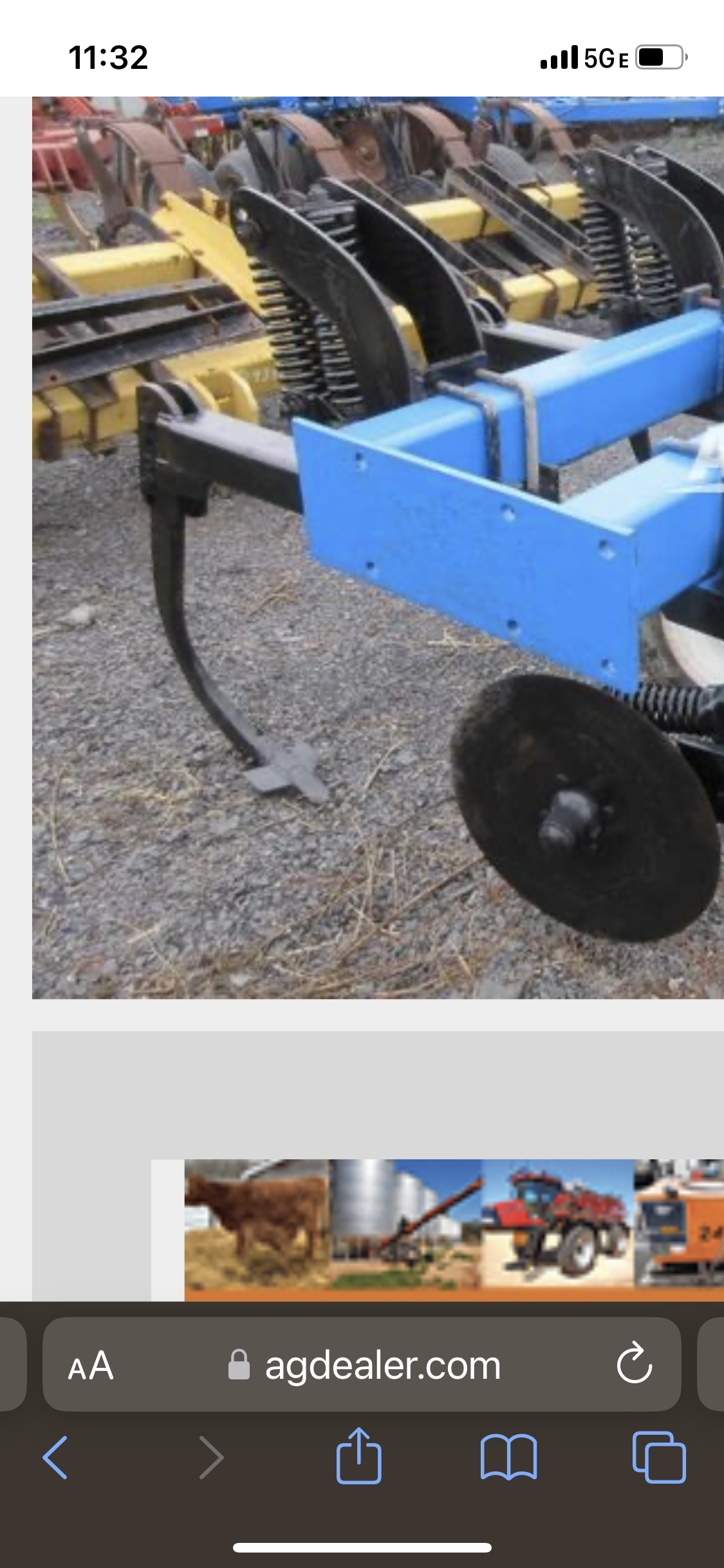

My father in law had a big DMI subsoiler took +250 HP to pull.
It had small wing type protrusions on the replaceable tooth to increase the scattering of the soi hardpan. As your subsoiler pull easy enough adding the wings may help loosen your soil.
   / Homemade 2 shank subsoiler #55
I agree. Add a ~ 6" shovel (wing) to the chisel points you have now for a greatly improved shattering of dry soil.
