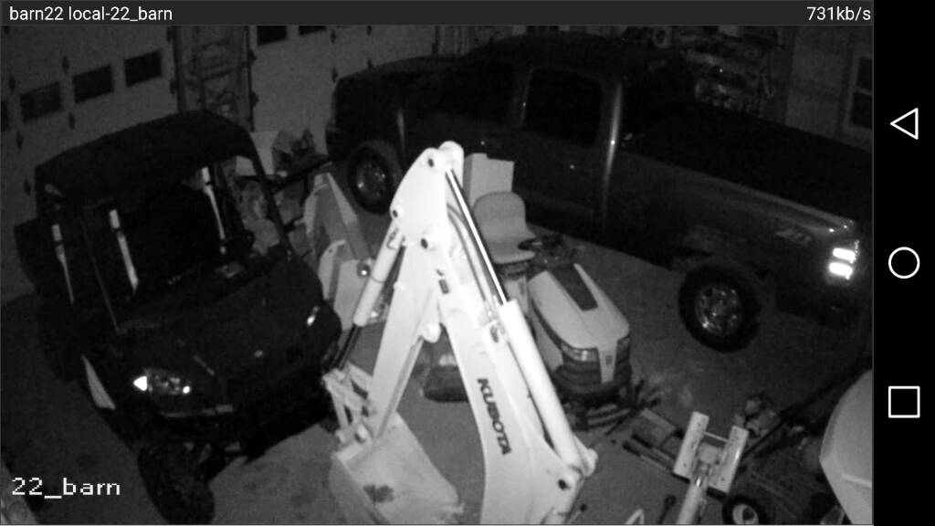

So Im lying in bed, can bring up my 3mp camera in the barn, using my phone.
This camera is connected to my network using IP over AC power, running on an extension cord.
Yep, havent ran power to my barn, my barn network comes to my house on an orange power extension cord. I wouldnt worry too much about 5e or cat 6.
There are no lights on in the barn, just the camera IR. Screenshot_2019-02-13-22-02-32.jpeg

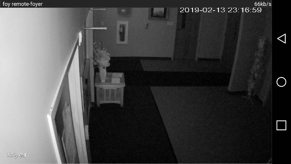

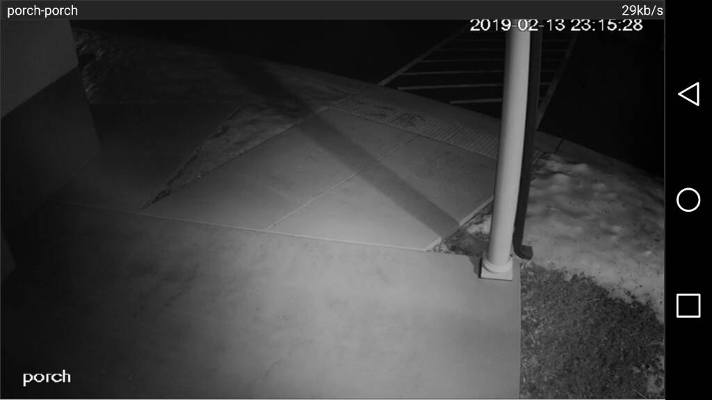

Couple more phone snapshots of remote cameras, that i can bring up on my phone. These 2 will notify my phone if there is motion detection.
Again, no lights on, just the camera IR.
