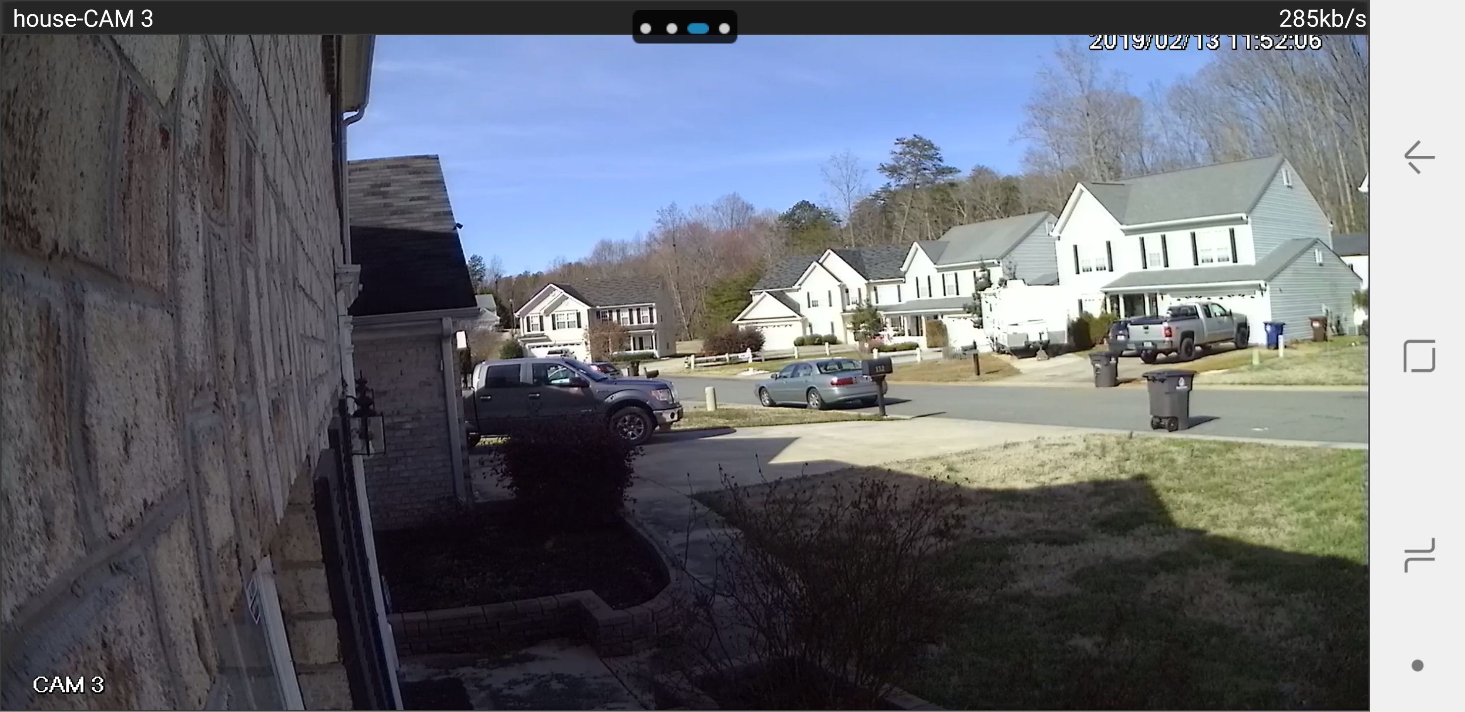

I thought this would be a good angle and coverage for package thieves or people messing with cars in driveway. Pretty much good coverage of front side of house.
Seemed like a good idea, but reality is camera is too far away to be useful. Obviously phone screen shot and on a bigger monitor the picture can be more detailed, but would I really get a good shot of a package thief at front door? What if someone was messing with my truck - would that picture be useful?

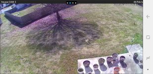

Next bright idea was only 1 camera to cover whole back yard (small, i'm on a 1/4 acre lot). But I wanted that gap in neigbor's fences since when our house was burglarized that's the path they took to/from the house so wanted to make sure it was covered. So to get the area coverage, I mounted camera high - it's right above 2nd story windows for height reference & yard slopes down away from it.
Best case I would have a shot of top of someone's head - my description to police would be whether or not they are bald :) Not knowing what I was doing, seemed like a good idea. But obviously it may as well not even be there for what it shows and the amount of detail it can capture from there. And it's way too high/far for the IR night illumination to do much of anything - so night shots are even more useless. Not the camera's or system's fault - just poor installation of an otherwise ok product.
