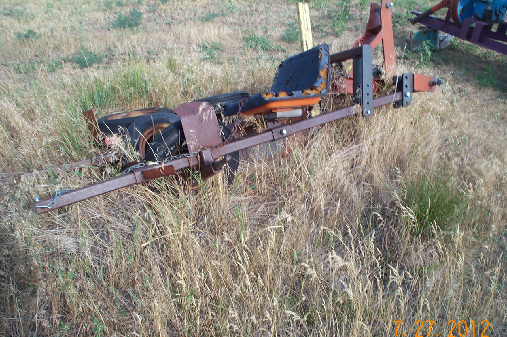

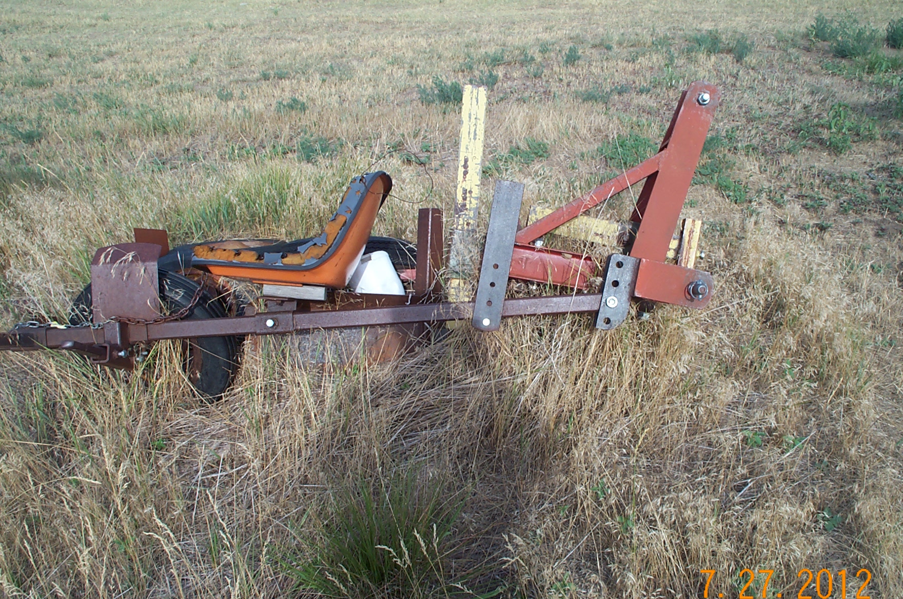

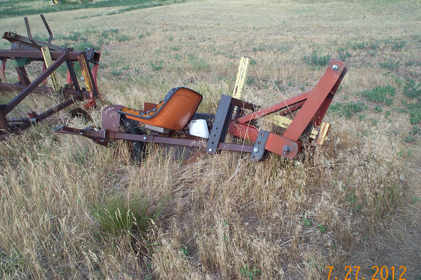

/ Home Made Tree Planter #28
these are not the best pictures much do to the grass that has grown around the planter, and the planter is laying at about 45 degree angle on it side that is down,
but I did get them taken
One can see how I made the arms and the adjustable aspect of the seat and wheels, sorry the side shields is not that clear it is basically the depth of the shank and open to about the wheels,
the colter would go in the yellow pipe on the front, the shank is adjustable up and down, and the tube that holds the shields is bolted to the shank
no to confuse one there are two spare tires laying on top of the unit on the down side, (the tray that I sued to hold the tree boxes,

Thanks for that BHD - I really appreciate you going and taking some extra photos for me.
As said in my last post, I am now getting converted to the whole auger idea this time, but as a future project I may still try and make something like this - or rather pass the idea onto my friend Ramon to make for me, as his welding is far better than mine! I'm sure that once built we could generate lots of work for it planting vines for the farmers around here...
