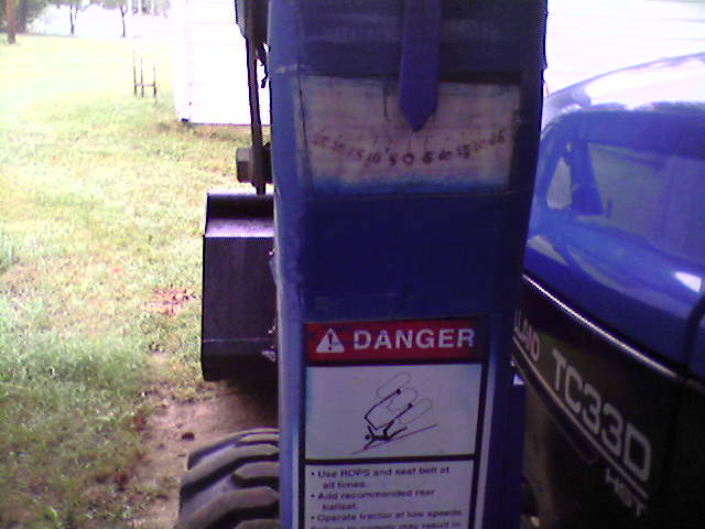

The following is a picture I made of one I built and put on the loader arm of the tractor. I set out the angles on paper and then laminated the thing and taped it to the loader arm. I painted it to make it somewhat water proof. Works pretty well. Enough when I get to 15 degrees I start correcting soon as possible.
I am not sure how clear this will be since I took it today and it was cloudy here and under the tractor cover as well.
