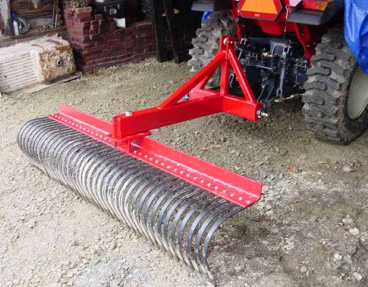

Great Job, on the rake.
What CAD program did you use to design this. I've been wanting to make one for a while now, just a scaled down version, about 50". Do mind sharing the cad files?
/ Home Made Landscape Rake
#42
The program I used was 3dmax, but I could convert the file to DXF that could be imported into any CADD program. Email me and I'll send it to you.
/ Home Made Landscape Rake #43
Question: the main metal frame is that a solid piece of steel or is it a rectangle tubing of some kind?? Im trying to put together a material list of steel to get at the steel yard. Thanks
#44
The main horizontal member is 3"x5"x1/4" thick. The support members are 2"x2" and any steel that lift pins go through is 1/2" thick. I will do an exploded axonometric with dimensions for anyone who would like.

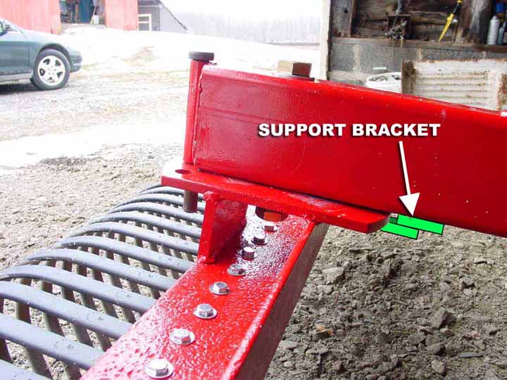

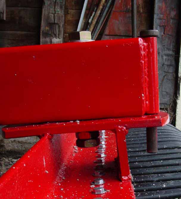

/ Home Made Landscape Rake #46
Beautiful job Mark. My rear scraper blade, made by IH, has exactly the same little tab made almost the same as your proposing. It does just what you're expecting it to. Except, mine does't have to be removed to turn my blade 180. Is your pivot bolt not in the center, otherwise I don't see why you'd have to pull your's off to turn the blade. Not sure you really need any kind of grease zerk. It's not like that thing is going to be spinning around. Grease it up once when you put it together and it's probably good for 10 years. Anyway, very nice job!

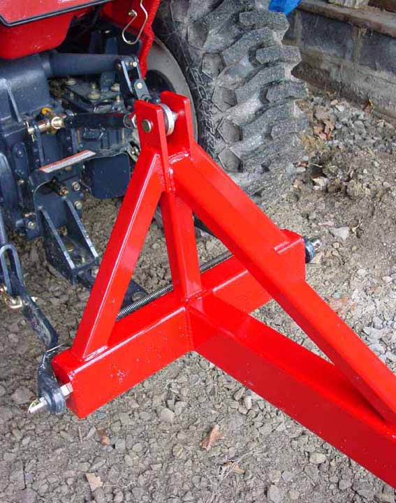

Very nice job. Could you list the dimensions of the 3 point attachment? I would like to build one for my tractor but I can’t get accurate dimensions with the backhoe on it.
/ Home Made Landscape Rake #59
