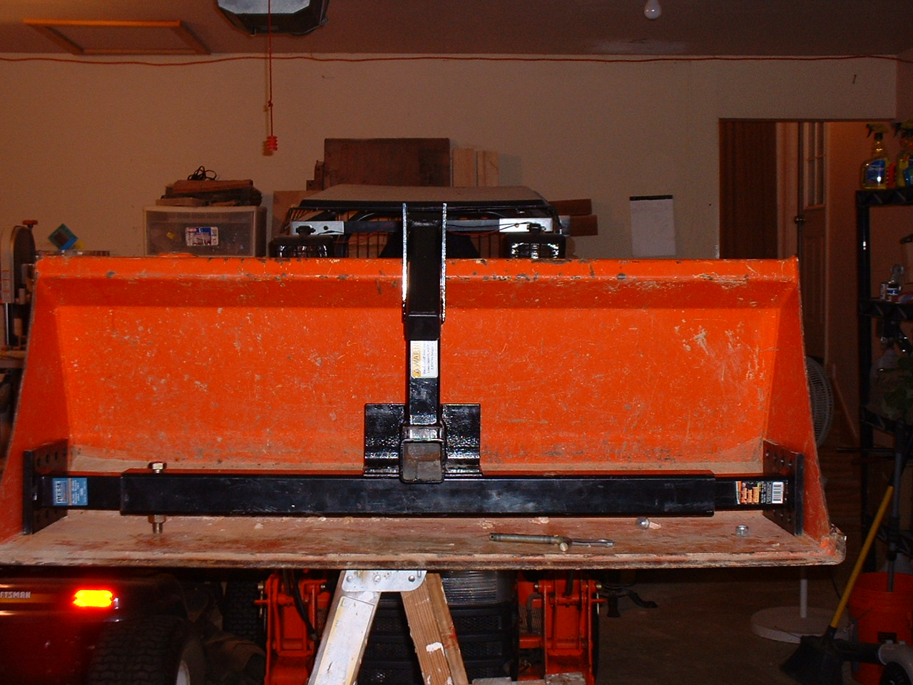

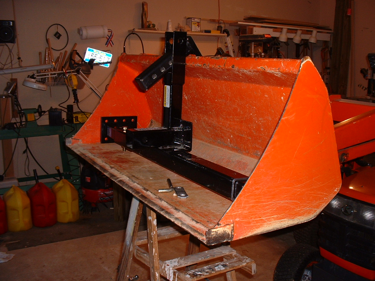

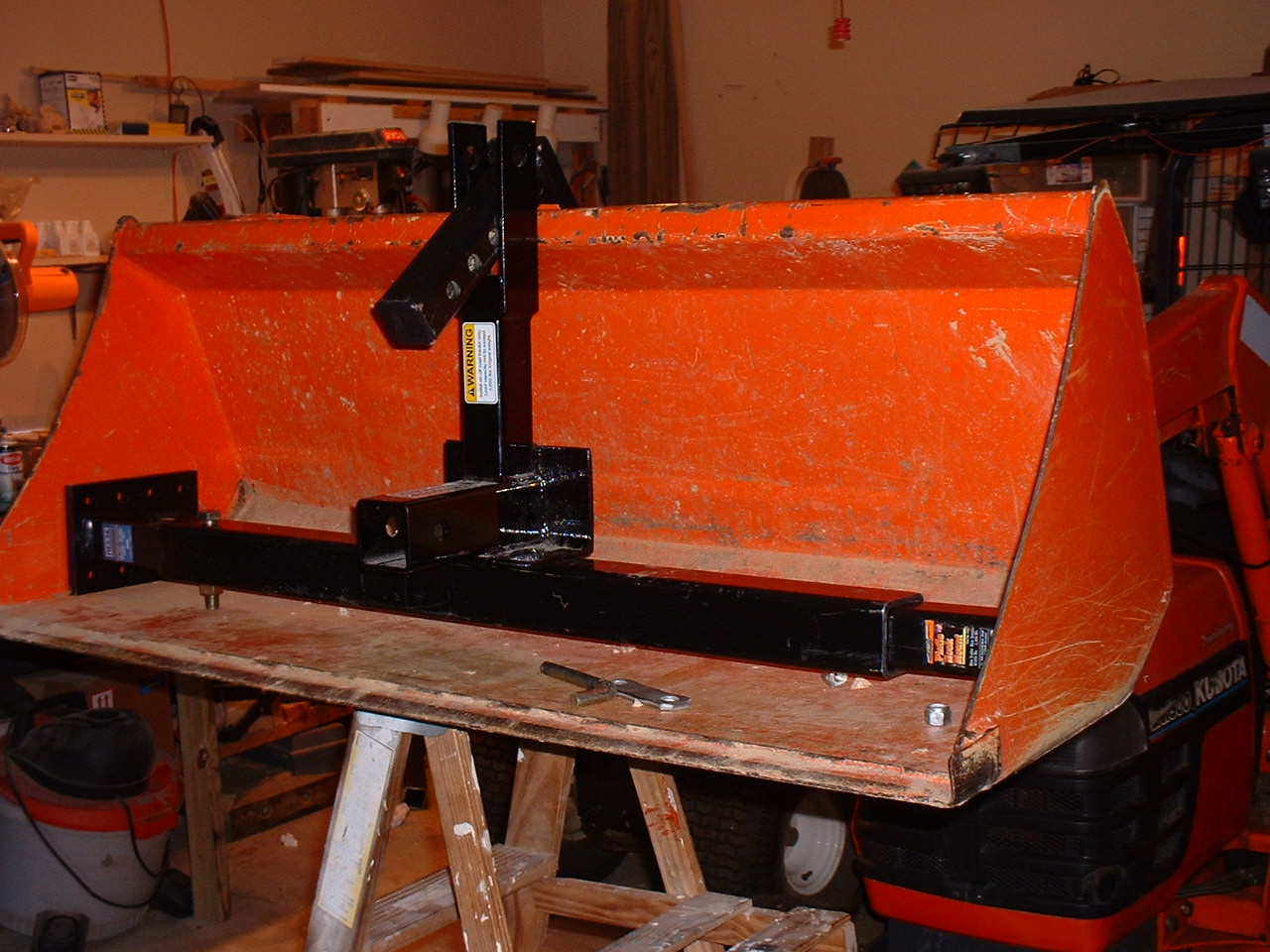

Thought I would start this little thread on some attachment ideas I plan to make. Then bring it back up from time to time for anyone interested as I add to my list. Anyone else feel free to throw in your attachments as well. Plenty of room for everyone. :eek: ;)
I started with some tubing and trailer hitch parts I had laying around my garage. I plan to make more as I go.
This will be a two part hitch one for straight out attachments like forks, landscape rake , snow plow, winch for use with the front bucket. Each attachment will also be available for use with the 3 point in back. A second angled receiver on the front for more ground engaging attachments like a riper or trencher. Here are a few shots of the front mounts.

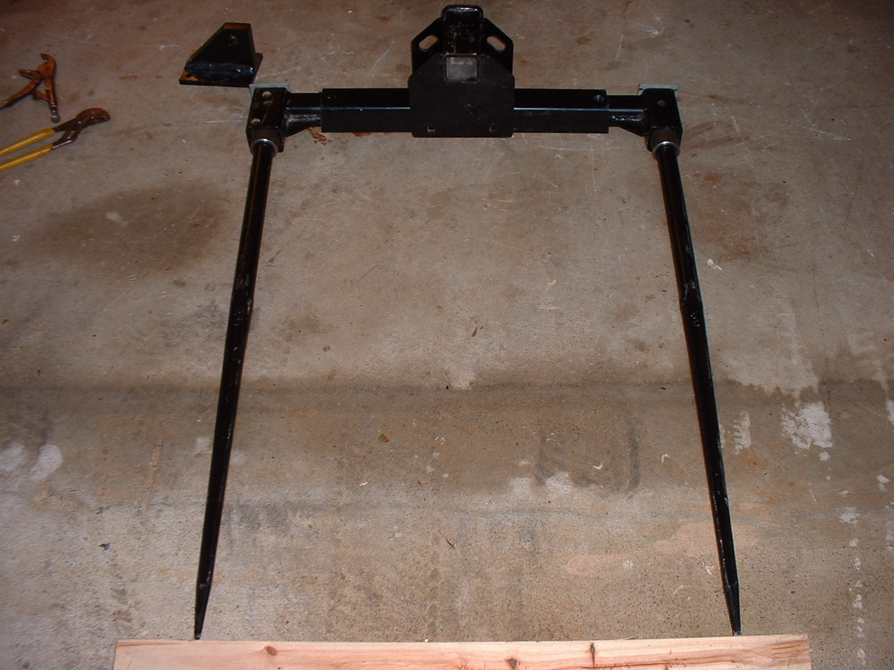

Here is a set of forks I am working on. I bought two Bale spears and used the parts off of two adjustable ball mount ends. I will drill two more holes for pins, so they can be adjusted out for a wider stance. I will use a bumper receiver hitch I had laying around two join the tubing. Here are also a few other attachments I will be working on once I am done with the forks. :eek:

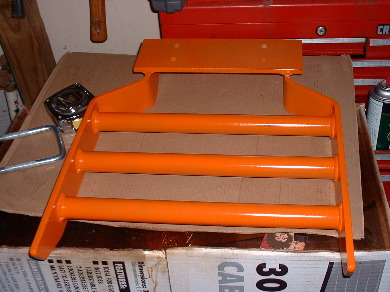

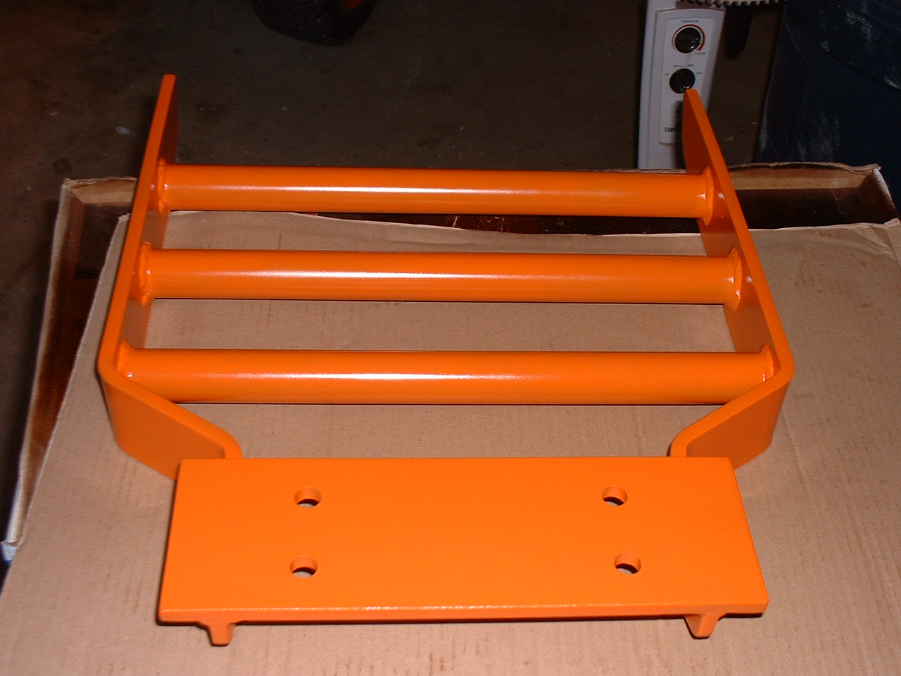

Love this grill guard I just ordered from a member on here. I'm sure you all know Bill, or AKA Kubotabilly. This is one well made heavy duty guard. I just ordered it yesterday and it arrived tonight (lighting fast shipping).
Anyway you can do a member look up if you would like one for your BX. I just painted ur a little while ago in Kubota orange but, it comes nicely painted in silver if you prefer. I will install in the morning and take a few more shots. ;)

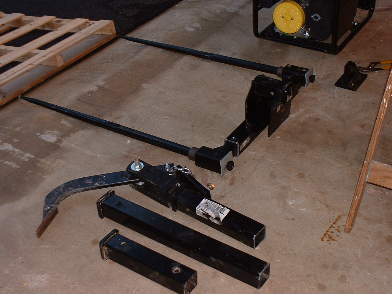

What is the ripper on the hitch for? You going to modify so you can bury wire?
Yes, I will use it for breaking up this rocky clay soil around here and, also to bury cable for landscape lighting etc.
I'll be ordering more tubing in a few weeks in various lengths. I plan to attach everything with pins including the base receivers so they are easy on easy off in the bucket. :eek:

Nice rear hitch. I made one like it but not near as neat. For bucket forks I used cut off truck springs and bolted them to the bottom of the bucket. Note; with this type of fork set up one must what to make sure the load cannot roll back into your lap when lifting.:D
/ Home Made Kubota Attachments
I'm guessing your referring to Zionviews? receiver?
As for my forks the idea was to keep them as light and strong as possible so the little beast can lift more of a load. They can be switched front to back. Good point on the shifting load. I will be able to plug in a light back stop so loads don't shift back on me. The bottom receiver also has another attach point giving me 3 receivers total on the front bucket.
I may use the bottom attach point with the forks for a light duty top grapple while grabbing brush etc.
Any pic's of your forks? ;)

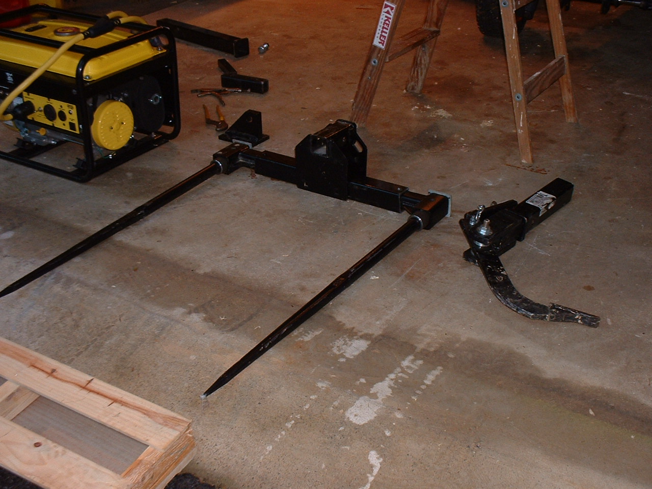

Finished my fork attachment today. One of many attachments I plan to make that will plug into the front bucket adapter or, the back of the BX.
These forks will adjust outward another 4 to 6 inches on either side. I just take out the bolts and move them out if I need to.
The fork setup is fairly light weight so I can carry more of a load. I Painted the Lienbach Jr post hole digger Kubota orange while I was at it. :eek::) Now to take everything apart clean off the oil, replace the tubing mounts with # 8 bolts. I also need to repaint the brush guard, bucket and loader arms.....way over due.
