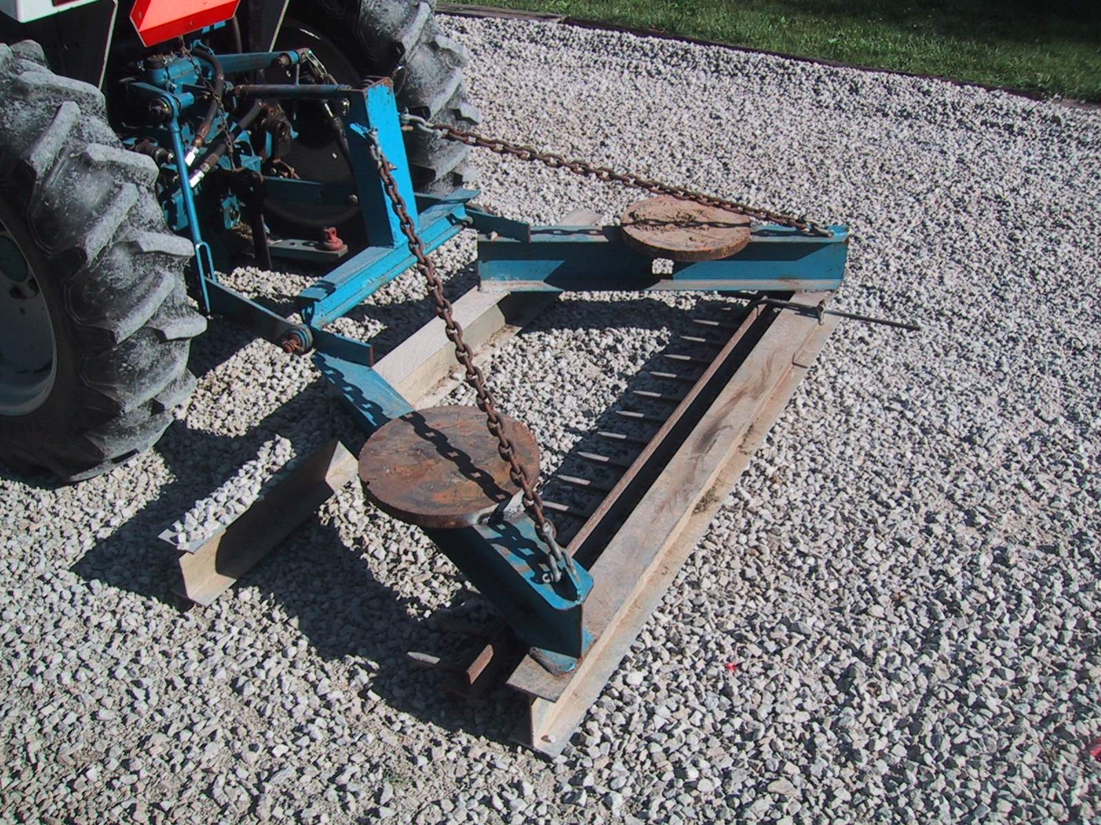

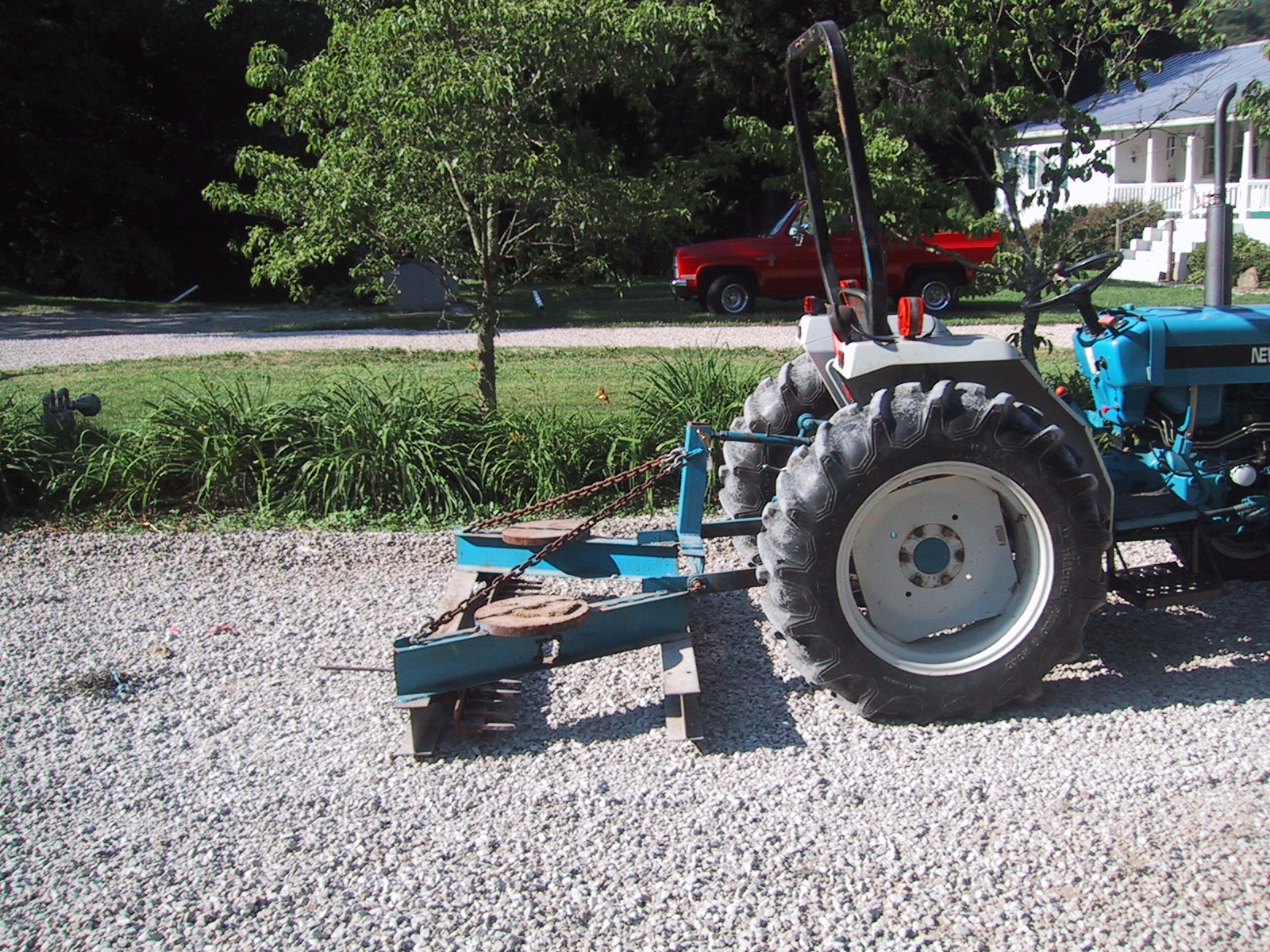

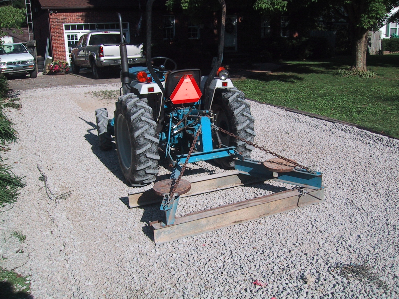

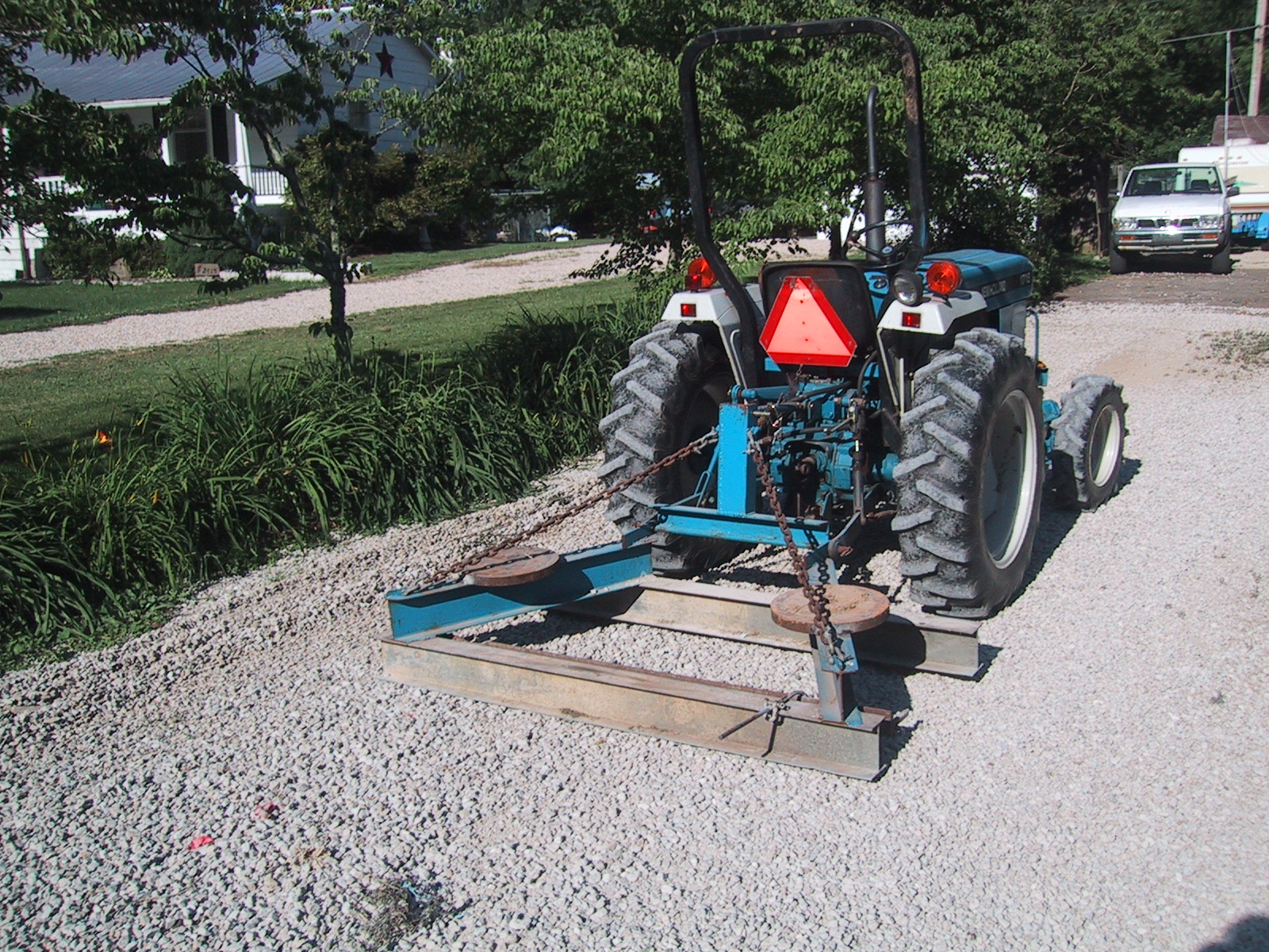

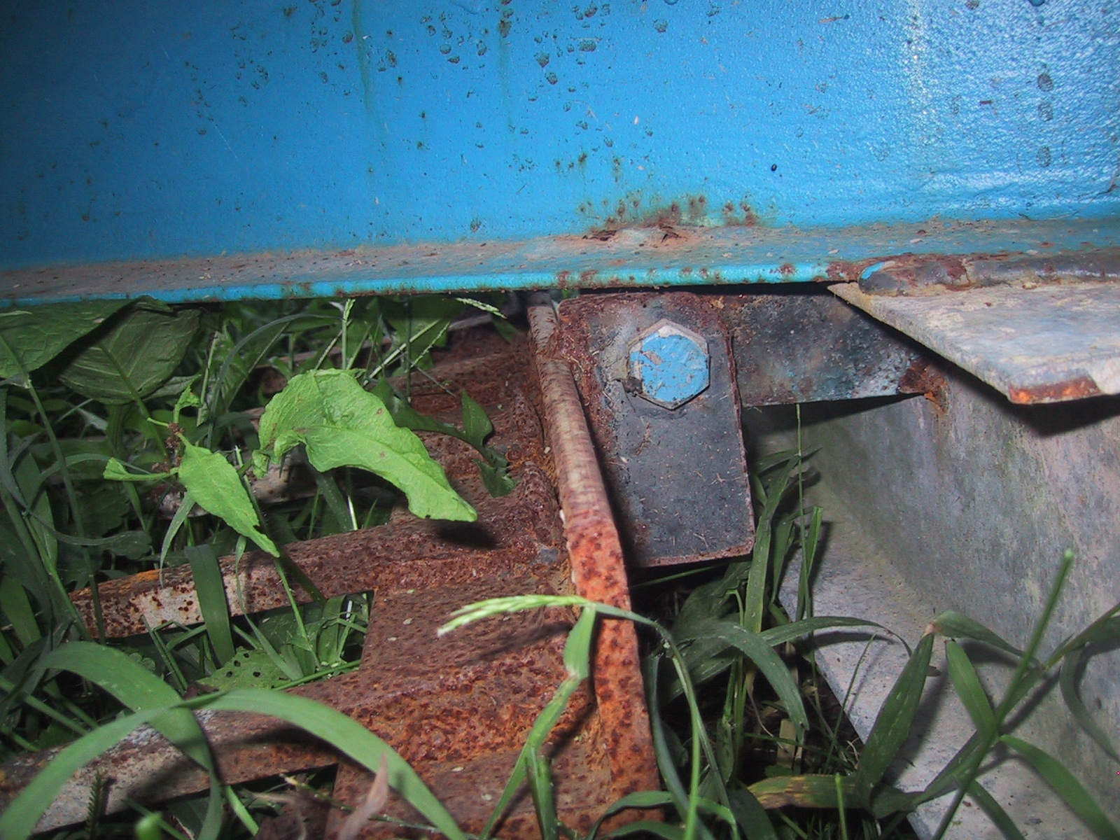

Needed something to scrape driveway . Came up with this . Made from Guard rail post & Railroad spikes . is 6' wide does better job than 6' scraper blade. Spikes are on piece of angle & retrack when not needed.

I am intrigued in what you did here with those railroad spikes. They seem to me in the picture to go way down into the ground.... And as they flip up, how do you prevent them from bending... You have them welded to a smaller piece of steel than the big ibeams, right?

Looks good. The more you can angle or capture the spillage from the ditch side and pull it to the center of the driveway the better. Otherwise you may find that you are building a berm next to the ditch, preventing the water from exiting the road surface.

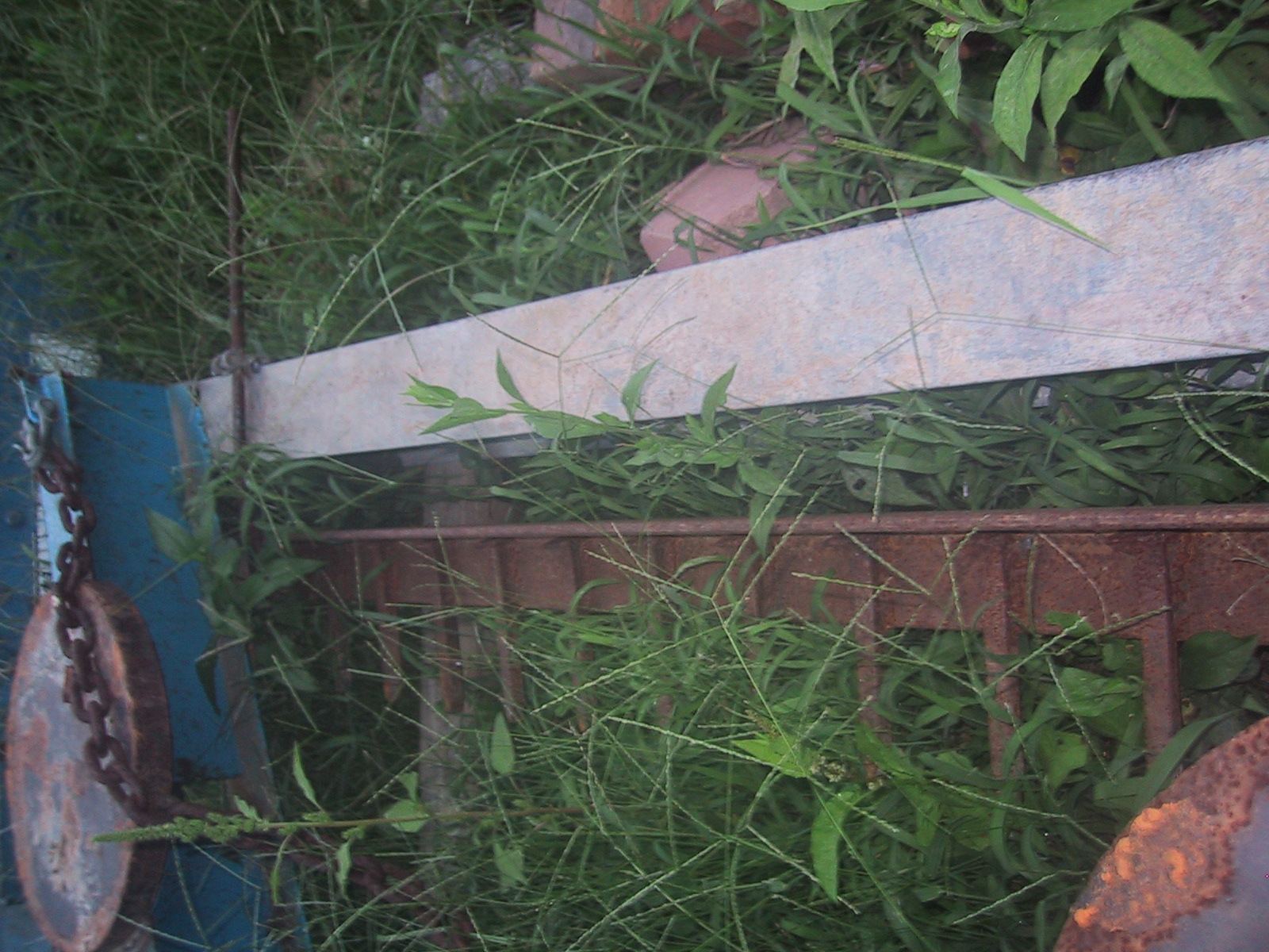

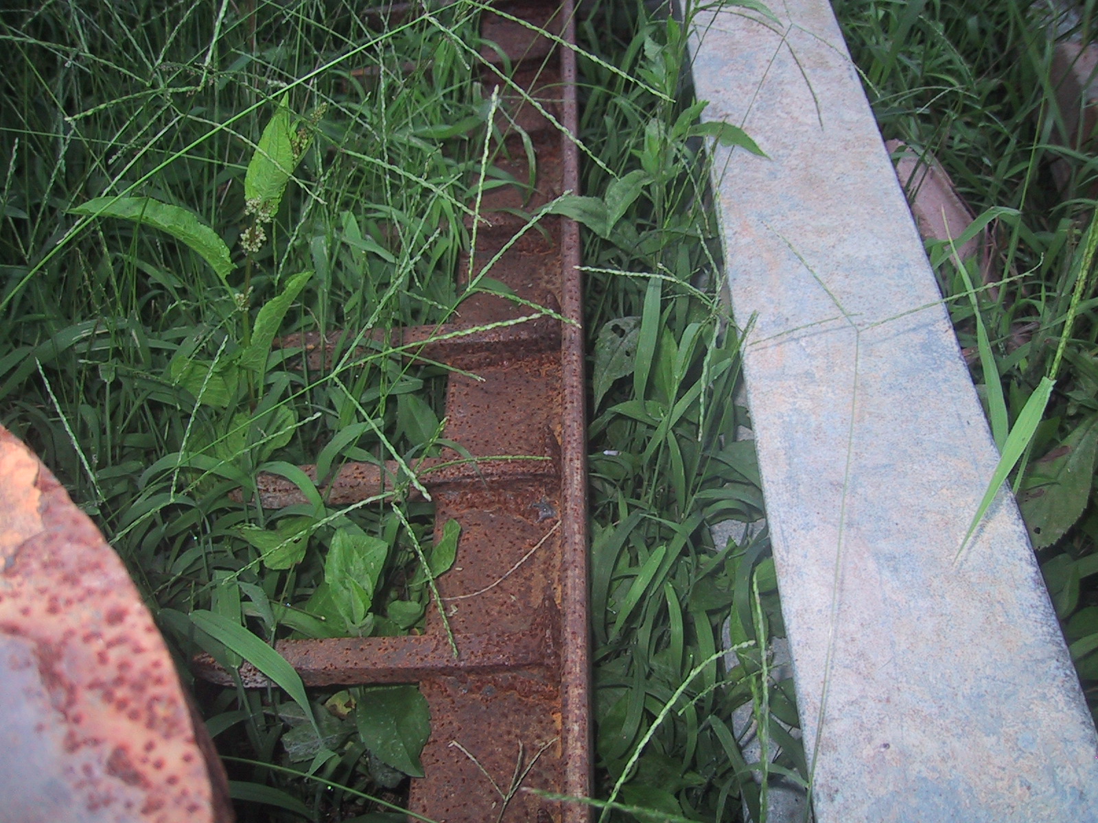

woodlandfarms : the teeth are welded to a 3"X3"X6' angle and hinged at both ends only about half of the spikes are below the bottom . They are used to pull grass out of limestone then I pull up out of way to level . I have used this for two years and so far i haven't bent any spikes. have also used on garden to level after plowing . I live beside Railroad track can pick up all I want beside tracks. Limestone in my driveway are #57 it sure saves a lot of pulling buy hand. Will post Picture of teeth in next few days.

woodlandfarm : Here are some pictuers of Spikes close up & homemade device to hold spikes up.

Thanks for the detail photos and all the info. In my area I think I would bend those teeth at that length (caching on boulders) but this is a great idea, and seemingly a lot less than the 3K Road Boss wants... May have to steal your idea ;-)
