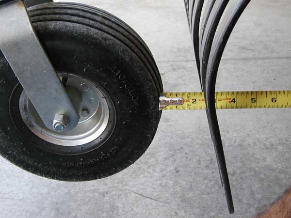

Good luck with your wheel project. As for how far back to set the wheels I just made a guess from looking at the factory wheels in the owners manual. I'll post a picture with some dimensions. To have the arm above or below I think that may be manufacture specific. The original LP wheels bolted on just like mine. As far as a rake being worthless without wheels. Well maybe I shoulnt have sais it that way. It just didnt level dirt or rock very good for me. Could be the operator. In this attached picture the wheel is in position as if I were backing up. I tried to leave enough room between the wheel and the tines to keep clods form hanging up.

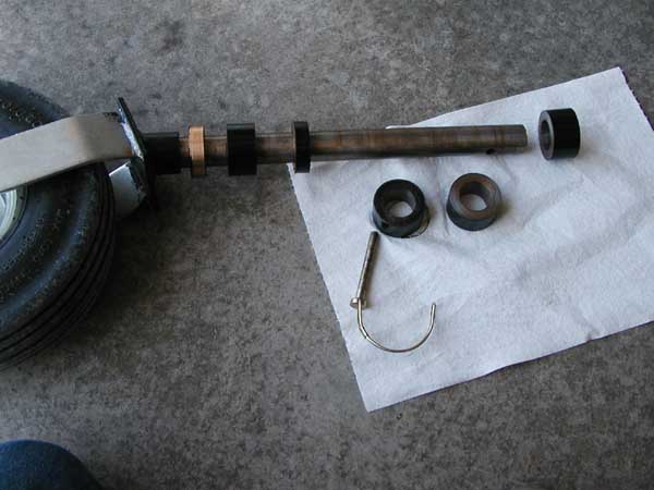

another rake wheel picture showing 1" spacers

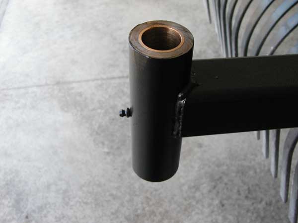

Another picture
   / Home made gage wheels for LP landscape rake #19
So cool and well done. Thanks for the close up pic's.
They bring to mind a question;
Does the grease zerk go all the way through the brass liner or is there a recessed area for grease to sit?
