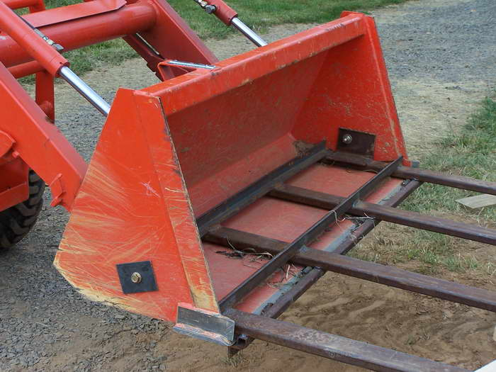

I made these about 10 years ago. They're made from 1" square shafting I picked up at a salvage yard. It's really strong stuff. The back end (not visible) has a pad with a hole. I was originally going to weld nuts to the bottom of the bucket but never got around to it. The nuts would hold the rear in place and keep them from turning. I dug up a lot of cactus with these.

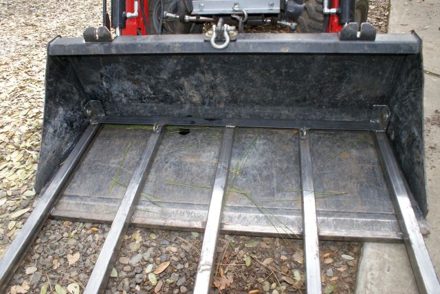

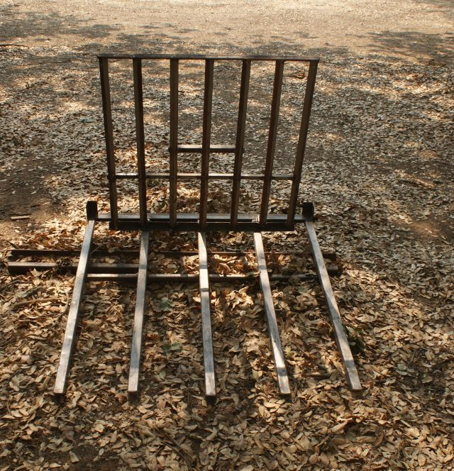

This is what I did.... 1-1/2 x 1-1/2 square steel tube about 48 inches in total length...
forks-1-jpg.686036
forks-2-jpg.686029
There is also a strip of metal under tines that fits under lip of FEL to keep it from flopping" around...
And how they are retained in FEL...
bolt-3-jpg.686030
Grill added later to keep debris from flopping over back of FEL onto hood of tractor...
Also consider the smaller your debris is you may need more and closer together tines...
This is something salvaged from unknown machine as possibly a guard of some sort, but makes great "basket" for really small stuff like pine needles and oak leaves and shrub pruning's....

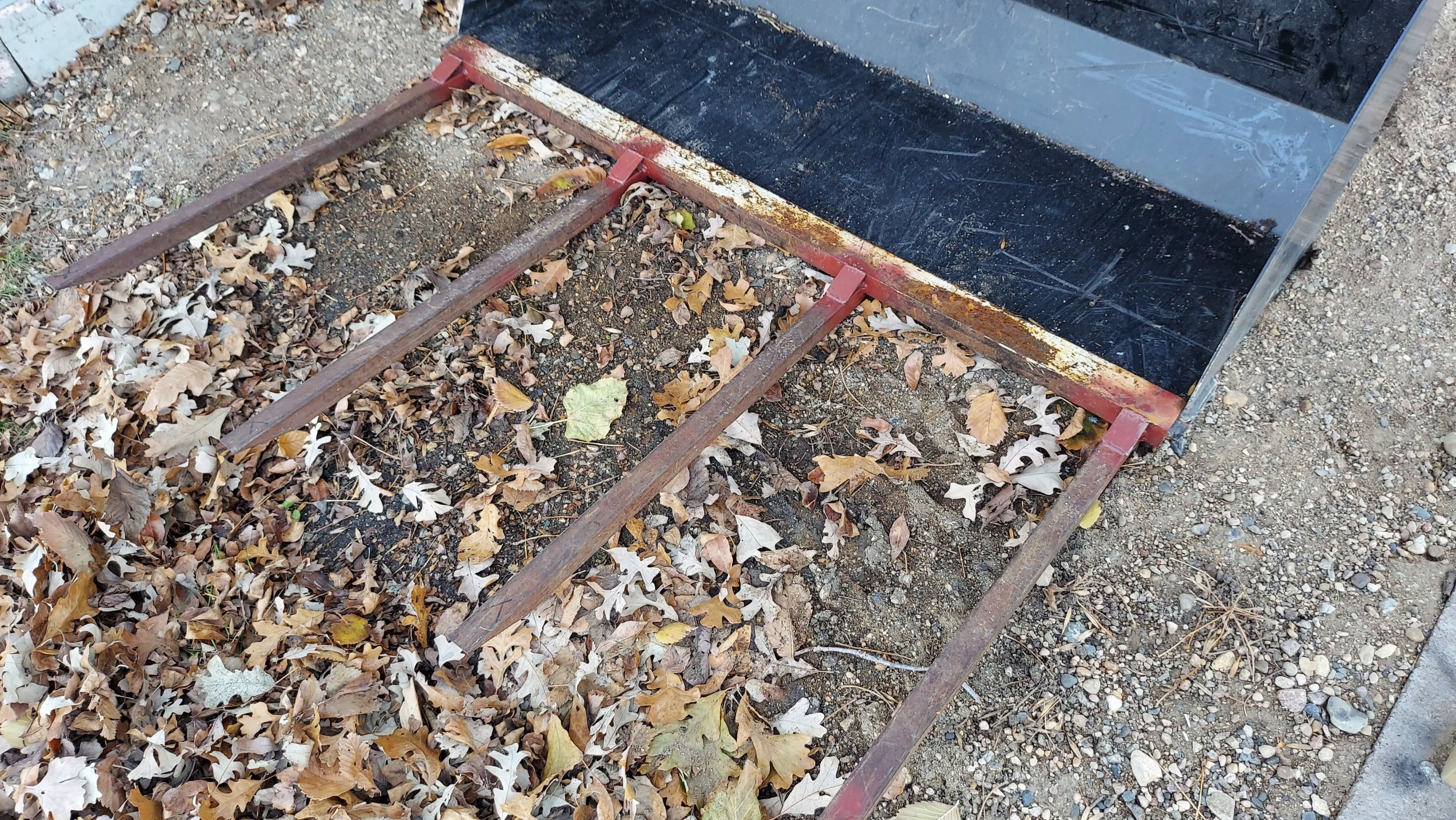

You looking to build or buy? Google "Clamp On Debris Forks Tractor" if you are buying, plenty of them out there. Mine are a bit longer than 2 feet (I need to cut them down).

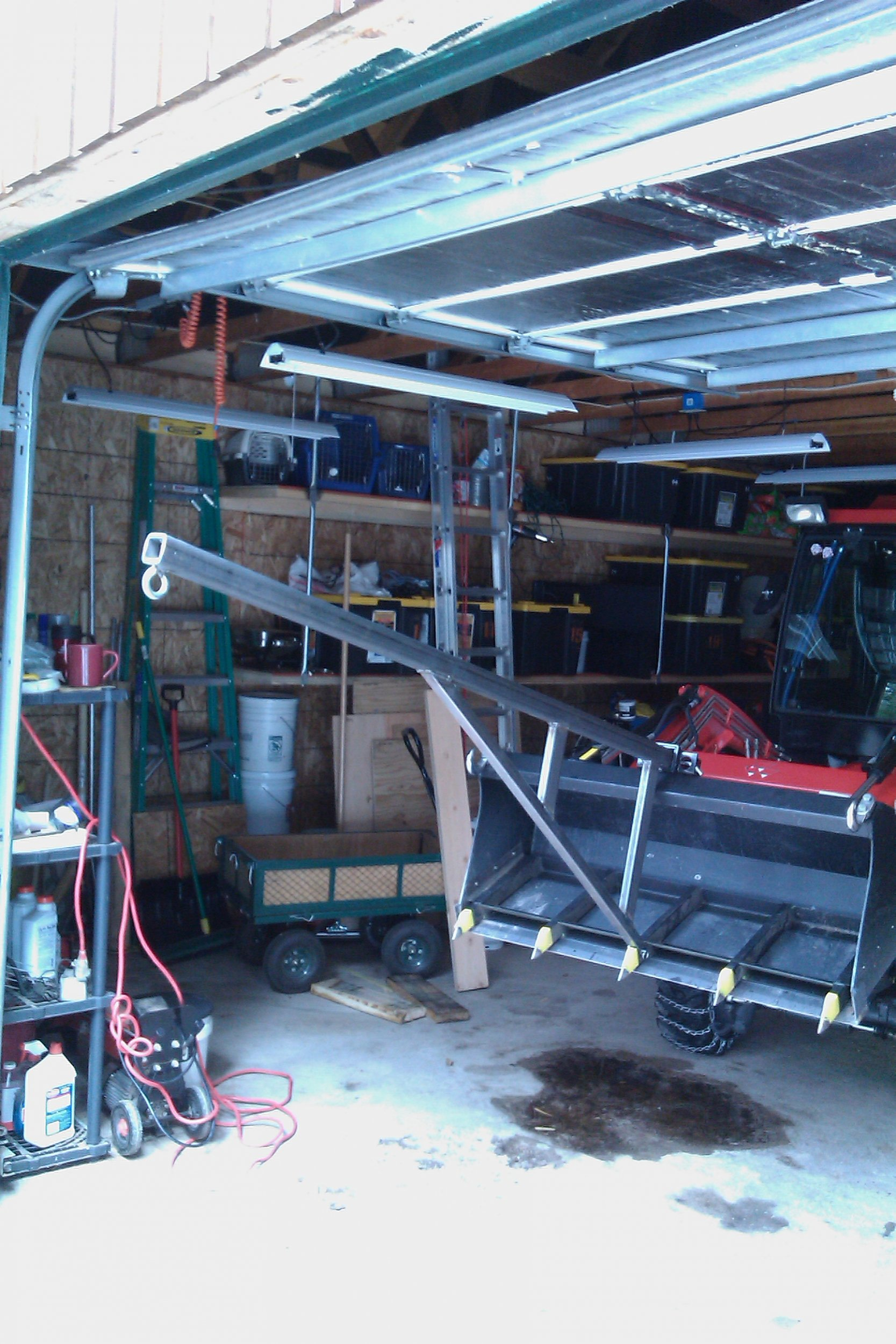

Here's my homemade brush forks I built about 10 years ago along with a jib boom, and a set of bucket teeth.
I used 1/8" x 1" x 2" tubing for the forks, and 3/4" plywood for the platform.
The brush forks are used every spring/summer, and are fastened with 3- 1/4" x 20 grade 8 bolts thru each side of the bucket.
The hinged plywood platform is attached to the top of the brush forks with 2- 1/4" x 20 eye bolts drilled and tapped thru the top of the brush forks.
The vertical wooden headache rack is also attached with 2- 1/4" x 20 eye bolts drilled and tapped thru the top edge of the bucket.
When I want the wooden platform up, I just use a bungee strap to hold it in position.
Hope this gives you more information to help you with your final decision.
