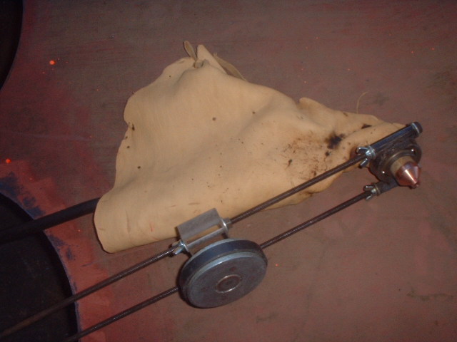

tomrscott, good job! I was wondering, do you drag the tip of the plasma cutter across the metal to be cut or is there a gap between the two? And if there is a gap, approximately how big of a gap. Thank you.

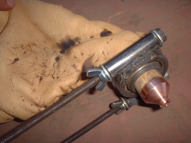

I had some more gouging to do today to remove some rectangular reinforcing plates from the bottom of the large plate. So I decided leather cuff to protect the torch handle and trigger.
I made this in just a few minutes from some deer hide. I cut a 1" hole to put the torch head through, and then laced it up with a lace cut from the same hide.
Really works great! If you have a plasma torch, I highly recomend a leather cuff like this to protect the handle. When I got this plasma cutter, the handle was very badly scorched and cracked and the trigger was so badly burned and scorched that it barely operated. I replaced them with new parts, and then promptly started to do the same kind of damage when I began using it to gouge out welds.
In the next post I'll put a closeup where you can see the kind of scorching the leather took, protecting the torch.

The deer hide actually shrinks where it gets scorched. It will probably need to be replaced after a while, but that's a lot better than destroying the torch handle.

As I understand it, different plasma cutters work differently. Some work best with a small gap. The Hypertherm has a "drag tip" that has some castelations on the tip (notches like a castle wall) that I believe allow for some air flow to help stabilize the arc jet. It actually cuts best with very light drag pressure against the cutting surface. I have found that if the surface is smooth, it is easier to drag smoothly. If you find yourself jerking the tip, you will not get as smooth a cut. If I find the surface roughness is causing me to skip, I just lift it very slightly above the roughness and it seems to still cut just fine. Of course, if you get very much extra gap, it doesn't cut through as deeply.
Also greatly affecting the quality of cut is the electrode and nozzle condition. They gradually erode from normal use and eventually they cause the plasma jet to become unfocused and even spray out in a diagonal smear. At that point (or sooner if you want the best quality cut) the consumables need to be replaced.

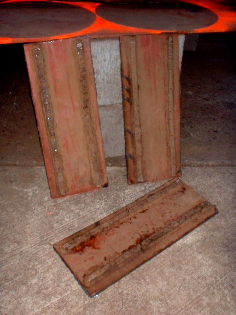

I've attached here a picture of three steel plates that I removed from the bottom of this plate today. They are about six inches by seventeen inches, half inch steel with some cuttoff ends on the surface. I was really kind of worried that these would be real tough, wasn't entirely sure what I was going to do because they were attached with good fat weld beads all the way around on all four sides. But today I decided I would try gouging out the welds and see if I could remove one. I used the same technique that I had used on the angle iron, except that getting the chisel started was a bit harder because of the continuous welds. But once I got it started, they came off pretty easily. Once I got a quarter inch gap, I saved some time by putting in a large pry bar and whacking it with a sledge. At that point it went pretty quickly. Once you've gouged out the bulk of the welds, they don't have much strength.

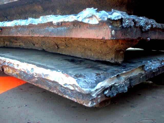

Here's a closeup of some edges after gouging out welds with the plasma cutter. /forums/images/graemlins/smirk.gif

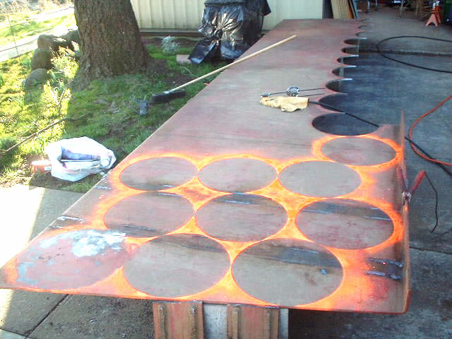

Part way into cutting the disks, when I had ten cut out, I took them and laid them out in the pattern I was planning to cut for the next ten to make sure I was not running out of room. Then I sprayed some orange marking paint around the disks as a rough guide.

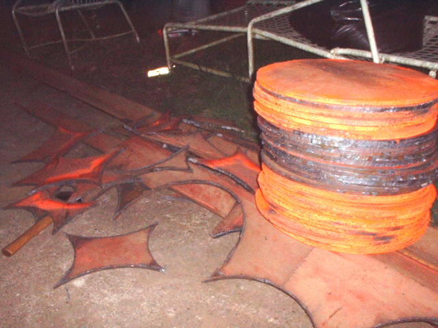

I've got 30 tractor weight disks, 16" in diameter, 3/8 inch thick cut out now. twelve more to go from the plate I've got. Feels like the home stretch. The plasma cutter is working great, I'm getting better at cutting faster while keeping the movement steady so it doesn't flash back. It is pretty amazing how fast this thing will cut. I can do a disk in a few minutes.
Here's a picture I took this evening of the stack along with some of my scrap. The disks look like they're glowing hot, but It's just that Iv'e been using the cut disks as a layout guide stencil and painting orange marking paing around them.
