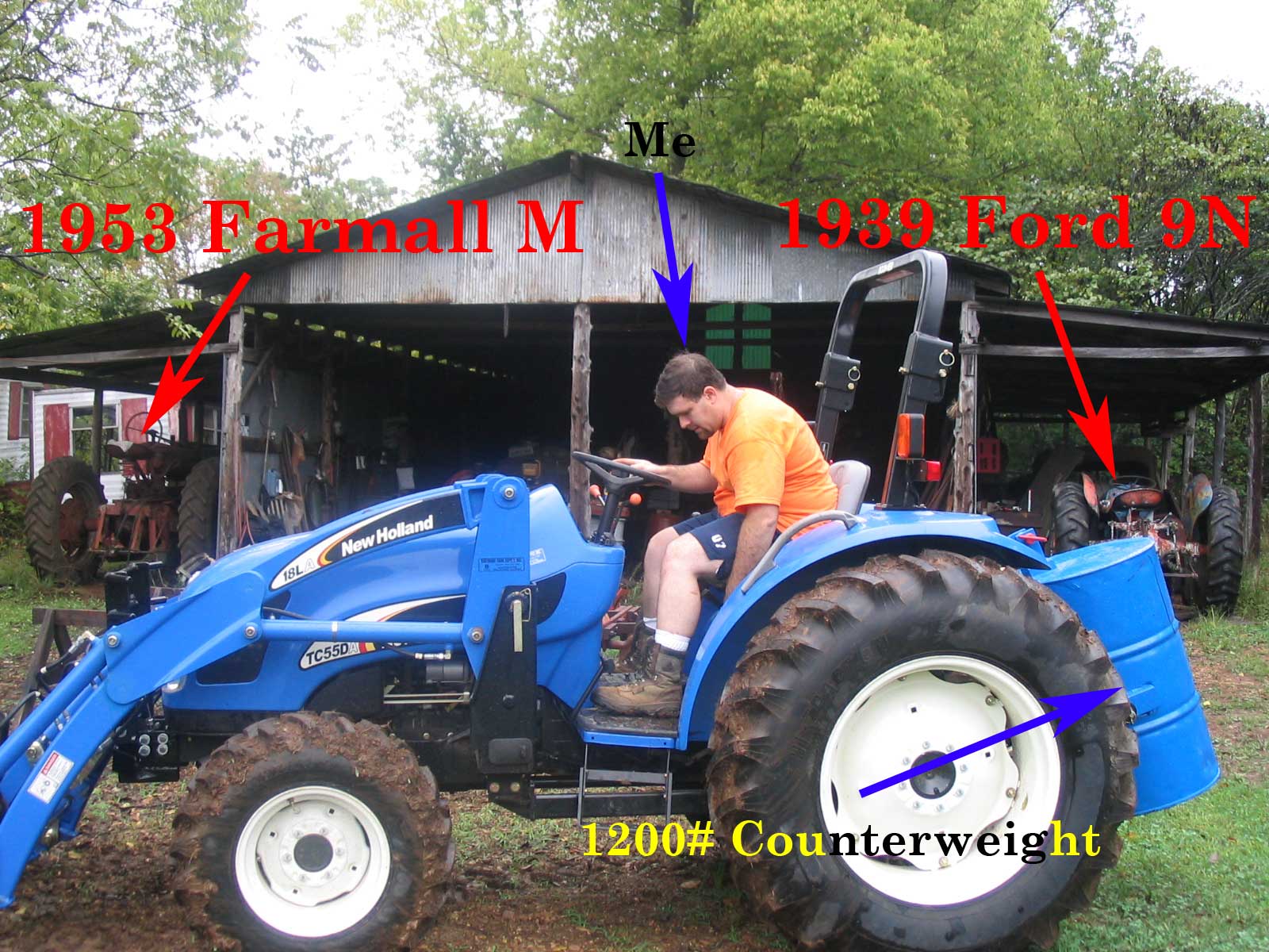

Well Guys , I guess it's time to post a pic of Me on the new Toy. Well it is almost 4 months old and I have only had maybe 3 Weekends of Seat time, So its still new to me.
I noticed while reducing the Image Size of this pic so I could Upload it. That the Wife managed to get the Behinds of the Two orphaned tractors since the new arrival. On the left is an old '53 Farmall M , that drinks about 6 gallon per hour while BrushHogging. On the Right is the OLLLDDDD '39 9N, it is easy on the Fuel, but the Draulics aren't worth a crap.
And in the Middle is Me on the New Guy with the 1200# barrel of Concrete on the back.

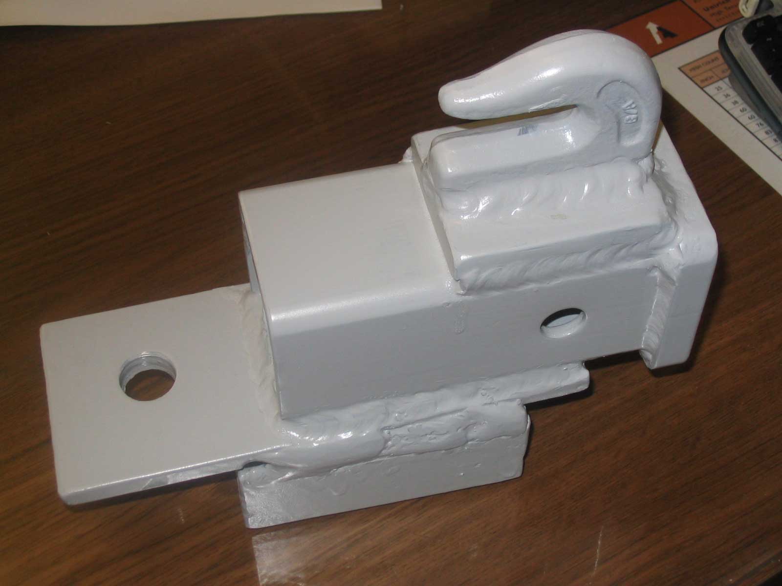

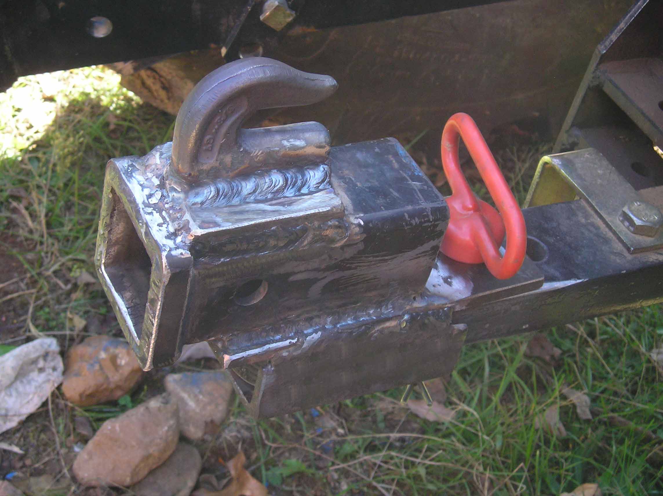

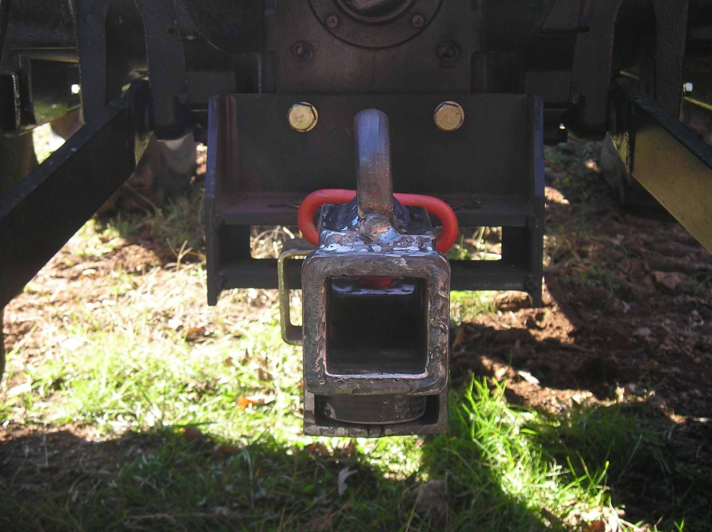

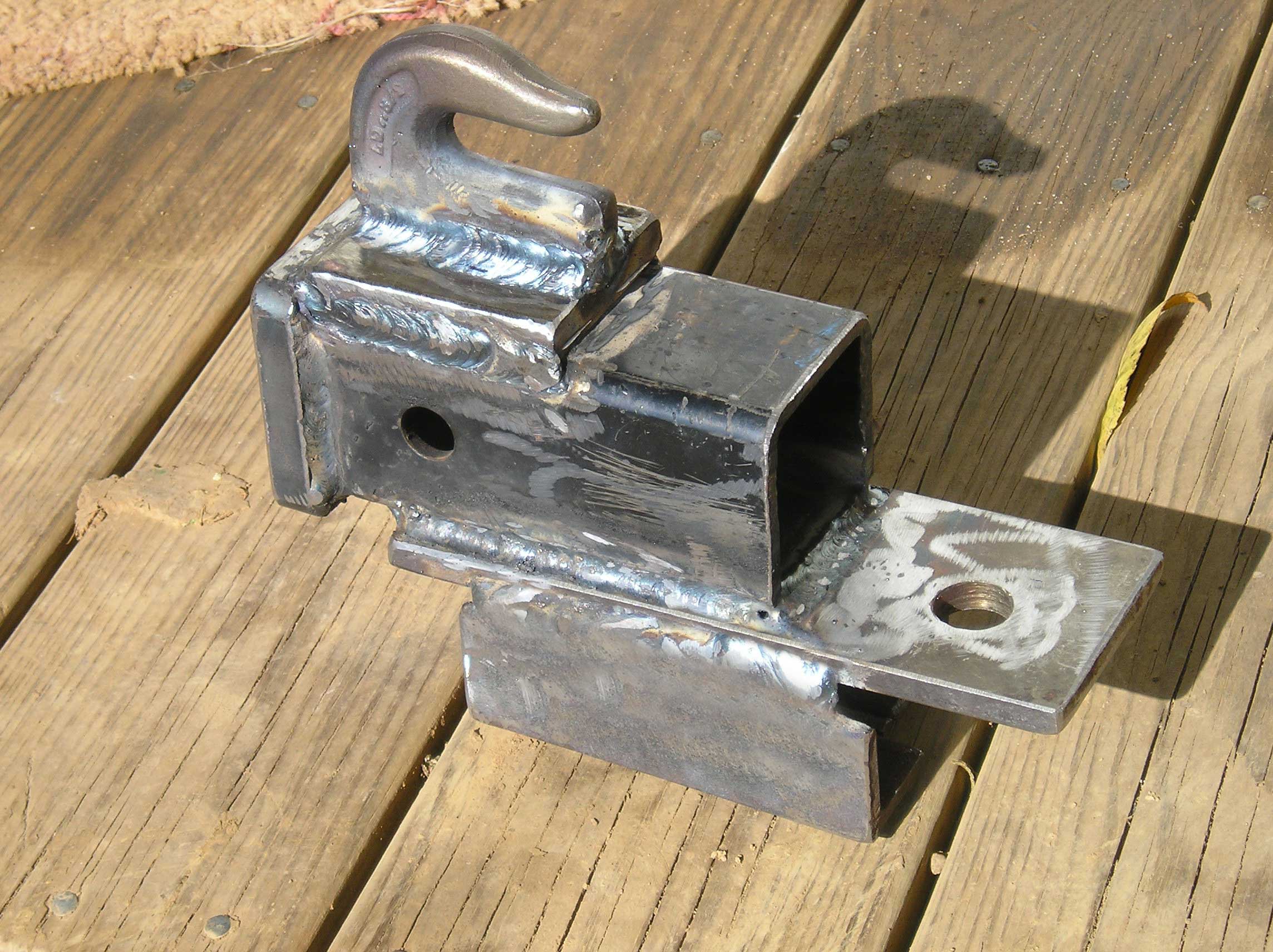

Nice work! I like the receiver hitch too!

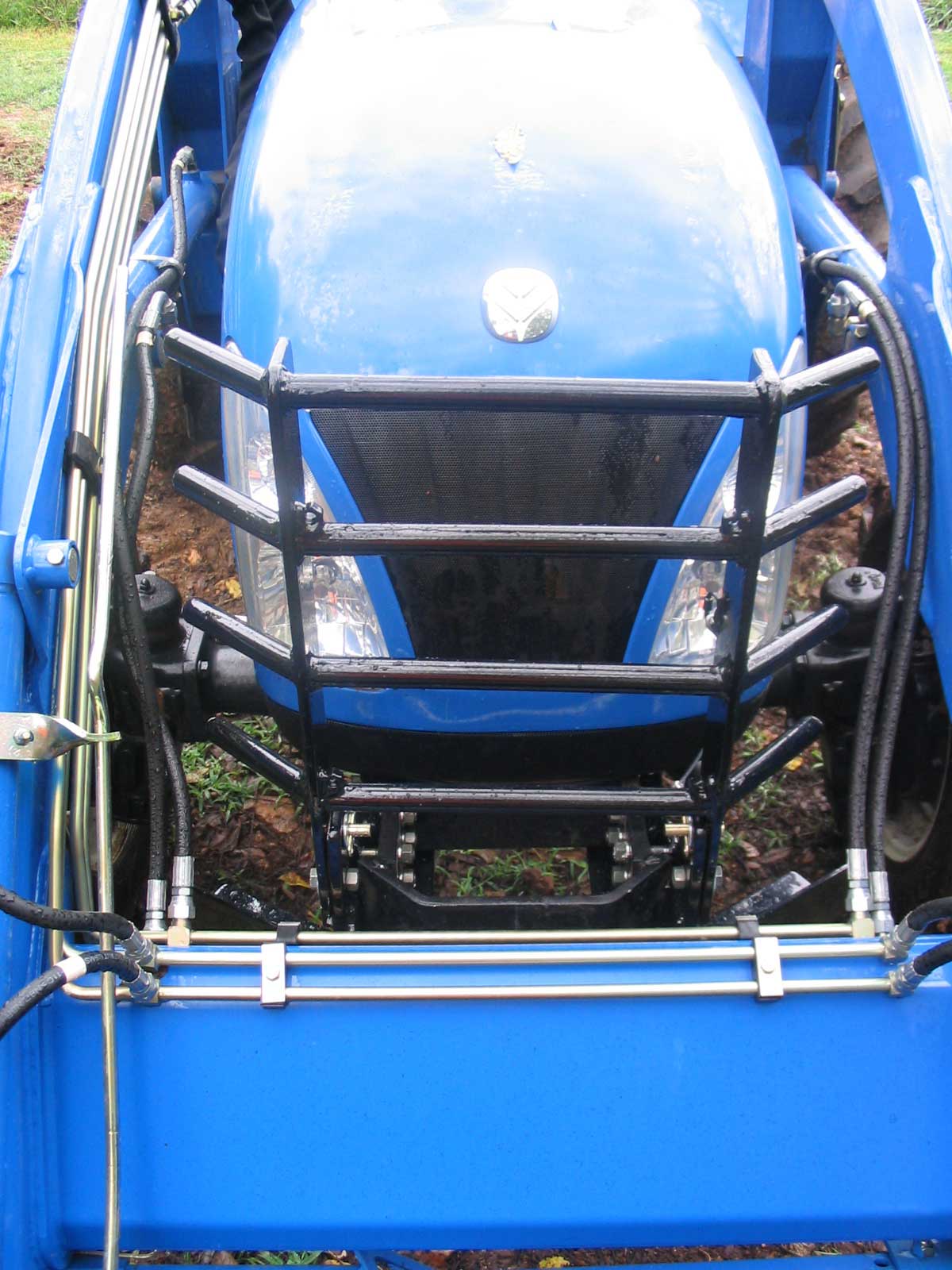

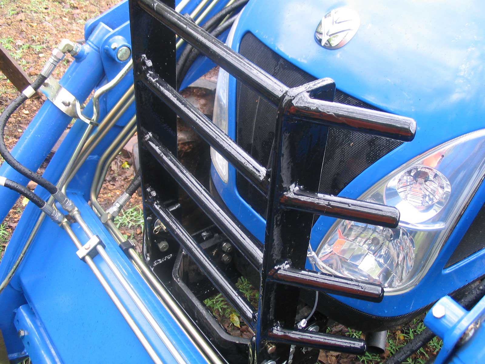

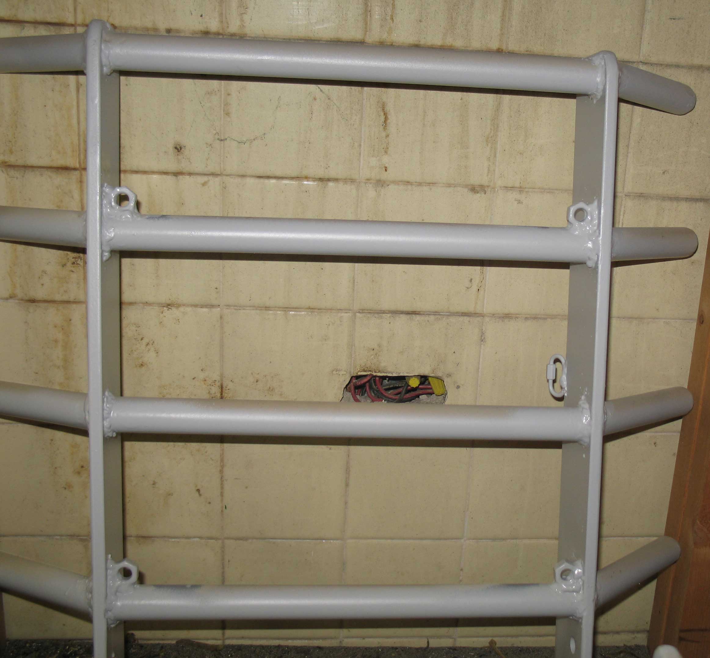

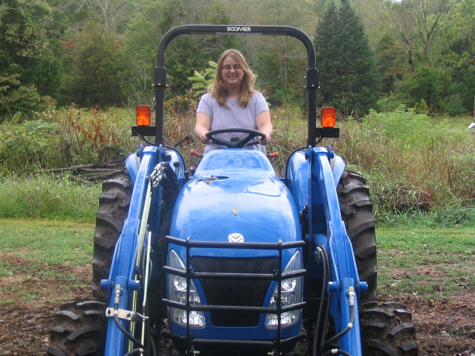

Nice job on the brushgard. It appears the hyd. hoses are real close to the fingers on the guard. Is this the case or just optical illusion? I'm sure you designed with hose clearance in mind but it just looks kind of scary. HOT hyd. oil is not fun.

It is an illusion , the hoses have over 3" of clearance. It is hard to tell from the Pic, but the Lower Finger is 6.5" and each finger above is reduced by .5". The Top finger measures 5" , This was done to ensure plenty of clearance for the Hydrualic Hoses.

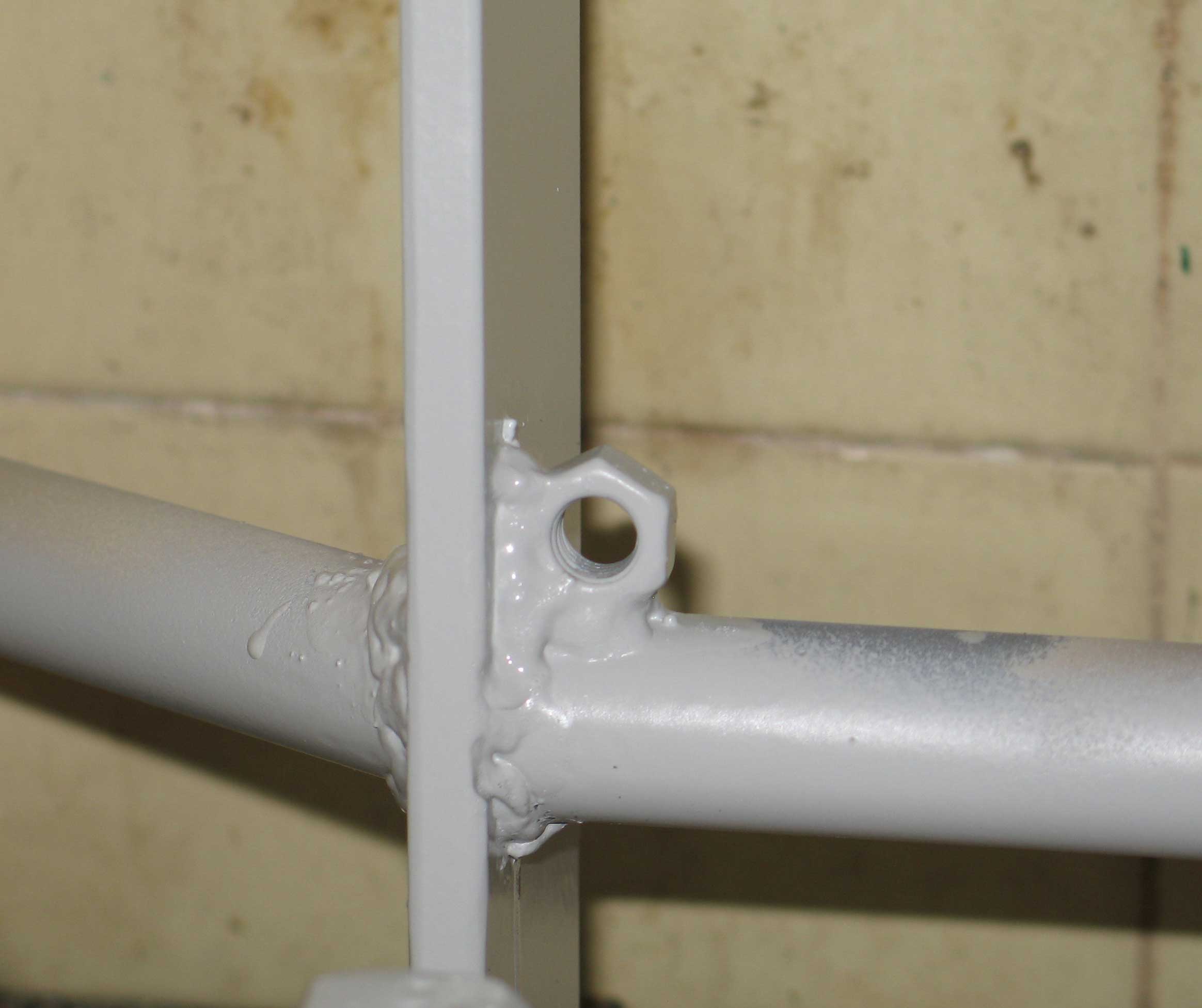

I was gonna suggest the mesh also, but you're way ahead of me. I love the nuts welded to the frame idea. Makes for an easy and secure way to add the mesh in the future, be even better, you can take it off for repairs. I would have just welded it on an. Your method is much better!!!!
You did a great job, it looks like it belongs there and it will last forever.

I have a L3130 also, I'm doing similar to deerhunterf350, but I used a piece of I beam at the bottom bolted flat to front of tractor, very strong. When I have time to finish instead of fab’ing and welding, I’m going to bend 1” pipe in a bender to follow the contour of the hood, and weld to the I beam.
Nice job deerhunterf350.
