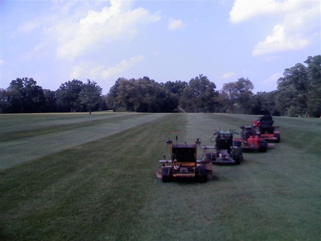

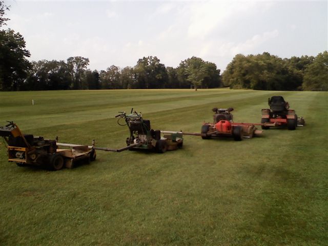

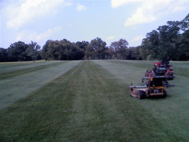

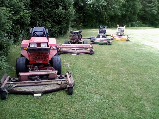

I built my own using 48" walk behind mowers,it is redneck style,but it works! The ocst of used machines was less than going thru all work of fabbing,also the HP requirements couldnt be met with my slamm tractor to run all the decks off the pto.I built it to tow behind the 1910 but ended up towing it behind the smaller more nimble steiners.4 decks, (2-60")(2-48")16.5 ft cut(about 9" of overlap per deck) ,79HP,and a lot of looks whenever i use it.....
/ home made batwing mower? #13
that and 5 different engines to care for..YUCK!
soundguy
/ home made batwing mower? #14
To each his own.I love how my setup performs,you couldnt buy the gearboxes and decks for what the used WB can be bought for,and the commercial walk behinds leave a better finish cut every time.I have under 3K in my setup,and it can do the work of huge dedicated mowers.In 5 minutes i can break it apart and use the WB's easily.I can also unhitch the stiener,trim for a few minutes,and reconnect easily.This summer had record breaking rain,I am unstaffed due to the economy and and overworked.Trying to get more doen with less time and money,that was the reason I built this contraption.Initially i built the small attachment to drag another steiner deck,I have been dragging it for 9 yrs now easily.Thats setup is proven and has thousands of hours on it being puleld by another steiner.Just this summer I added the WBs to it.Remember I do not have a ton of money into this and it give pro quality results,I mow over 50 acres a week with it sometimes,even more,and i am cutting at low heights,and sometimes cutting a lot off.Maintenace on the WBs engines has been a breeze,they are simple to work on,ive spent under an hr all a season working on them,about the same time it would take to grease the driveshaft u joints and check gearbox oil....Here is a few shots of my setup doing its thing,its being pulled by a 20 yr old Steiner ive has since new with in excess of 10000 hrs on it.It gets about 500hrs a year.It runs about 16-20- hrs weekly.For over 7 months a yr.

I mow open areas,1500-3000ft long x 1500-2000 ft widewith maybe 5 trees. I can actually put all 4 mowers thru a 7 ft opening,by turning hard left around a tree,I do it every week.yDo you think a tractor batwing is easy to manuever around obstacles?It literally 20 seconds and i can unhitch any of them.I challenge any tractor batwing to go where I can,and to mow what I mow spending triple the money.I can easily mow 50 acres with a perfect cut in one day, taking breaks,and not rushing.BTW my steiner is only 25HP Kohler Command Pro,and its plenty,even with over 2000hrs on the engine.it,runs like a top.All my mowers are filled with Shaeffers 7000 supreme oil...probably contributes to why the engines are trouble free.
