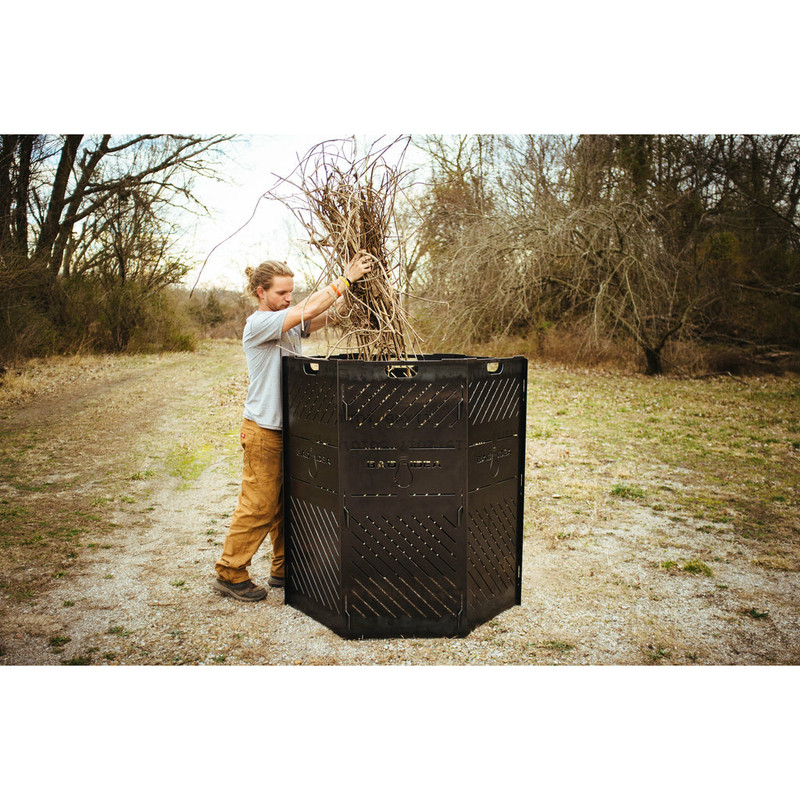

I'm probably going to buy another XXL pryo cage in the 11 gauge thickness. They didn't offer this thickness when I originally bought it.
That's either a very small person or the XXL is huge. Thanks for bringing these up though. I've been looking for a trash solution to reduce what I have to bring to the transfer station---save up my plastics/stryofoam and only bring them once a month in their $3 pay per throw bag.
I haven't put a ton of thought into it. Still leaning towards rolling my own with concrete/fire brick, but if I go with a purchased solution I'll check out their large with a base and put it on pavers in the woods. No need for a lid in my situation.
XXL
XXL
The XXL is huge. Assembled dimensions are approximately 35" in diameter x 47" tall.
It's going to be even taller once you elevated it with cement blocks. What I like about it is the ability of throwing just about any size cardboard box in it without having to cut it down. I also have trash compactor bag I throw in about every 2 weeks.
