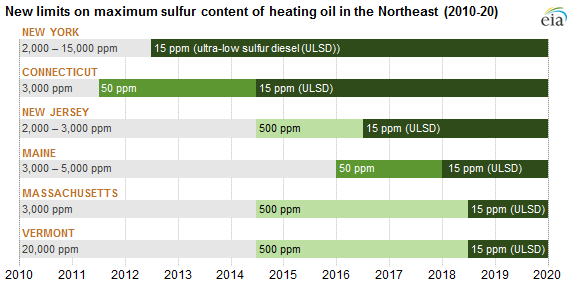

Some people claim it is, other than taxes and dye. I think it also matters particular state regulations and phase in dates of sulphur reduction

The company providing says all their fuel is ULS (ultra low sulphur) and they seem very reputable but I have never dealt with them. Speaking of Wilco (Washington, Oregon based).
   / Home heating fuel vs. #2 diesel #4
Heavy equip mechanic here, also did fuel delivery. It comes outta the same pipe at the rack( terminal) , just won't be blended for cold weather.Pretty much everything is ulsd up here in the northeast now.

Not all states are using ULSD for heating oil yet, but it is heading that way.
