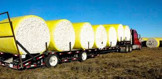

Well, yeah, for cotton balls you need something more like this:
Balls....not bales LOL. The'd be a tad big for the end of a Q-Tip :)........Mike

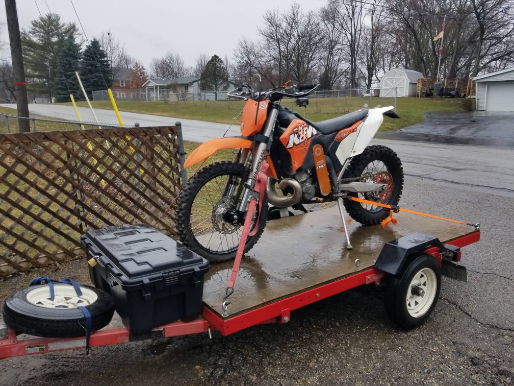

12 inch wheels are a whole lot better than the 8's that come on some trailers. I will admitt, I was nervous about the 12's on the uber cheap Harbor Freight 4x8. But it's been from Michigan to Georgia and back with 600-ish lbs on it, and has had probably 20k on it by now, typically hauling maybe 300-800 lbs, and mostly freeway, where the wife will loudly vocalize her displeasure with a trip taking any longer than necessary, which means often cruising in excess of 80 mph. After 7 years I replaced the tires due to cracking, but they were also getting quite worn down.
I wouldn't want to run them near capacity all the time. But they aren't the worst.

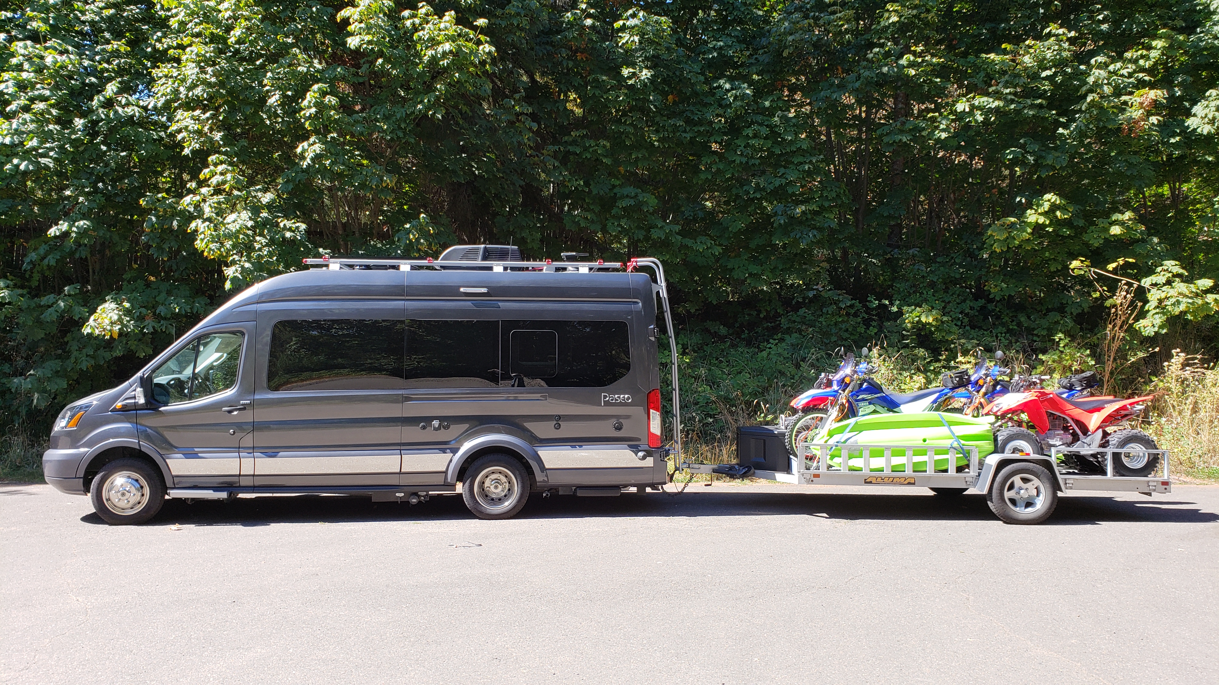

I'll second the recommendation of an aluminum frame trailer. I've had this 6.5x12 Aluma flatbed for 9 years, it still cleans up to almost brand new condition, and the only maintenance it requires is tires and wheel bearing grease. I paid around $1800 for it 9 years ago, and probably could sell it today for what I paid for it (similar trailers are going for about $2500 new now).
And yeah I know the rear end of the van is sagging in the photo below... that was 2 years ago, and since then the van has had suspension upgrades to compensate for the weight of the RV conversion, plus wheel and tire upgrades. In the photo I'm using a 5" rise draw bar, and now to tow the same trailer, I'm using a 0.5" rise draw bar...
