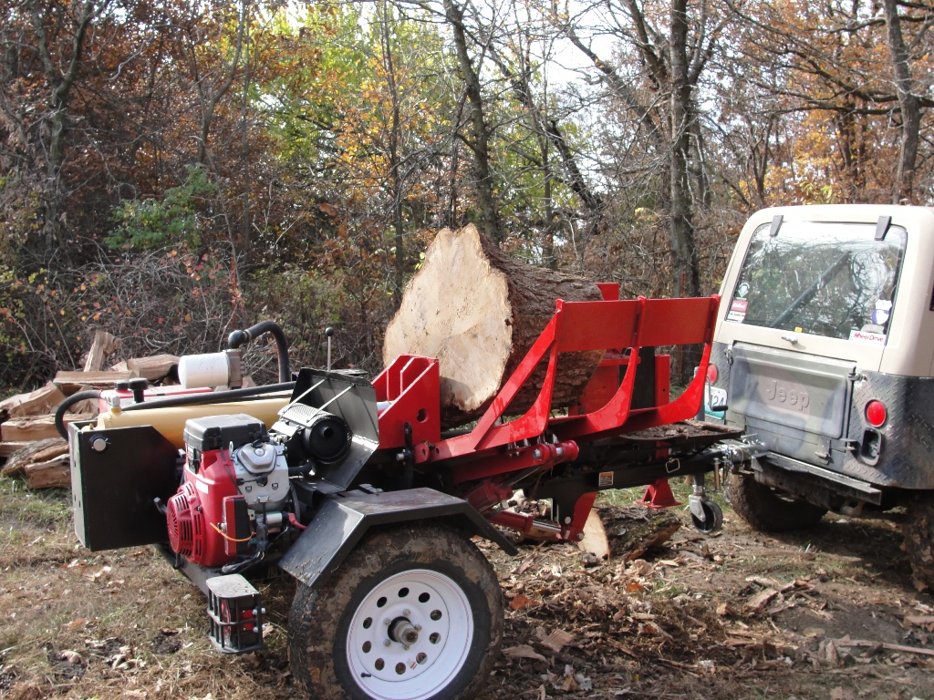

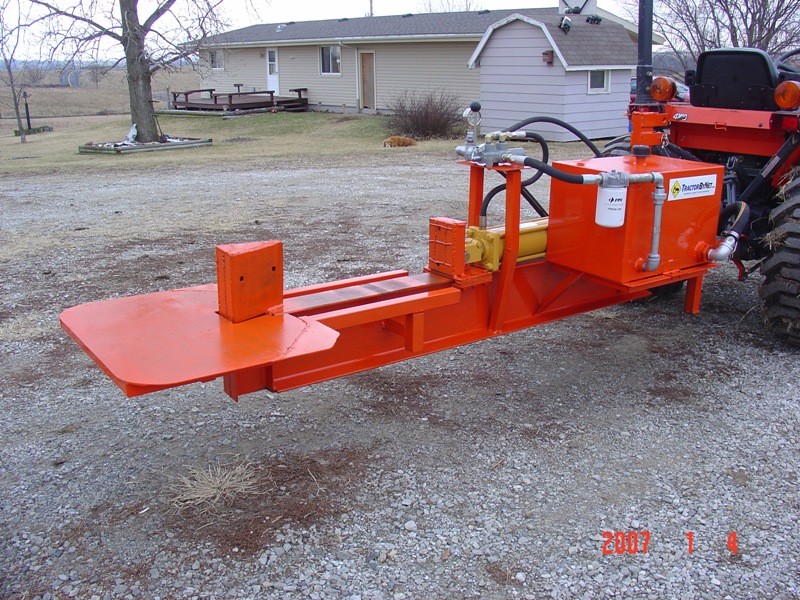

I built one four years ago. 3pt powered by a PTO pump. 35 Ton capacity. I bought everything and had $1500 in materials.
I guess the first thing you need to decide is what capacity splitter do you need?? You can buy a self contained splitter for less than $1500 but it won't be a 35 Ton and will be slow. If that suits your needs then that's what I'd do. If your needs are a durable large capacity splitter I think you can build it cheaper than buying.
I'd be concerned about how slow a splitter is going to be on your tractor. For example it probably has a pump flow capacity of 6-10 gallon per minute. If you use a 4"x30" cylinder the cycle time is going to painfully slow, probably 20-30 seconds to run the cylinder out and slightly less to retract it. That's unacceptable to me. I want a cyle time around 10 seconds out and slightly less to retract. On my homemade splitter I used a 22 gallon per minute pump to get that quick cycle time.
Now I use a self contained trailer mounted splitter with a 6"x30" cylinder. It has a cycle time of 12 seconds out and slightly less to retract. That's plenty slow for me. I paid $6500 for it. Not practical unless you have a large volume need. We split 100 cords a year.

nice looking rigs, I was thinking a 10-15 ton splitter as I don't have a whole lot of hug stuff, just some big dead fall.
/ Home Build Log Splitter #6
You could probably run a 10-15 Ton splitter with your tractor at an acceptable speed. Good luck with your choice.
