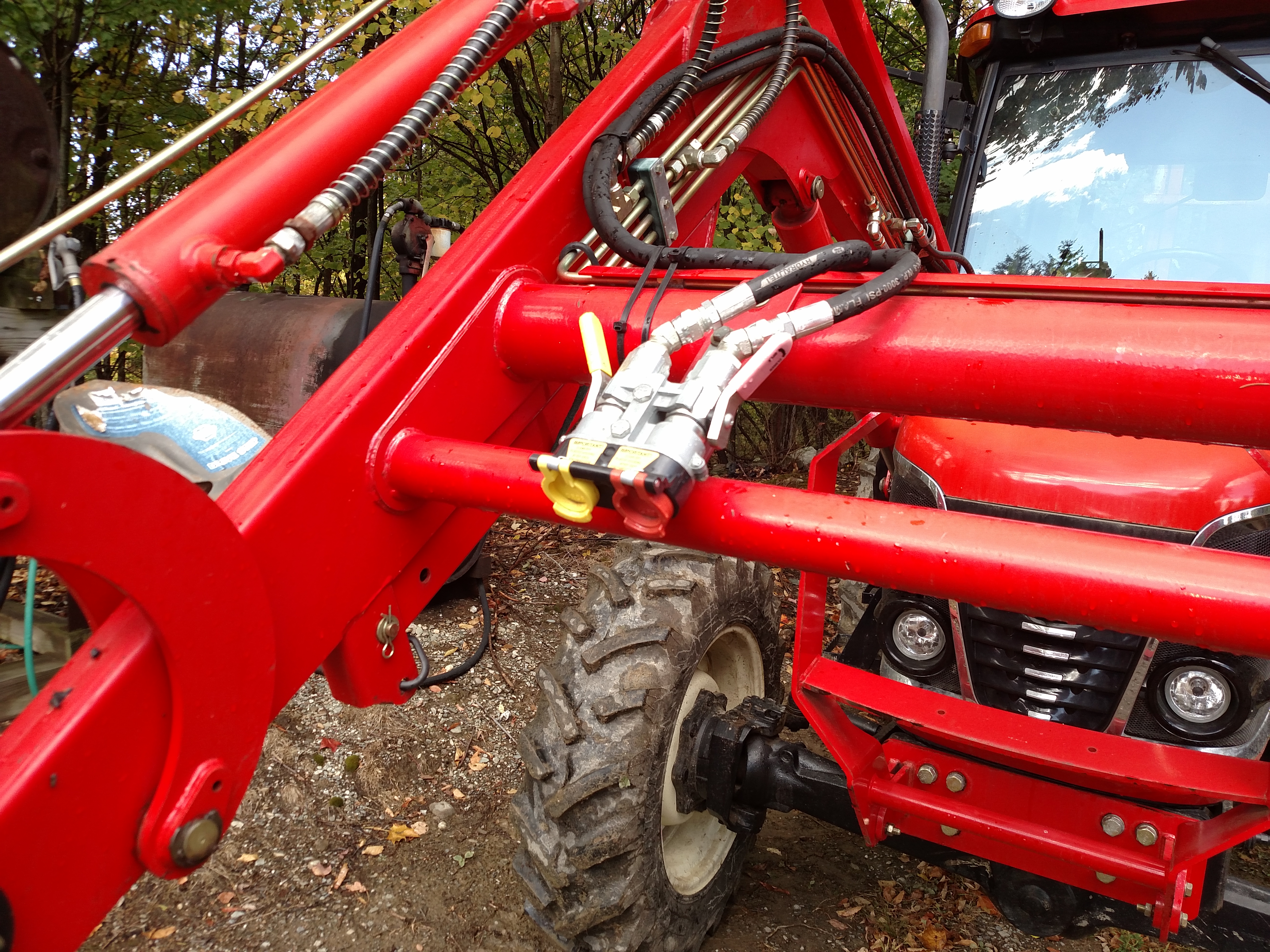

I'm going to get a grapple for my Branson 3725 and will probably make the 3rd function setup myself. It's looking like the loader's torque tube may be the best bet for locating the solenoid valve. The other possible locations are under oil filters or block access to the fuel filter and engine dipstick. The disadvantages that I can see are that it's more likely to get damaged, and I have to run long hoses out to it and those will carry pressure all the time as they're P and T lines. The valve would be in line between the dealer installed rear aux valve and the factory rear aux valves whose T line goes to the 3pt. The 3725 puts out 10.3 GPM. The charts I've looked at would indicate 1/2" hose for 10gpm. But the dealer installed 3rd rear valve has 3/8 between it and the loader valve. Should I use 1/2" to my 3rd function valve? Should I replace the dealer installed lines with 1/2"?
I realize that putting the valve on the torque tube puts it out in harms way, I will probably make a guard to keep branches from poking it.
The P and T lines to the 3rd function valve will have couplers roughly where the loader valve couplers are for removing the loader. I will make them so that they can be connected together to bypass the 3rd function. I'm a little worried that I or someone else (future owner) would disconnect the loader and forget to connect the bypass. Which would make the system deadhead. Does deadheadding for a few minutes until you figure out what's wrong hurt anything? If so are there connectors that would automatically make that bypass when disconnected?

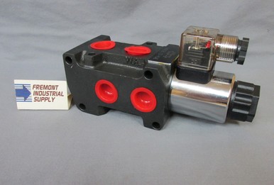

One more dumb question. There's two kinds of solenoid valves I see- one central box for the electric connections like this:
D3 HYDRAULIC VALVE TANDEM CENTER 12 volt DC
or two separate boxes like this:
What's the difference? Is there anything in those boxes?

I have no experience with this, but from what I have read I think you need this kind: Hydraulic solenoid operated selector diverter valve 12 volt DC - Fremont Industrial Supply
/ Home brew 3rd function questions #3
The pieces that you have mentioned in your post are electrically operated hydraulic control valves when activated you will get full flow instantly
and be slamming your grapple shut and open with no ability to modulate it and gently close or open it, the seconds posting is more like what most
people would use the two supply ports would be plumbed to your existing usually bucket curl lines with the two normally open ports piped to your
bucket curl and the other two normally closed ports to your grapple, to use it you would activate your switch to operate the valve then using
your curl valve operate your grapple releasing the switch to go back to your bucket curl function.

For your situation as far as mounting location if you're thinking Diverter then the torque tube might not be *that* bad just be sure to mount it as protected as you can (a guard is a great idea). If you're going 3rd function then I would try to find somewhere much closer to the "core" of the tractor (and more protected) - I have even seen some set-ups where the valve was mounted on the rear of the tractor (near the top link mounts) and some under the hood just behind the "firewall" The biggest issue is being able to route the hoses.
As you probably already read, I used 1/2" for the P & T lines between the loader valve, 3rd function valve, and 3pt on the tractor & then 3/8" lines to the torque tube for the grapple. This restriction will slow the operation of the grapple down some by itself. You can also add flow restrictors if more reduction is needed.
As to your question about the different valve wiring - I used the top single box style and there's nothing inside there except the screw terminal for ground and the two positive terminals (one for each coil) - the only real advantage I can see is not having to run a separate ground wire to each coil on the dual connector style (and possibly any size / orientation issues)
As the old saying - to each their own but personally I would not make the 3rd function "bypass-able" - I would plumb it in series somewhere between the loader valve and the 3pt like the other aux valves are already. I would put disconnect on the lines to the torque tube where ever your factory loader disconnect valves are.

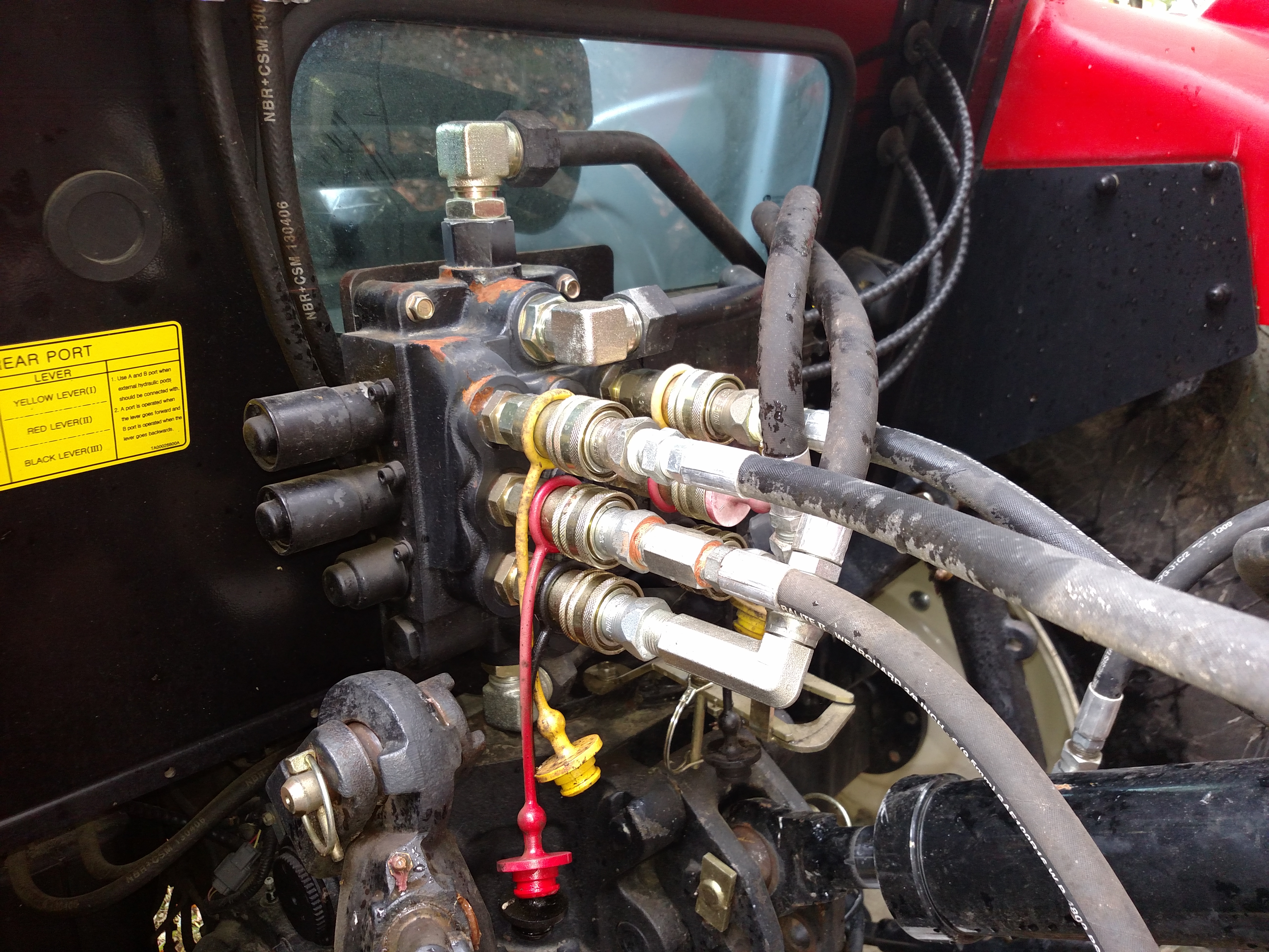

I finally got around to testing my tractor and when I am moving the loader the SCVs don't get any flow at all (or at least not enough for the tilt cylinder to raise the box blade). 3pt doesn't get flow either. I think my loader valve sends everything to the tank instead of power beyond. I would prefer a 3rd function for ergonomics. The idea of having to move the curl to position the grapple then
return to center, press the diverter button and move the lever again seems like something I'd have a problem with (like forgetting to center the lever between diverted and not diverted). Having separate controls even if they are buttons makes more sense to me.
But with this loader valve I'd have to stop moving the loader before I could open or close the grapple. With a diverter I could theoretially raise or lower the loader while opening or closing the grapple if I can get my brain to do it. Its too bad the 3rd function wont' work as I found a good place for the valve under the seat where the gear shift would go on a gear model.

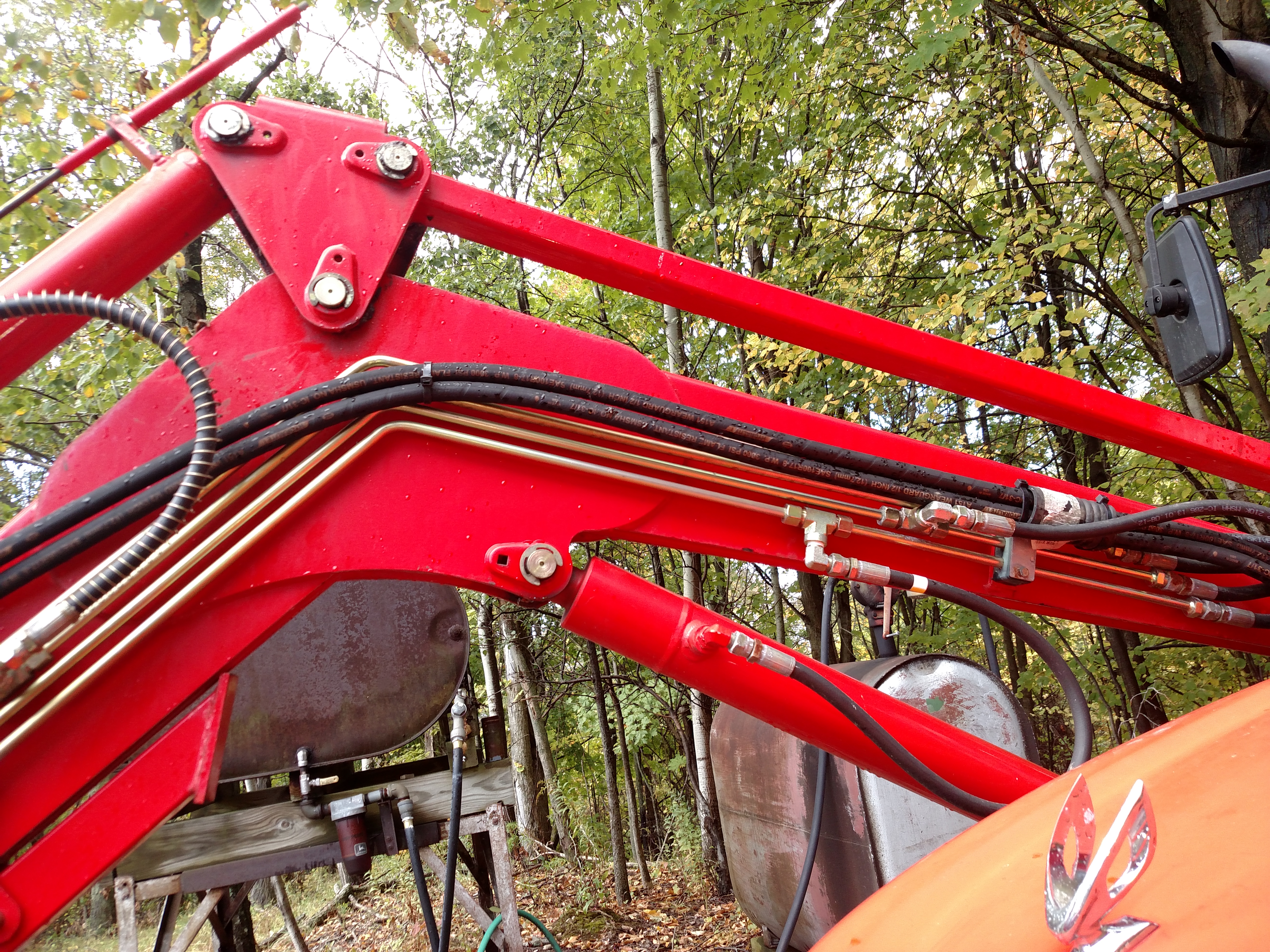

I think I can make a clean setup with the diverter by disconnnecting the hard lines from the tees that feed the curl cylinders on each side. Those are out on the loader near the torque tube so I'd only need short hoses to a diverter located out on the torque tube.
