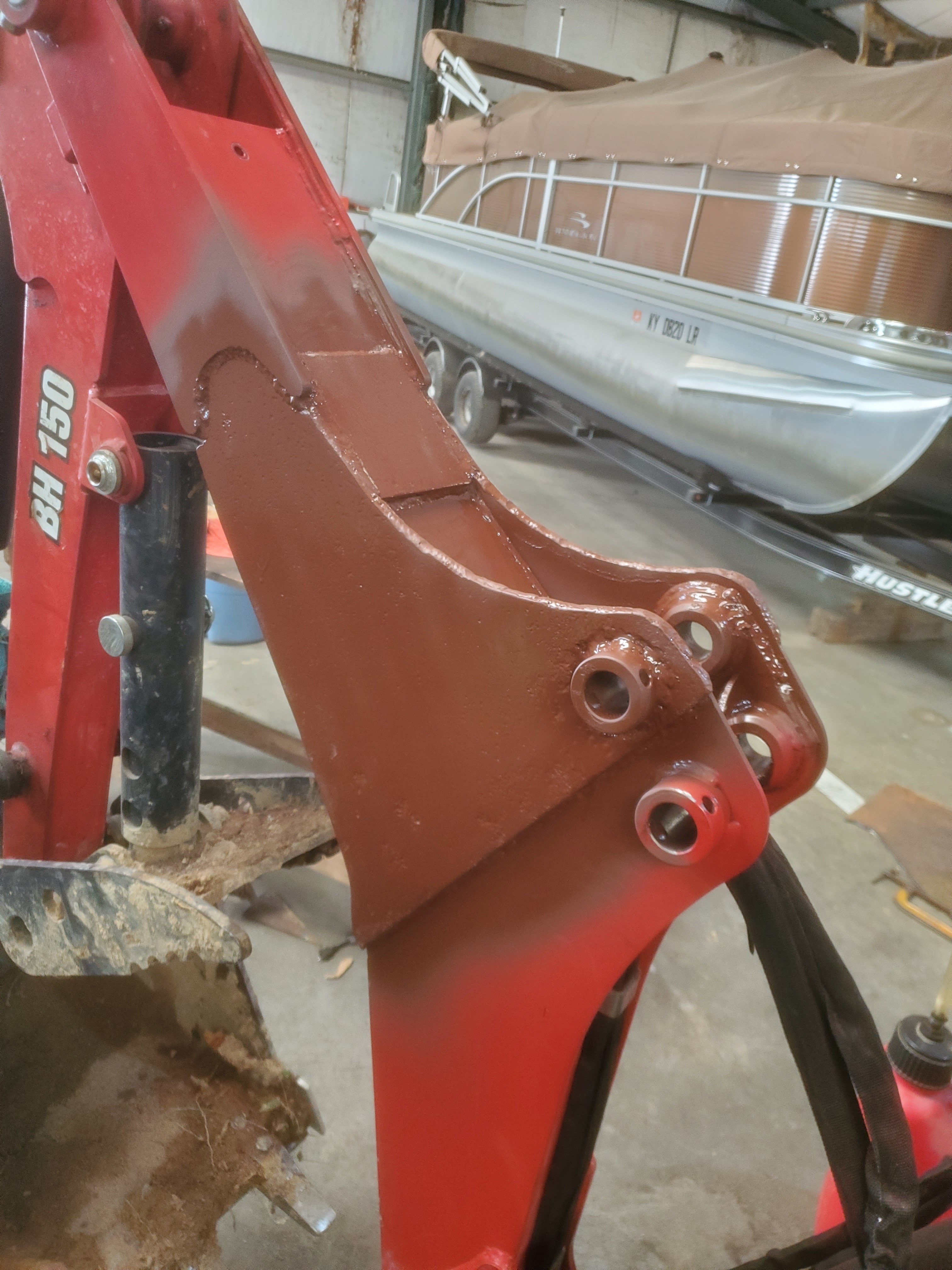

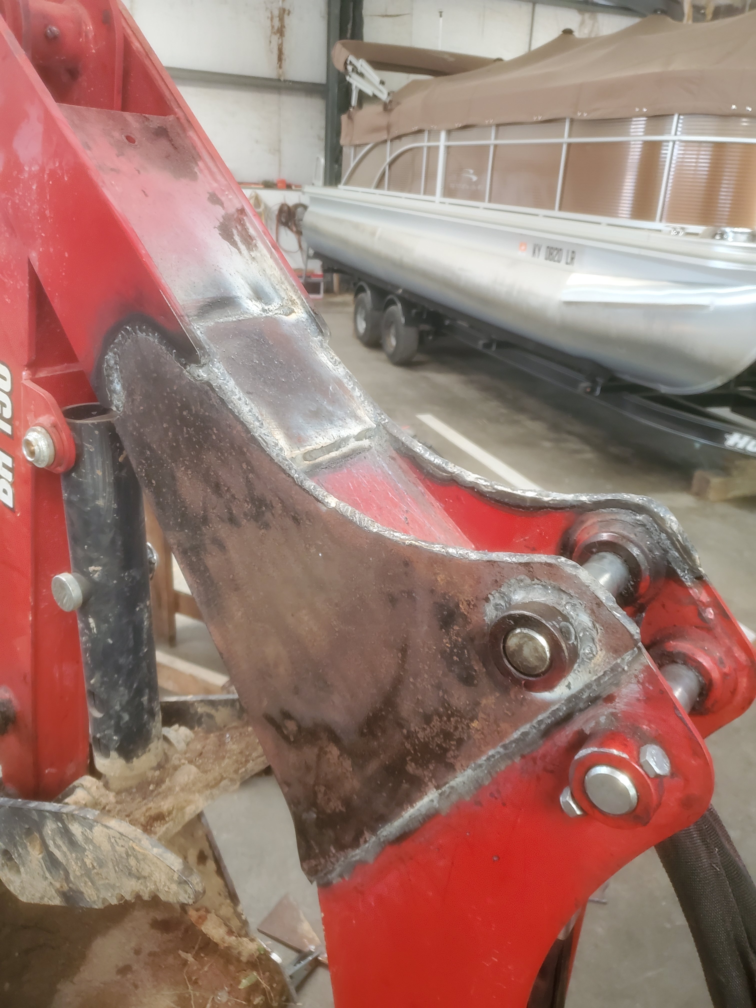

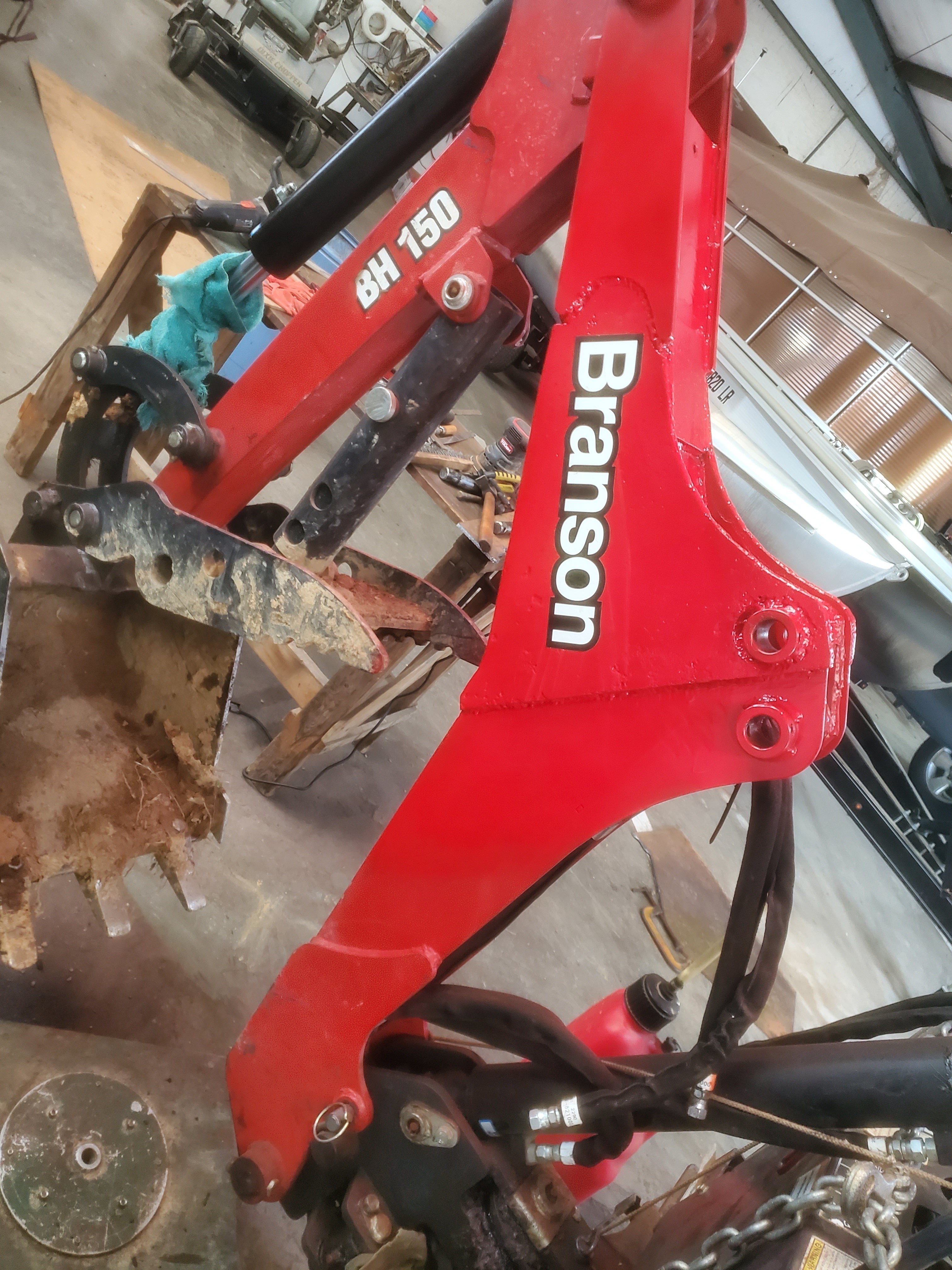

Ok, three days later and thanks to HF $100 welder, el cheapo Chinese made and amazon bought plasma cutter, 1/4" metal, my crappy fabrication skills, my crappy welding abilities and welds which look more like birds $hit, the tractor is back to normal. Now if we have a nuclear attack, everything will be distorted, but this boom will stay intact.

Nice, now just back into that same stump to see if it holds. ;)
