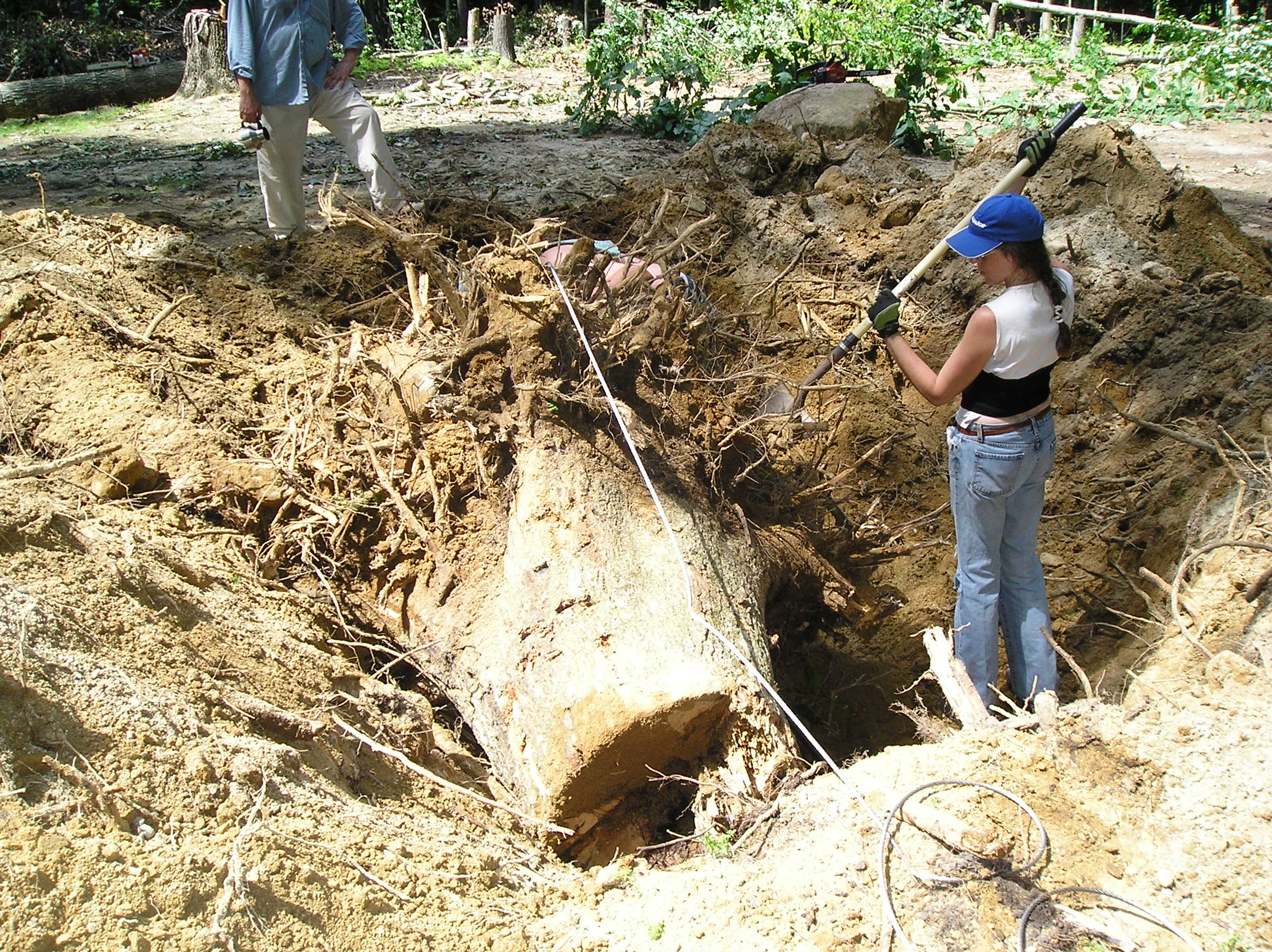

This one is still in the hole, ran out of time. I'll cut the rest of the wood off and see if I can pull the root ball out....if not I'll have to dig a ramp.
That's the wife prying rocks out of the roots trying to lighten it up. Not sure what it weighs, but my L35 couldn't pull it out. Don't abuse your BX24 too much.:D
Uh, that's quite large. :eek:
