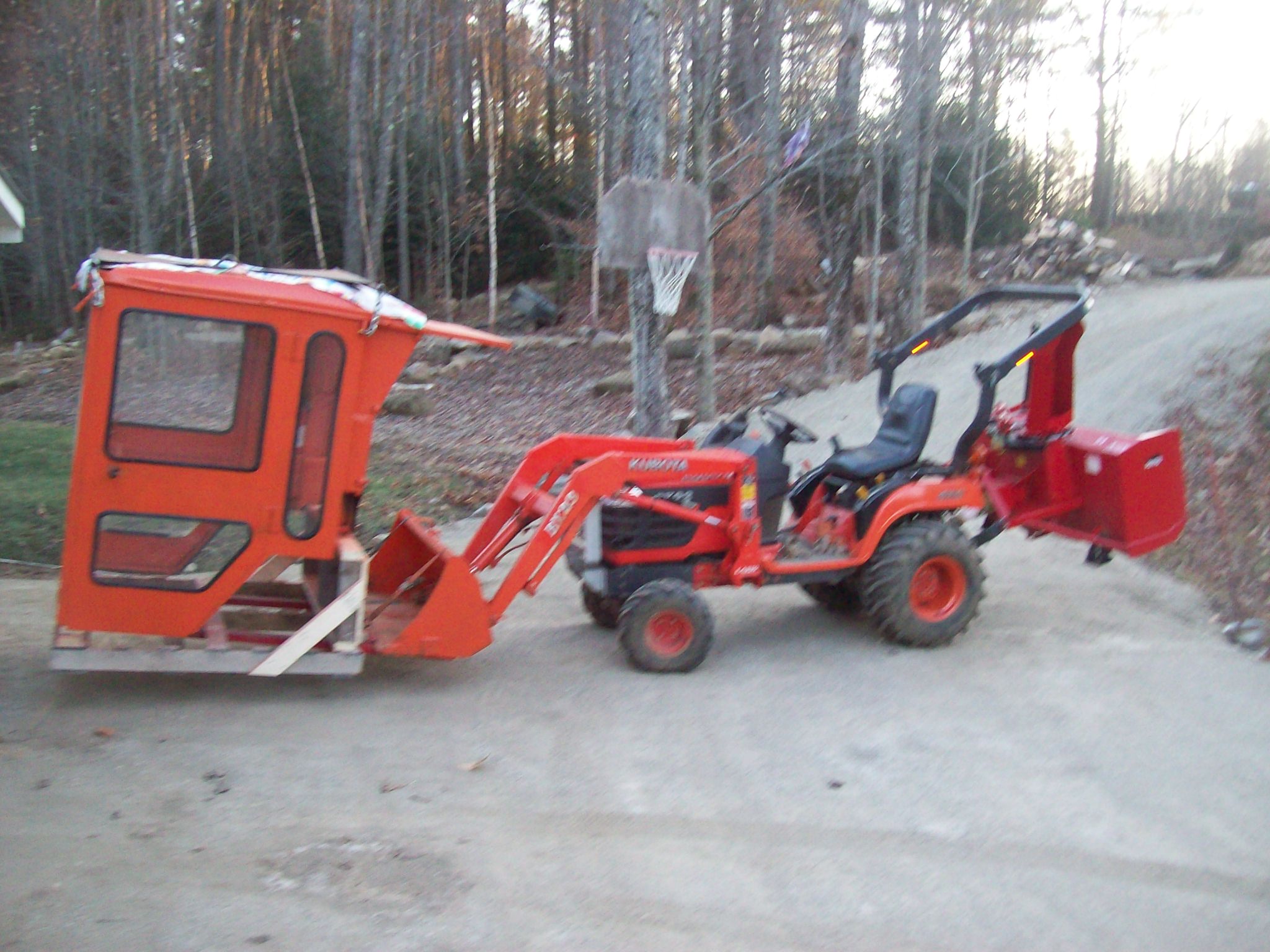

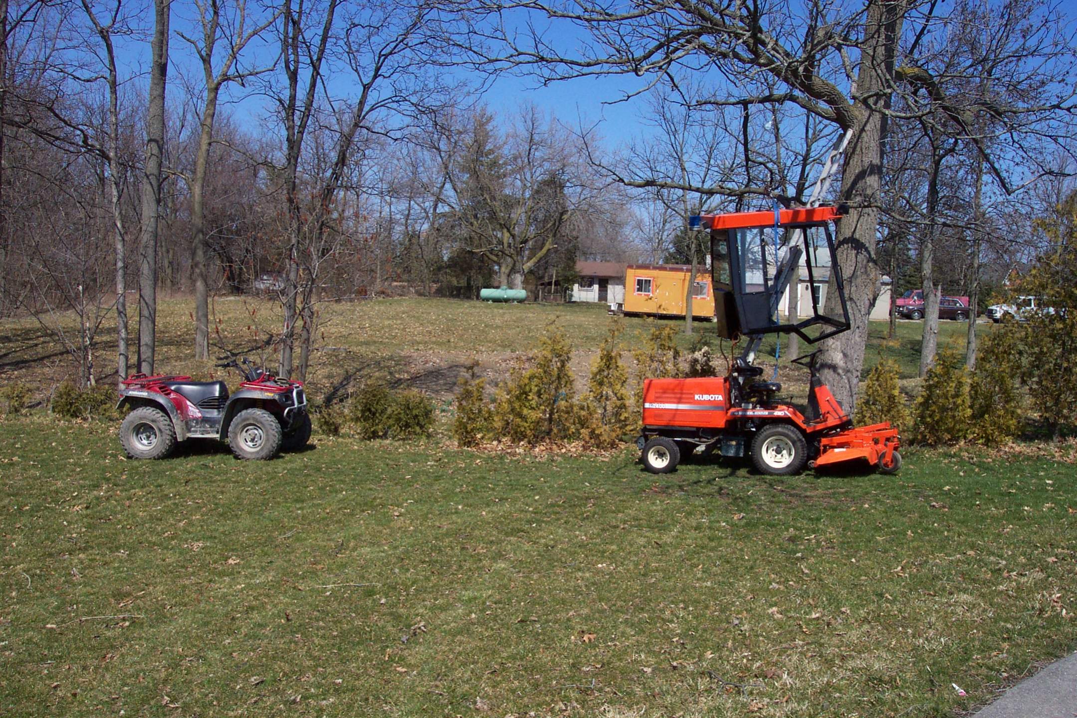

Have you got a good sized tree limb handy that you can attach a pulley to to lift your cab? That's what I did before I set up a hoist inside my garage. I used the winch on my ATV to lift and lower the cab as required. I'm working on a smaller scale that you but the same principle applies. I put the cab on for the winter and take it off for the summer. It only takes about two hours each way.

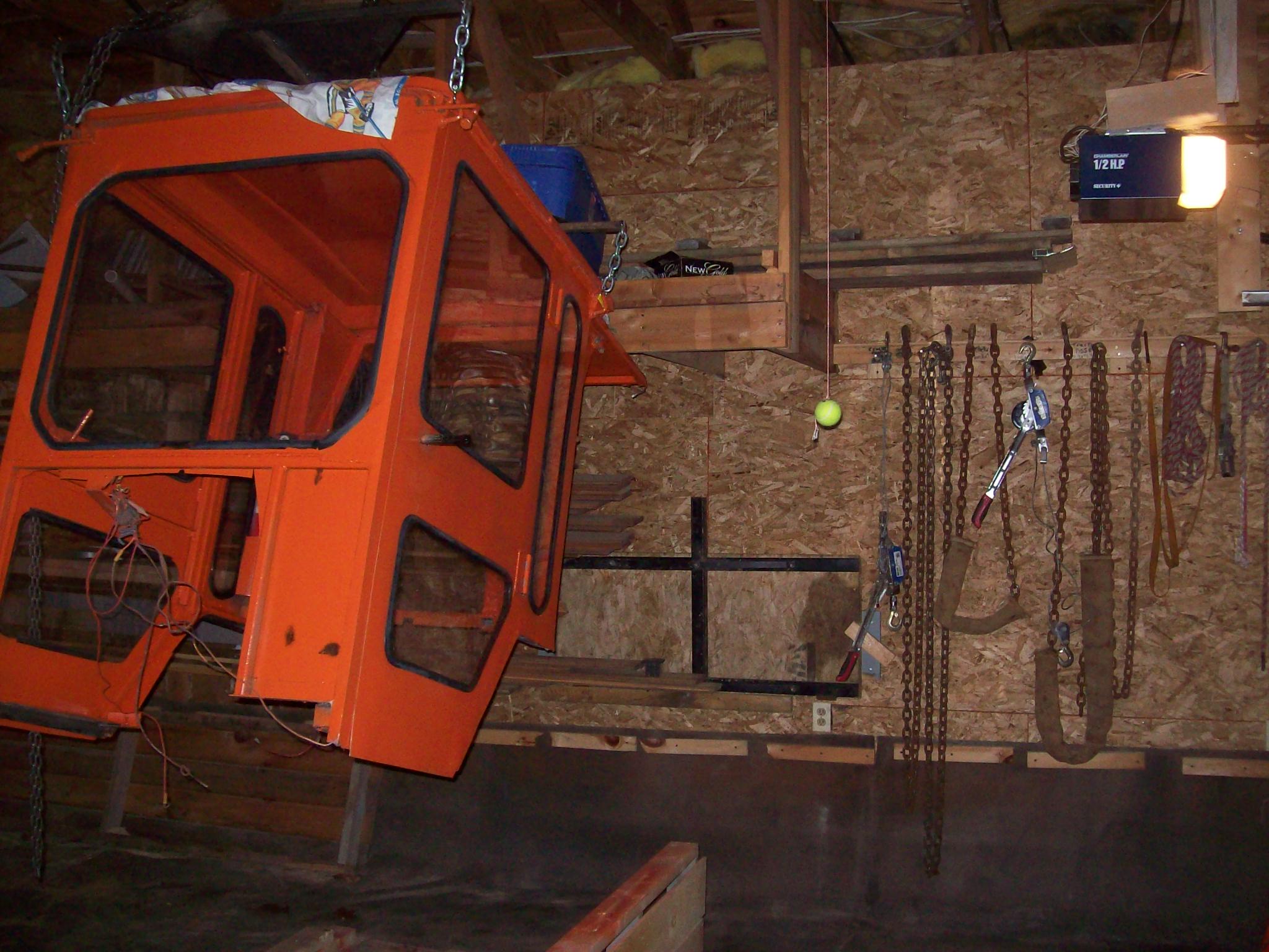

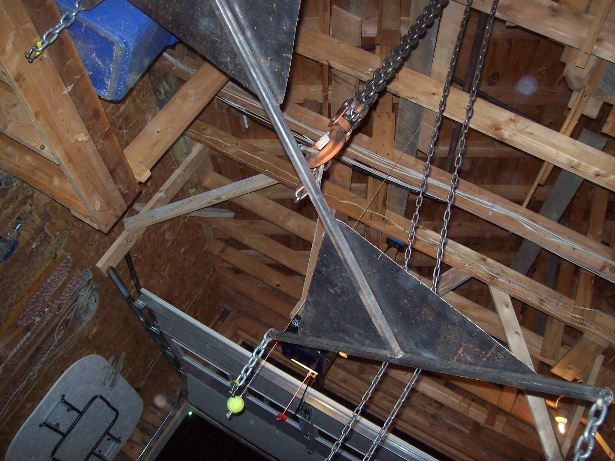

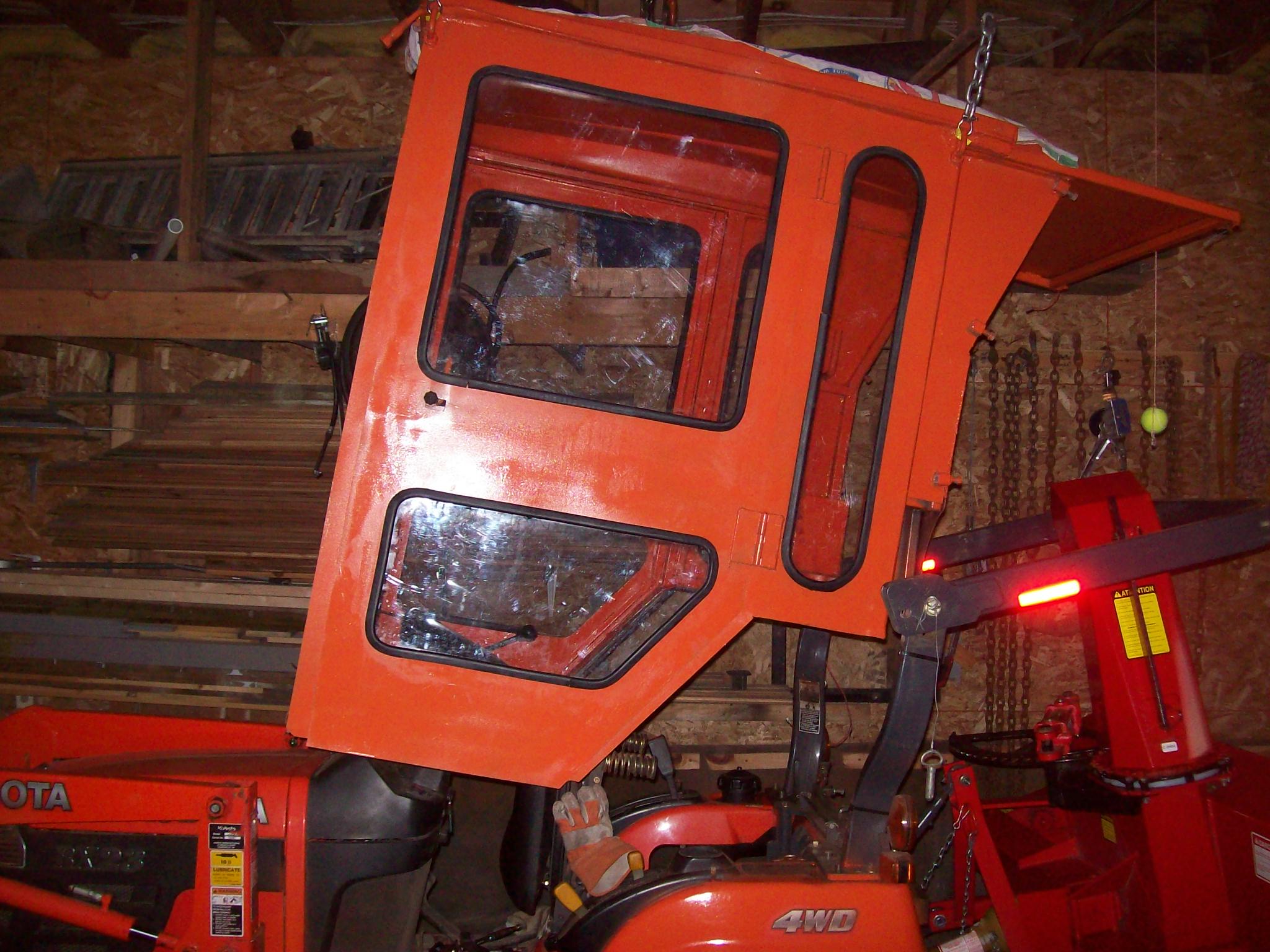

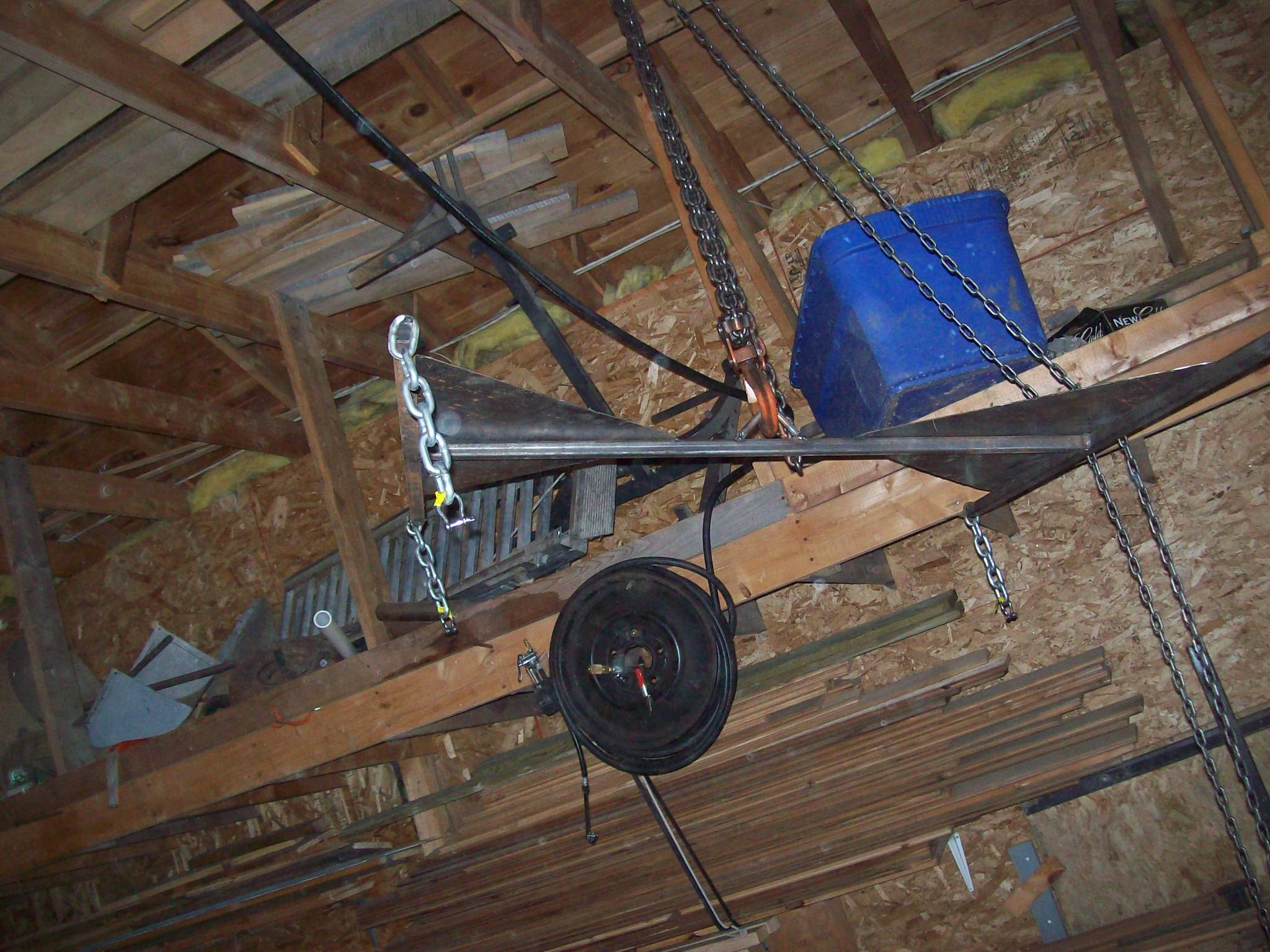

CHAIN FALLS ,and a homemade equalizer
