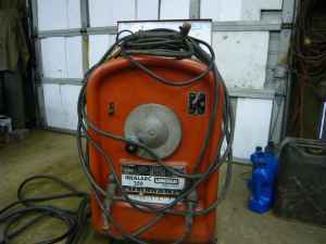

Every once in awhile you stumble onto a good deal. I picked up one of these, with a Miller high frequency box, air cooled Tig torch, some lead, ground clamp, and stinger for $50.00. But don't hold your breath waiting for that to happen again!
