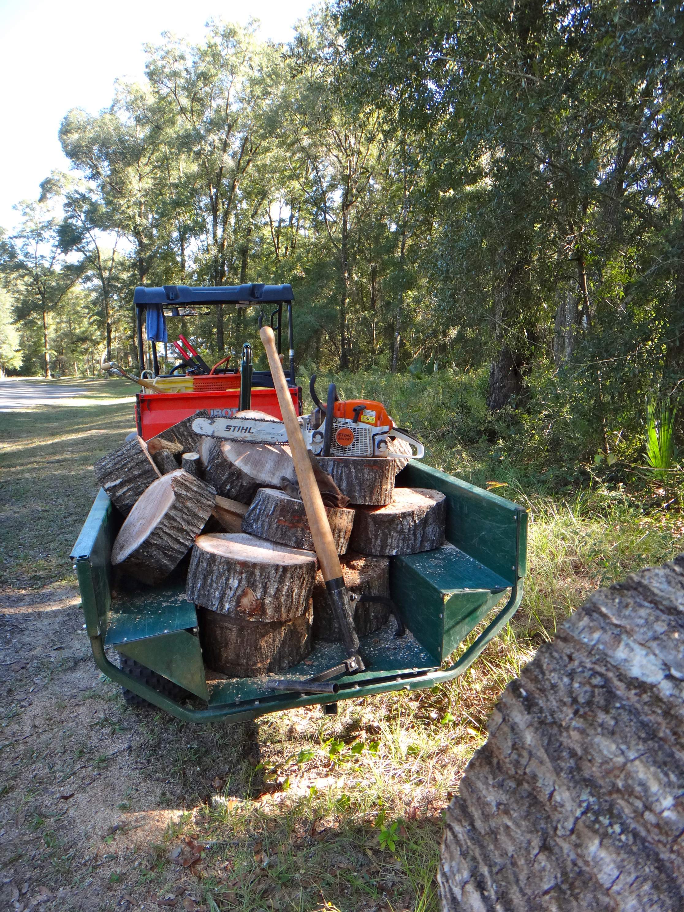

If you want to take the trailer over rough, uneven ground you want a trailer where the load is carried low, between the wheels, like the MUTS, not high, above the wheels. See photo.

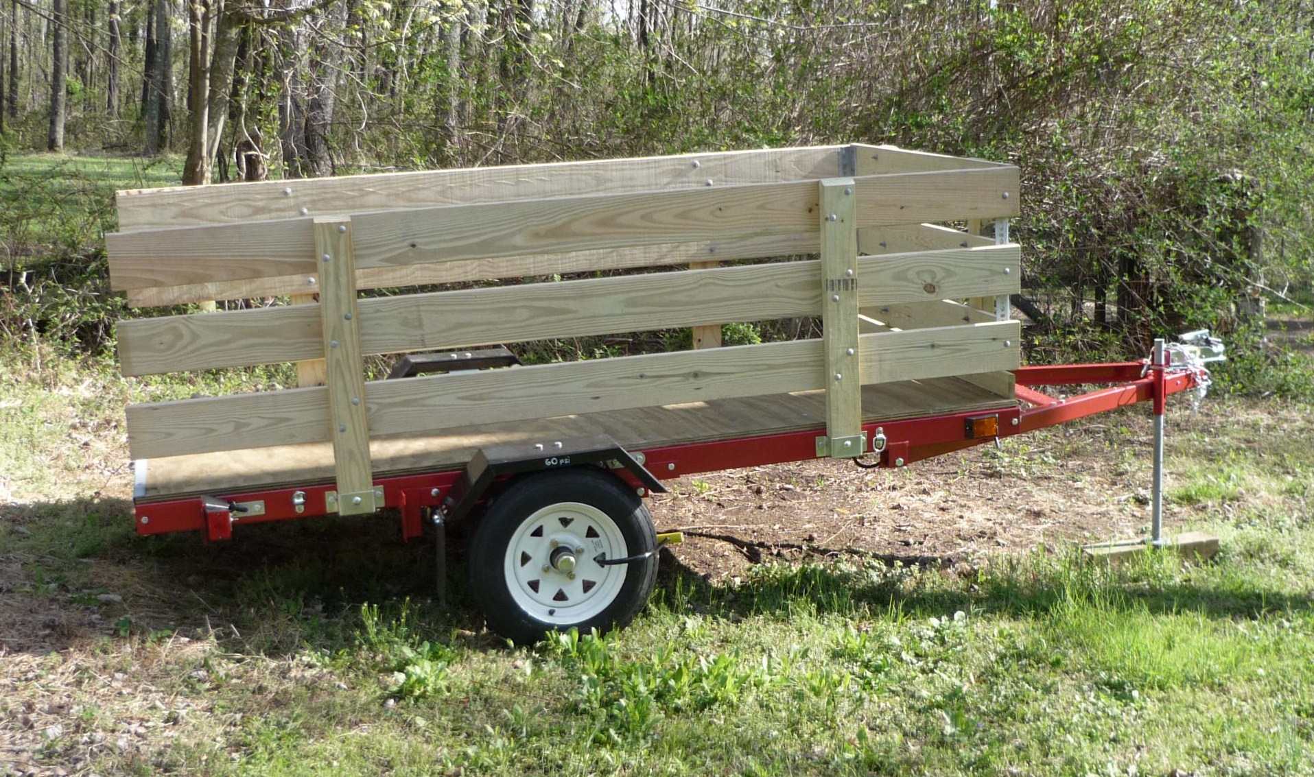

I've got the HF 4' x 8' trailer, which I got on sale for around $230 a few years ago, and I put about the same amount into deck and sides and ramp. I use it for many things, hauling wood is one. But, I just recently saw one of these for sale, an assembled kit, new, for $150 on Craig's List, and almost bought it just for wood. The problem is small tires, which don't have much flotation on soft ground when you have a half ton of wood in the trailer... I was going to finish it like my other little trailer, but decided to keep looking for an off-road only trailer.
Ironton Utility Trailer Kit with 40in. x 48in. Bed — 1060-Lb. Capacity | Trailers| Northern Tool + Equipment
P1010170.JPG (trailer now has a 4' x 4' hinged steel mesh ramp for loading and some other goodies- as well as rusted paint- HF uses lousy paint.)

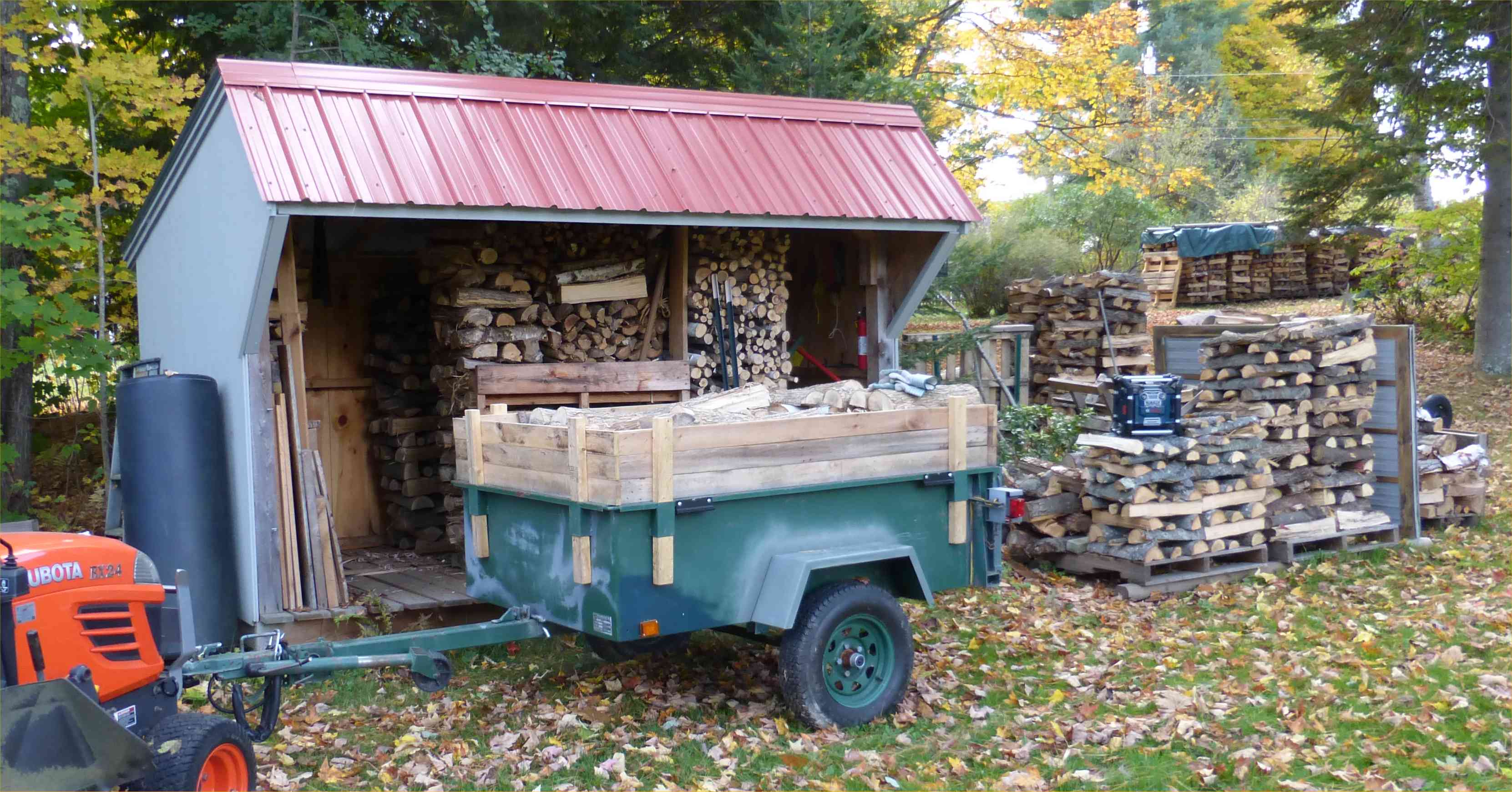

PeterK,,I like that wood shed build, I think I'll copy your set-up.:thumbsup:
It's an Adirondack style lean-to. Basically a shed with an overhang, all local Hemlock post and beam construction. Floor and back wall are spaced for air flow. Thanks!

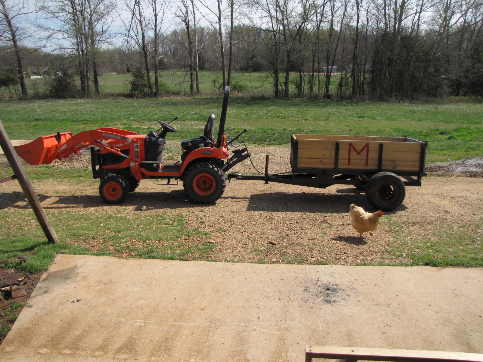

This one I made for my BX2660 and it's just right. It's hyd dump.

Leejohn's above is about right - if he would just make another and sell it to me for $500!!! I could use some kind of hand crank with cable just like boat trailers for the dump to avoid the cost and complexity of hydraulics but the small size with bigger tires looks like a must have.
