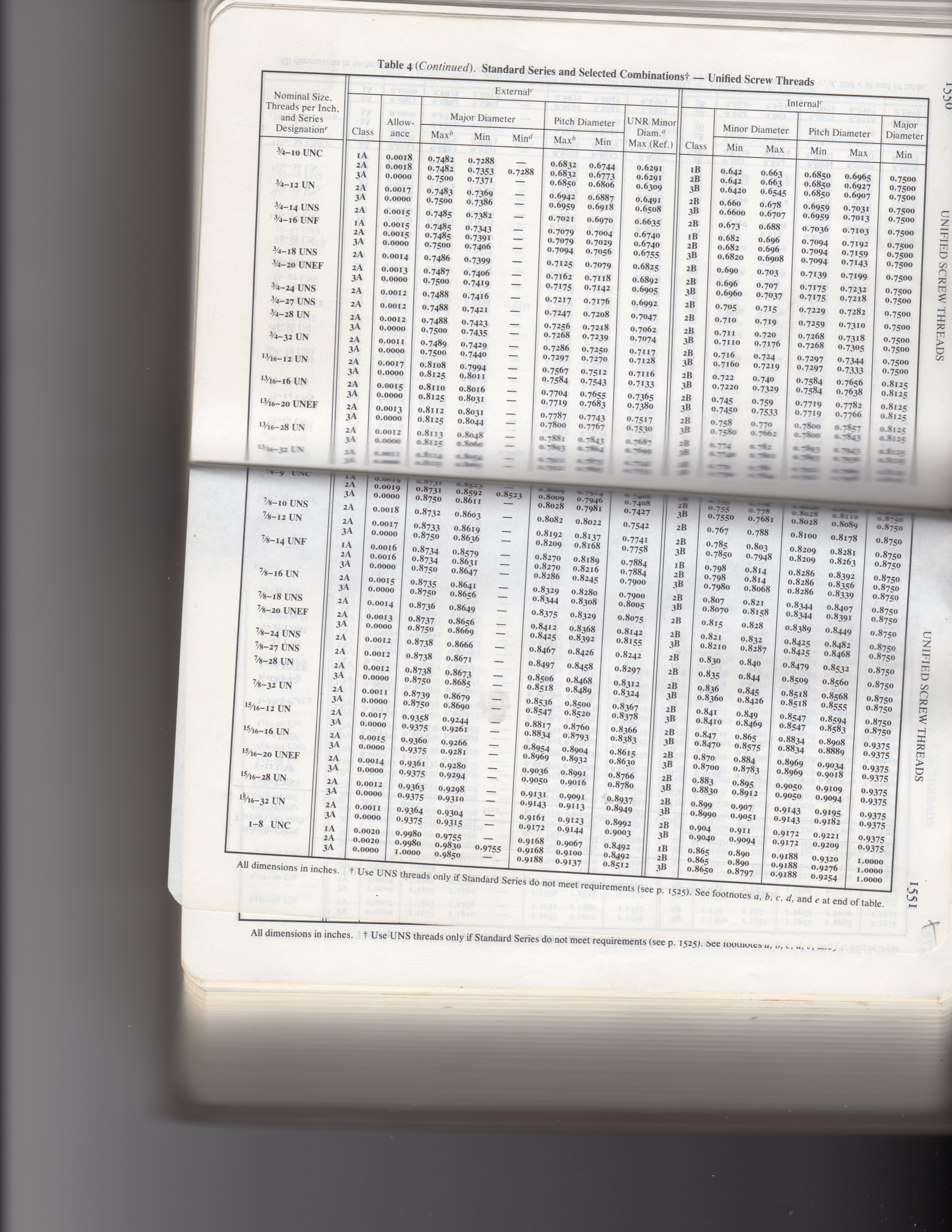

The vast majority of trailer balls are sold on price, as a generic commodity. As such, components such as nuts are going to be common, off the shelf items. The guy that laid a pitch gauge against three threads and came up with a 14 pitch probably would have called it 12 if he had tried that gauge first. He used bad methods and very likely came up with an incorrect result. Remove the nut and fill the pitch gauge across its full length.
Full exposure of threads, ball is off the hitch, full engagement of thread gauge.... 1x14tpi

This very rare aluminum 2" ball has 1-14 threads.
