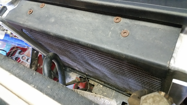

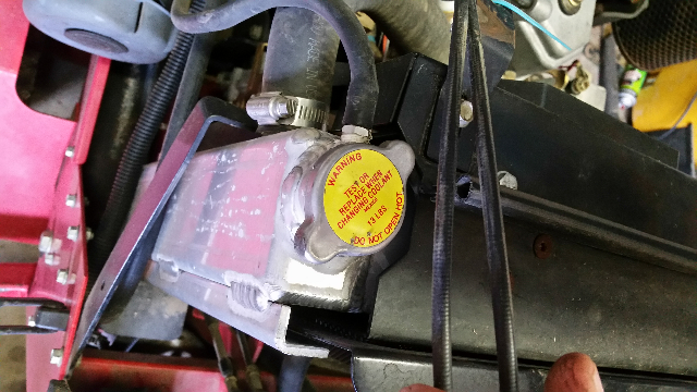

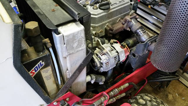

I seen they have a kit for the TD engine at the time I ordered this one,not sure if anything has changed...I found the install sheet for mine,I think this was about a 750.00 radiator, my bill was 1200 but I had alot of other parts in there like a head gasket,all filters,fan belt,thermostat,and other misc parts...I can run my machine with the screen plugged and it's never got over 190 yet,I clean the screen after every mowing, or if it gets hot while mowing, it never does though.The turbo diesel engine has a known cooling problem,more of them than not overheat on hot days ,my dealer has one that overheats after an hour of use and simply cannot fix it,he's tried everything. .idling til it comes down off 220 is the only thing that stops it..if I were you I'd be careful with that machine those engines are expensive and have a very high failure rate..even when properly maintained..
