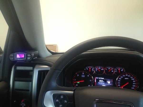

so I got a prodigy P3...I dont plan on using it often...and I am a big guy so theres not a lot of mounting locations that are out of the way that my knee wont smash into (I have the captains chairs in the front so I dont have that space under the dash in the middle).
Any thoughts about putting it under the driver's seat?
There is a raised flat surface under the front center of the driver's seat. I could velcro it right there for easy install/removal but that might not be a fixed enough position for it to work as well as it needs to...so I could always drill in and mount it there. Issue would be that the controller would either be facing backwards or facing the correct direction but I wouldnt be able to see the front of it as the front of the unit would be facing the area under the seat....

You must be able to access it while driving to tune it to the load and test.

Mount the controller the way the manufacture requires it to be. If you were on the road by yourself it wouldn't be a problem. Please keep it safe. I've use the Prodigy P2 for years without an issue pulling loads between a few thousands up to 15000 plus animals. As long as I've set the controller before I pull the load works great. As far as location you can (I believe the manufacture allows this) mount on the top of the dash.

If you're concerned about room I would mount it on the dash as RPW suggested.
In fact that's actually what I did because I didn't want to deal with smacking my knees on my P3.
I used a large chunk of Velcro for dashes and vinyl to attach it as I wasn't sure about screwing the mounting bracket to the dash (padded dash). The controller has stayed where it was placed and has worked flawlessly since installation. That being said, I have yet to have a need to disconnect it and remove it from the dash. I really can't see the need to do that unless something is malfunctioning.
Anyways, I'm left handed and it's actually an easier reach for me than if I had mounted it on the knee boards of the dash. If I remember correctly the only major sticking point for the P3's in regards to mounting was that they needed to be level from side to to side.
/ high level intro to brake controllers? #15
<img src="http://www.tractorbynet.com/forums/attachment.php?attachmentid=424065"/>
