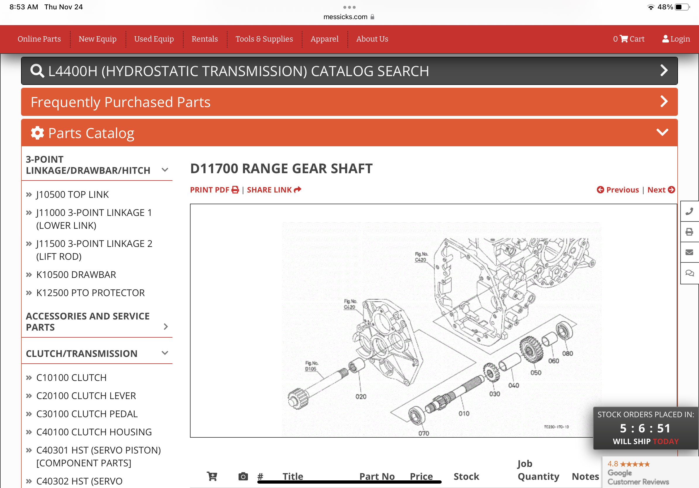

I have a Kubota L4400 HST and had to drive it on pavement for 6 miles from repair shop. In High gear with full acceleration, it would not climb the hill until I moved to "medium" gear. Appreciate any input from anyone regarding this.
I'd say what you are describing is typical of every Ag, utility, and compact tractor I've ever driven. None of them would pull high gear on the road against even the slightest incline. It's true of our little 15 hp imports and also true of our 100+ hp JDs.
That's just how tractors tend to be geared and powered. Going slightly downhill - even very slightly downhill - is a whole different story. Then even the most underpowered ones will quickly get going too fast for their steering and brakes.
