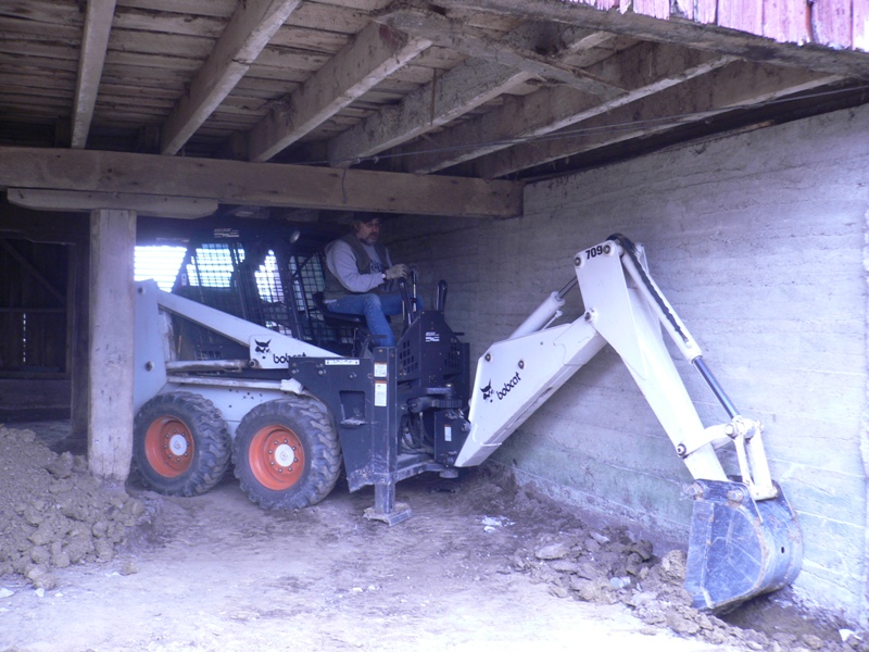

I wouldn't consider the 607 myself, one has to re-position often with the 709 as it is, the longer reach also lets you put the spoils further away when digging. No problem loading a 3 yard (1 ton) truck with the 709 either.
The vertical stabilizers allow you to sit close to something, for many of the jobs I've done with mine, outrigger type wouldn't work.
Not an inch to spare on this one.....
