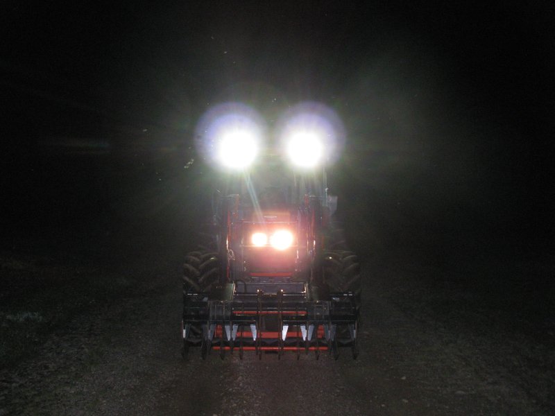

I do a fair amount of work at night and needed a lot more light to be able to see properly so I did a bit of reading up on HID light conversions. A good choice for my cabcorner lights was a kit from VVME on EBay. 35w, 4300k light temperature, and H3 bulbs to match the stock floods on my M105S. It required drilling holes in the back of the flood housings because the H3 HID bulbs stick out about an inch farther than regular H3 bulbs. The kits come with rubber boots to make the housings weatherproof after the mods.

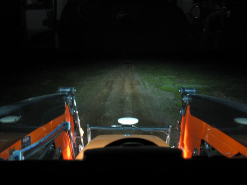

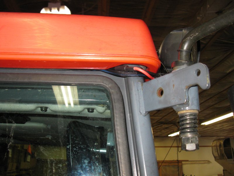

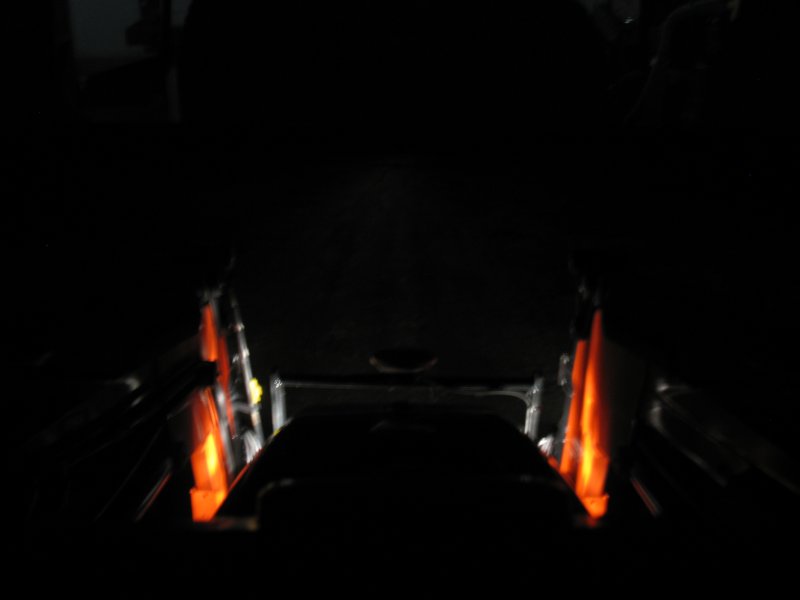

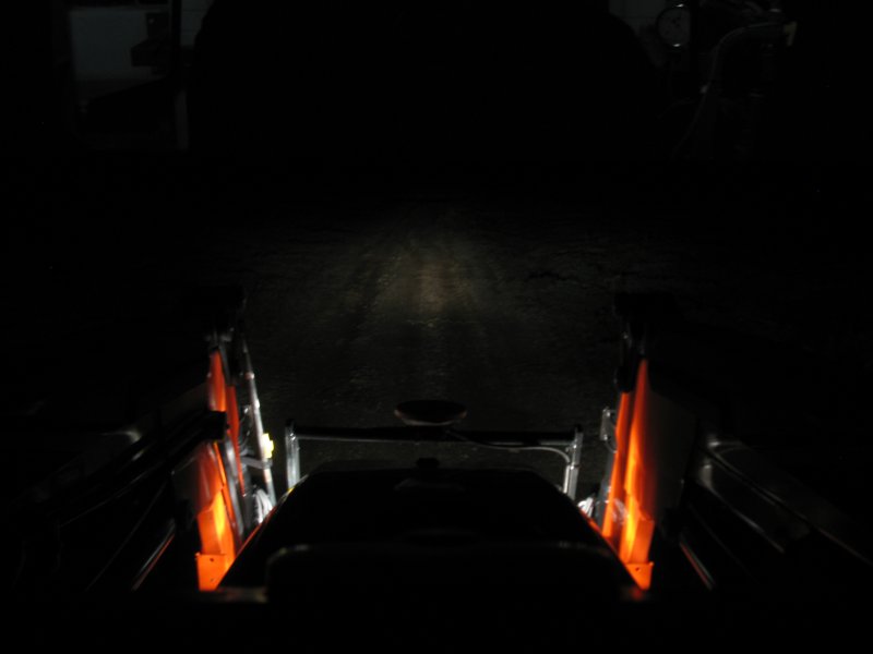

The following pix show where I tucked the wires under the cab roof and some pics of the lights at night. The views from the tractor seat were taken without a flash. One shows the stock 45w lowbeams, one the 45w highbeams (looks like no lights are on because they're aimed a bit high), and the other what it looks like when I flick the HID floods on. There's another pic (using a flash) looking at the front of the tractor with both turned on.

Basically, I just unscrewed the bolts inside the cab that hold the roof on, tilted it backwards a bit, and set the ballasts on top of the ceiling, dropped the roof back down, and tightened it up. I made sure the wires were tucked in behind the steel corner upright (shown in the pic) to help the front of the roof stay sealed better against water and dust. There's a sweet spot just next to and behind the post that looks the best to me. I may have to add a little rubber or foam weatherstripping to keep nature out, but no problems so far.
I thought I took more pics of the extra rubber boot at the back of the light housing but I can't find 'em.
