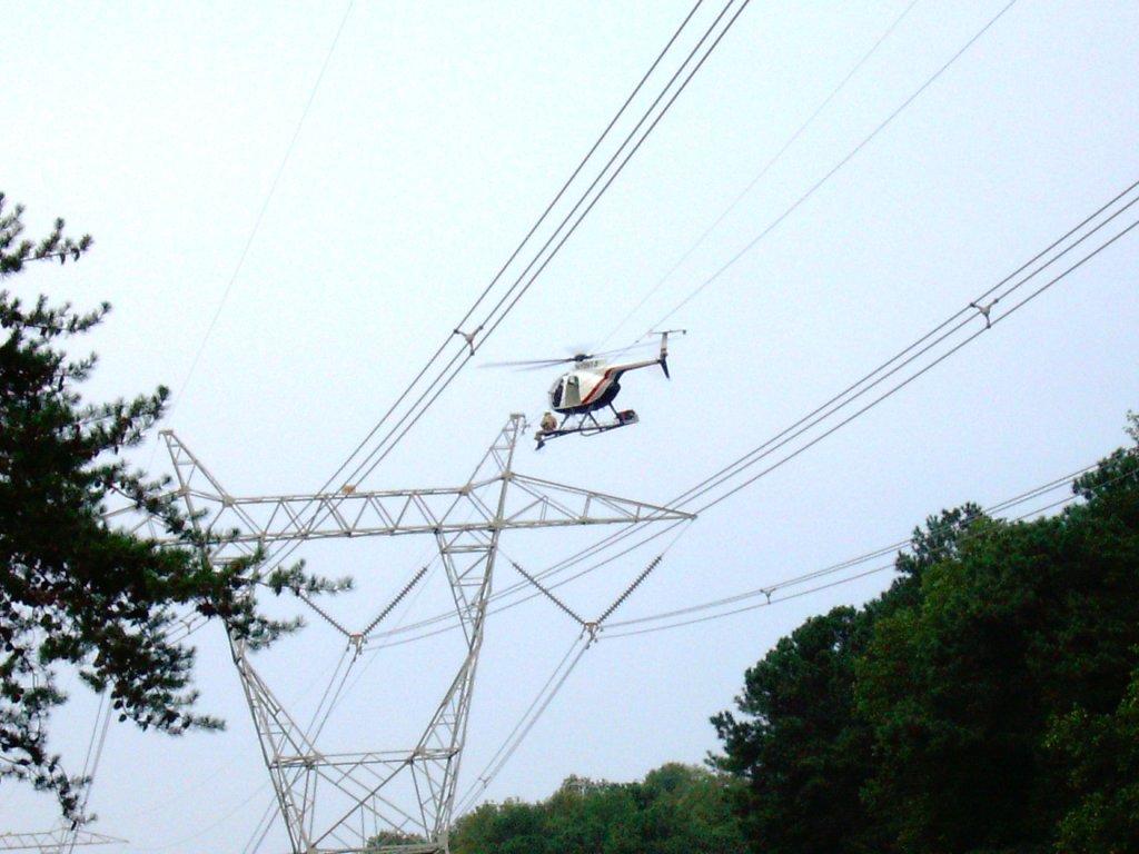

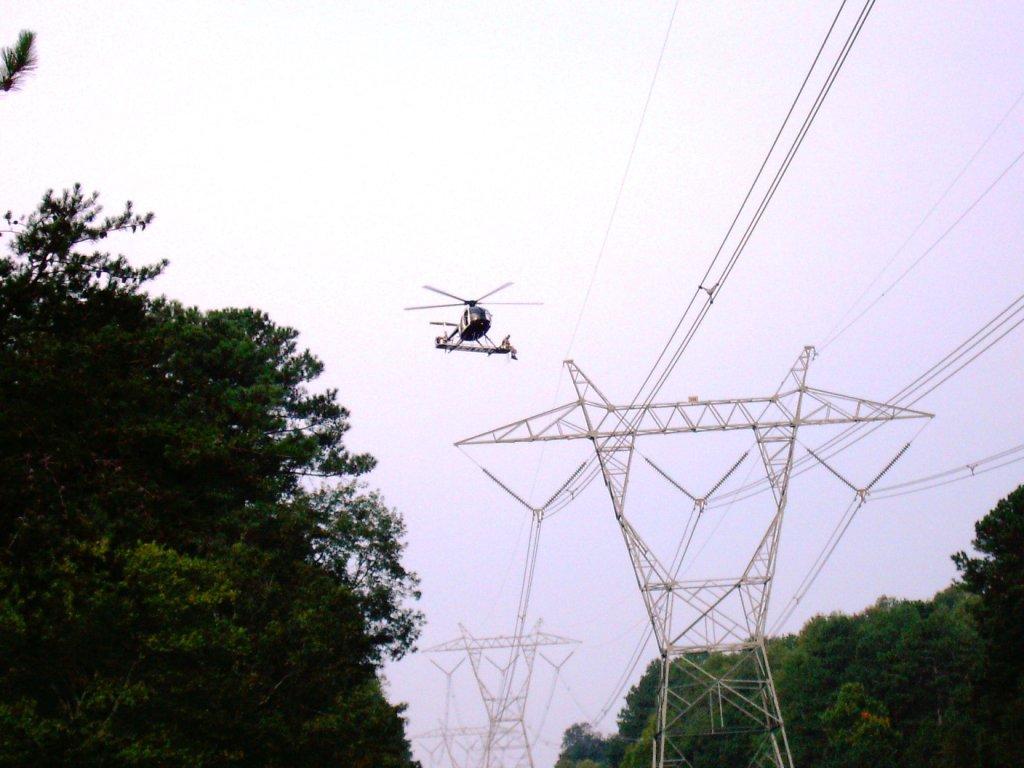

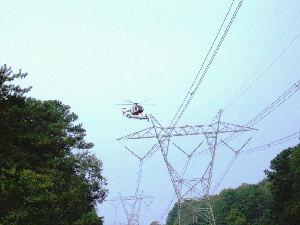

Hi folks,
Maybe this doesn't fit in the Safety forum, but where else?
Heard choppers very low behind my house this morning and went to look (with the camera) and saw this. Amazing! Both pilot and lineman must have nerves with more steel than those towers. These are 500kv lines. Wonder if OSHA approves?
- Jay

I saw a tv show on that, may have been discovery channel. You'd really have to trust your pilot.

Hiya,
I have a buddy that does that. He gets paid very well come to think of it. They wear a chain suit so the electricity goes around them, and are only able to do the live attach in very specific conditions. Yes, he has some gruesome stories about "safety mishaps".
I'll stick with 12v

It's just like birds that set on wires. You can't get shocked if there's no ground. I saw a show on TV about that also a year or two ago. The one I saw actually had the guy suspended under the chopper on a cable. The main problem was the static discharge from the chopper when they first make contact with the wire. The wire dog makes contact with a grounding rod first and then can make safe contact with the live wires.

Yes, but the other line will serve as a ground and a helicopter easily spans both lines.

The line he is working on in the pictures is the static wire it is not energized but does have a lot of static in it.
DP you are kinda right but birds can't sit on conductors energized at 500KV or even 230KV. The EM field surrounding the conductors will smoke them if they try. That along with potential diff in the body is why we wear the chain male suits. they are really carbon woven fabric that allows us to enter the field while the difference in potential across our bodies is equalized by the low resistance conductors in the fiber.
Without going through a lot of math lets just say the resistance from one side of your hand to the other is small enough at these voltages to cause large currents to flow through you with out the protective suits. This current flow is also called cooking which is not a good thing to living things.
I have been energized at 500kv a few times and it does give you a strange feeling and make you glad to be back on the ground.

those copters do inspections, repairs, etc. at tremendous savings. picture doing similar work from the ground and you can quickly see the advantage of the copter. I attended a safety class associated with line work and there were great videos showing how they approach and connect to the line to do work. As they approach they create a massive sustained blue spark that is awesome and terrifying at the same time.
