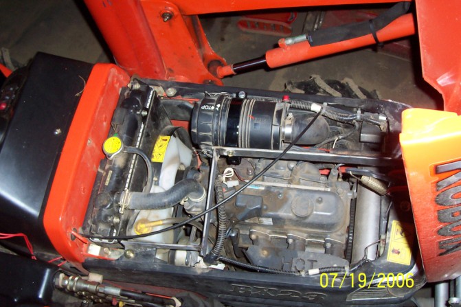

I love my little bx23. I'm pushing 700 hrs on it now with no problems except two broken air cleaner brackets. I've moved tons and tons of dirt building up a pad for my new work shop. Dug the footings (150 ft x 24" wide x 24" deep). Spread and compacted 68 ton of gravel fill in the foundation. Set the walls and roof trusses. Moved snow at home, the neighors, and the church parking lot. Mowed grass, dig stumps, hauled sand bags and raked trash from our little flood here in Evansville, and too many other thing to remember. It's a little work horse, I don't know how I ever got along with out it. I saw your thread on the cab, awesome job. If you put a windshield wiper on it you will need to put safty glass in for the windshield as plastic will scratch too easley. Waiting to see the finished product.

RON, i bought all lexan for the cab ,except the windsheild ,and all the gasket.The glass company told me if i put small gussets or have round corners the gasket will work,and look better,so i did,They are gonna cut my windsheild when im ready,will be one of the last things.
Heres a pic of my modifyed air cleaner holder.WELD one up and it will end your problems.
ALAN

Alan,
If I am seeing correctly, you have taken the air cleaner bracket off of the engine and mounted it on the engine cowling, right? That's a good move. Next time it breaks, it will get moved. Thanks for the heads up.

YES,Having the aircleaner on the engine was a stupid design,these engines really thrash at idle.Iused some 1 inch flat stock and used the bolts already there that holds the hood and cowl on.Ihad more pics and cant find them,but i painted it orange too.Can take pics if you need some .1/2 HOUR JOB:rolleyes: Can you tell im not afraid to modify my tractor?:D :D
ALAN

Hi Alan - I think I've been gone longer than you have. Good to see you're still coming up with innovative fixes for the BX. I will also do that mod when my aircleaner bracket breaks next time.

HI RADAIR,
Nice to hear from ya!
Iactually did that aircleaner thing a few years ago,now i think,with no issues since.If im not mistaken they redesigned the air cleaner on the BX-24,I DONT THINK THEY HAVE IT THRASHING WITH THE ENGINE ANY MORE.
