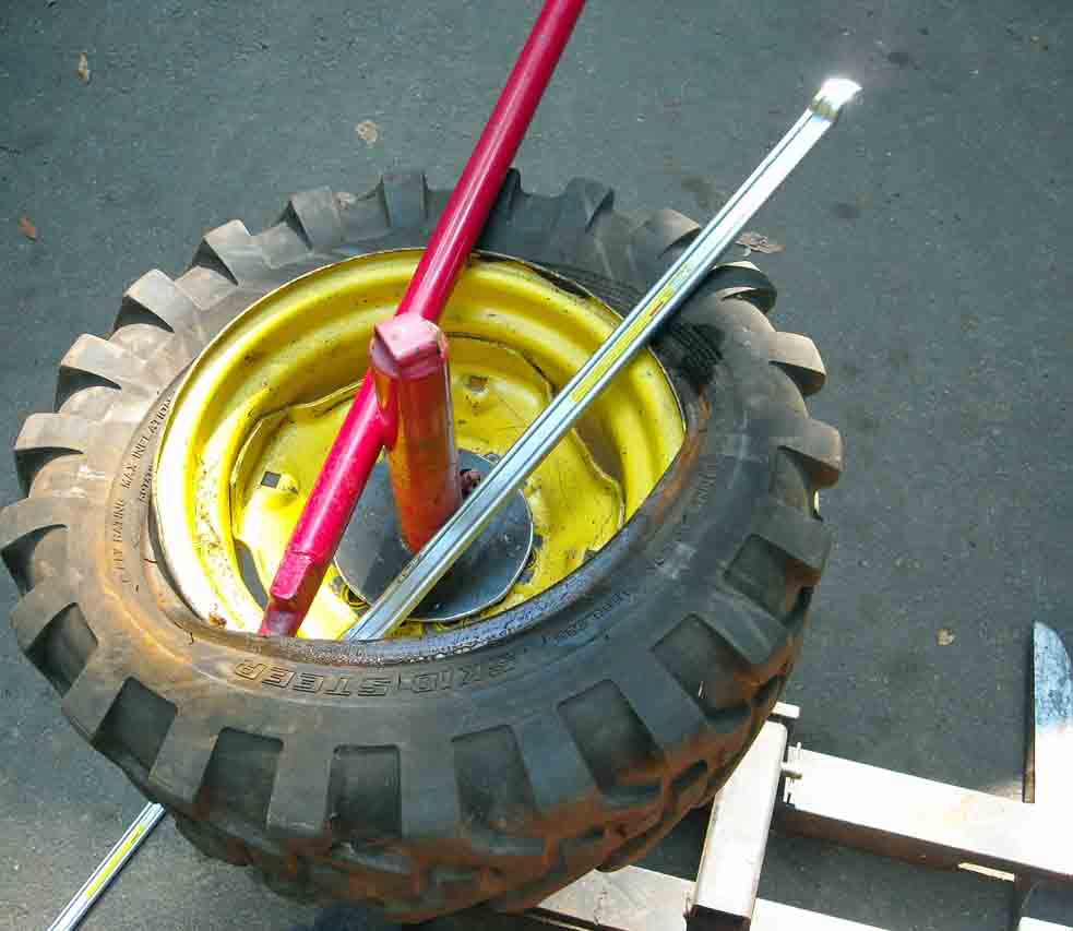

And if they were able to use the long pie tool bar it comes with. I find the end is too thick to do much with So I need using spoons. even though the 'machine' is a good buy ..
Mine cost only $34 years ago, on sale. Don't forget some of those
excellent HF tire irons for only $6 (photo). The bar that comes with
the HF changer works to mount (one end) or dismount (the other end)
once you have things started.
