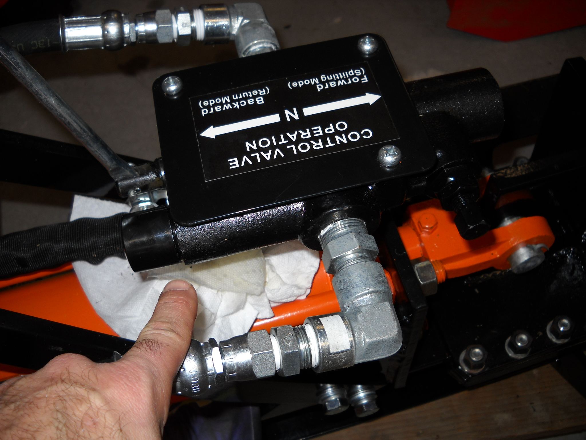

I just hooked up my HF Splitter - although it worked great I noticed a leak (drip) at the control value at the hex nut in the front of the valve - Has anyone experianced this leak?...unfortuntely the splitter manual has very little descriptionon the value - could it be a relief of sorts.....could it be to overfilling?....
   / HF Three Point Log Splitter #74
I just hooked up my HF Splitter - although it worked great I noticed a small drip at the control value - does anyone have any idea of what this hex nut is for? Has anyone experianced this leak?
Yep! Mine leaked slightly there when I first pressurized the valve. I tightened it and have noticed no leakage since. My QA adapters are the only things that leak a few drops everytime I disconnect them.
EDIT: I think that part of the valve sets the pressure required to move the handle to neutral from its detent (return) position. Inside is what sets the pressure to 1100 psi for detent release. I don't know this for sure, but that's my educated (uneducated?) guess.

Thanks guys - it acually leak quite a bit - I'll put a wrench on it tomorrow and see what happens. Other than that it seems to work great - not the speediest but for the price you cant beat it!
I am very happy - thanks for all your input and insight.

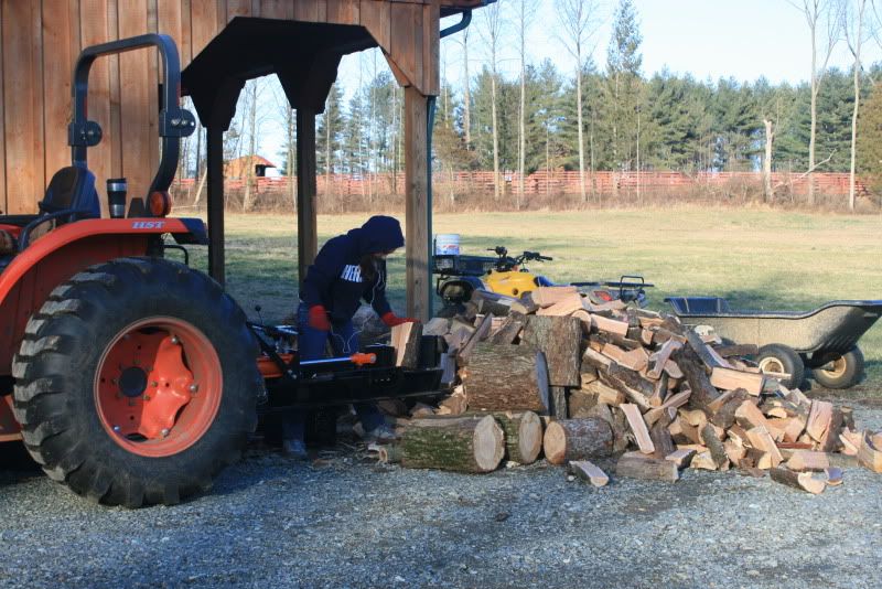

I used the HF splitter for about 4 hours today and no leaks. (Actually I got my daughter to use it for me while I used the chainsaw. She's a good worker!)
