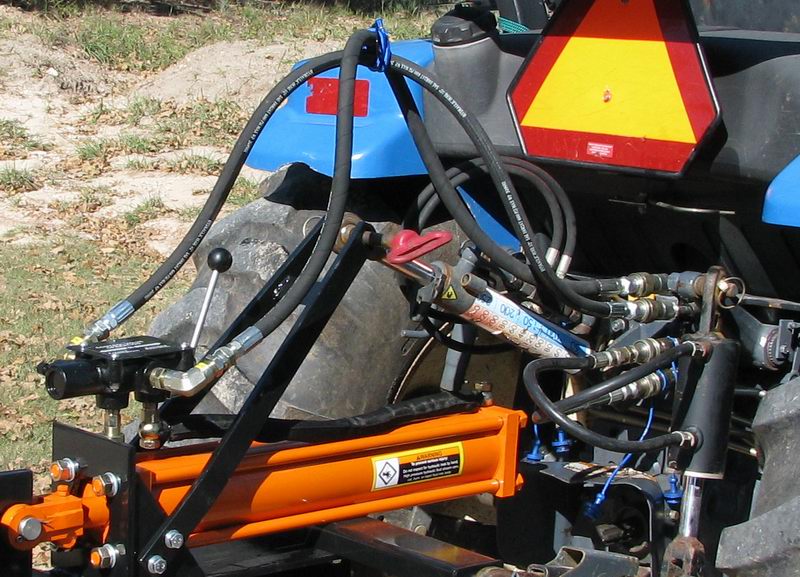

I bought my 48" long x 1/2" hoses off the shelf at TSC, but just because I know this new store is well stocked and also has the Pioneer male quick-connects I needed. I think you can get hoses fabricated with 1/2" male NPT fittings on each end at NAPA auto parts stores too. As a last resort, I'd go to my tractor dealer, but that's just because they are 25 miles away from me. Their stuff is a little more expensive, but it is top of the line. I suspect you will pay a little more at your Kubota dealer, but you'll also have the best hoses and exactly the correct fittings you need. It's a toss-up depending on how much you are willing to spend.
You might even be satisfied with 3/8" hoses. If that's all I could find, I think I might try them. Because they are so short, you'll probably be able to get plenty of flow through a bit smaller hoses to your splitter. If you were running a hydraulic motor I'd say 1/2" is absolutely necessary, but 3/8" will probably work for the splitter. If you get 3/8", you'll have to get adapters for 3/8" to 1/2", so the savings might be a "wash."
