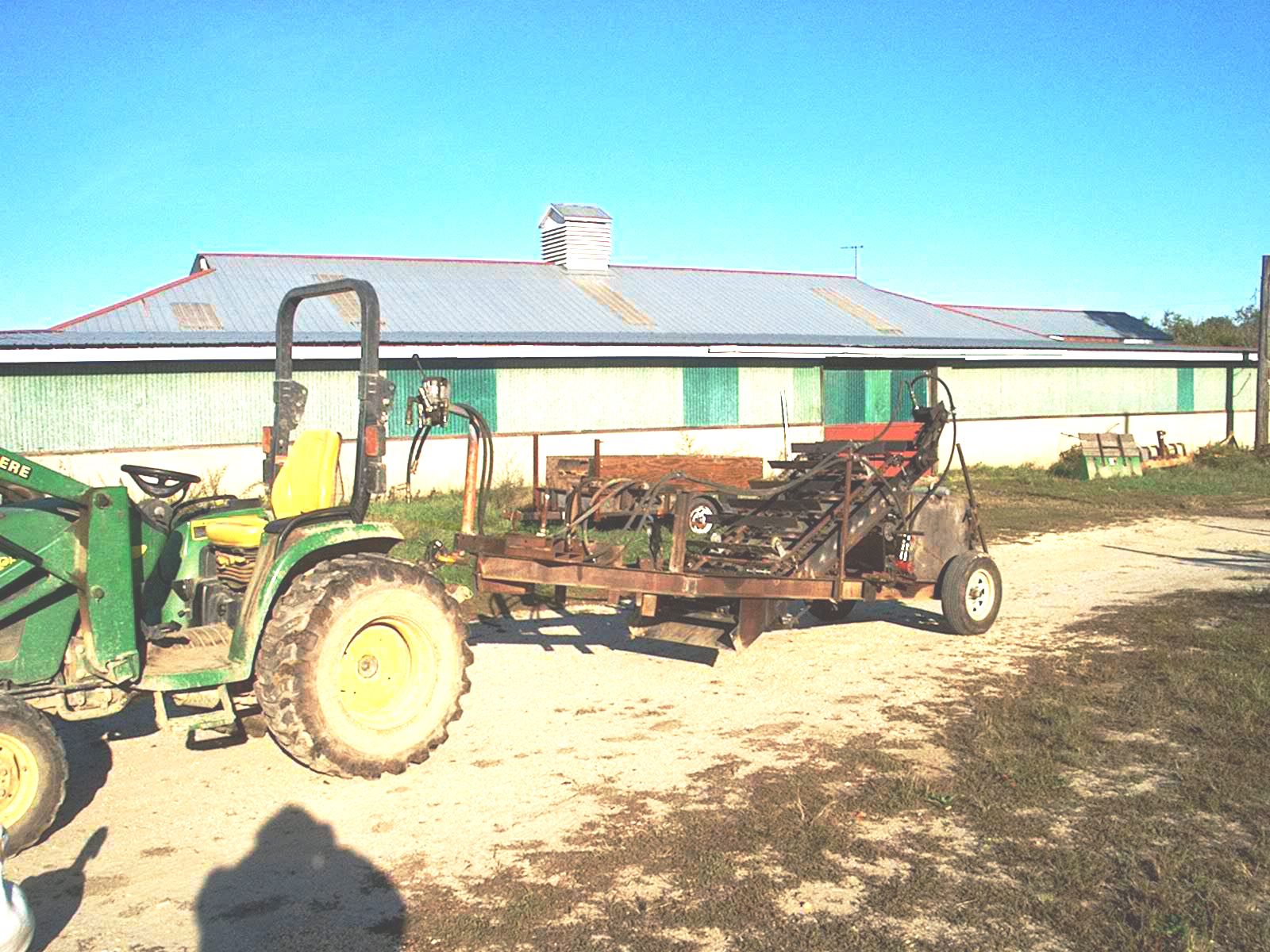

   / Hey soil screening builders #23
here's my answer to the hydraulicaly operated towed screener
   / Hey soil screening builders #24
ChickenMan, your machine is approaching "legendary" status. I have stared at those photos quite a bit.
Question for you, Are you shaking the grate mechanically, if so, how?
Or is it just the conveyor with mostly gravity doing the sifting work?
   / Hey soil screening builders #25
after sorting out the bugs im pleased at how well it cleans
it picks up all but pea sized stones 1/4 to 3/8 inches
