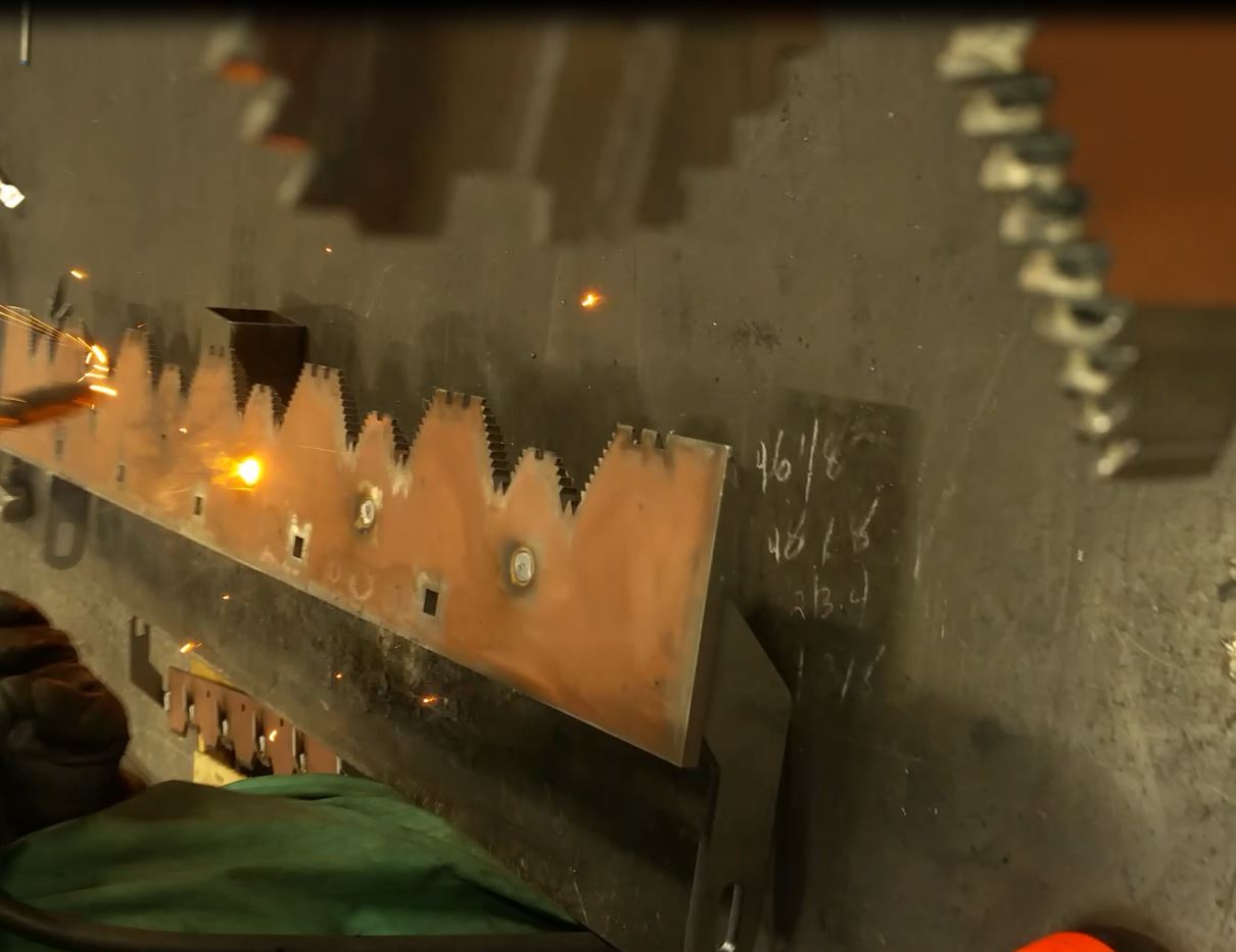

Our Bystronic fiber laser burns some Wicked aggressive teeth for digging, gripping and ripping, which is really effective for sapling and vine removal.

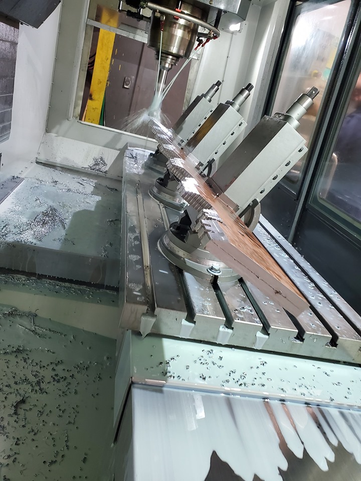

When laser time is complete, it goes to the milling machine for a very aggressive bevel.

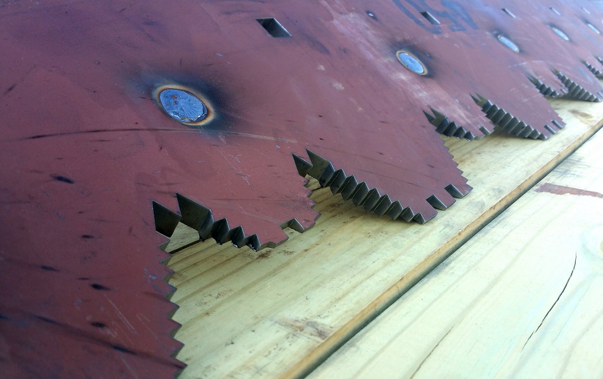

Now she's earning the Wicked name..

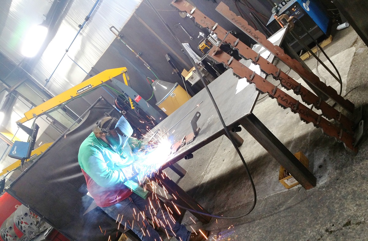

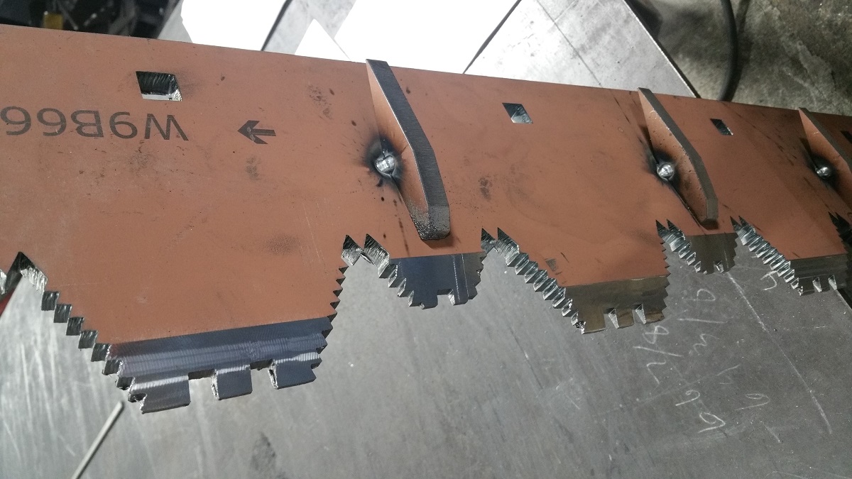

On the welding table, every keeper location is indexed by the laser, so the welder simply inserts square peg into square hole and welds it on the top and bottom of the bar. This same All-Star welder, Ryan, has welded every toothbar we've ever shipped.

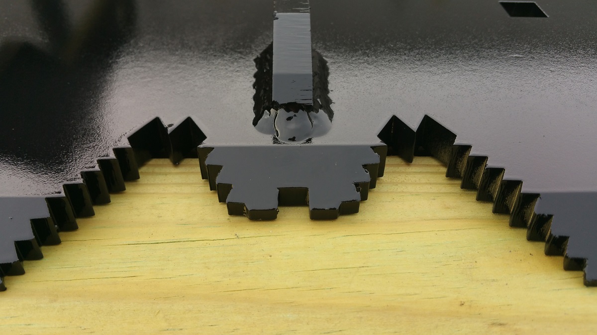

The Wicked Beauty is now ready for paint.
The end result is quite artful and extremely capable.
