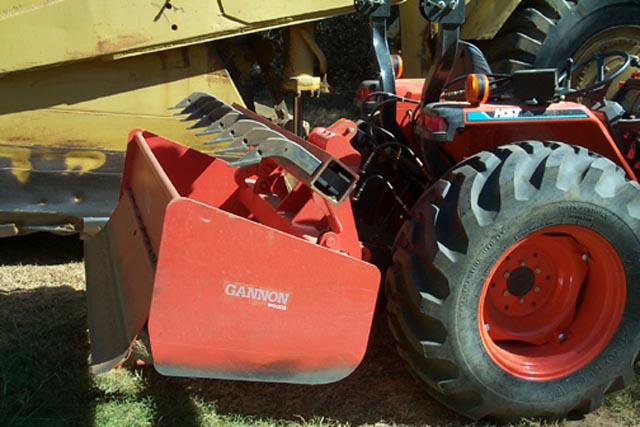

I have had good luck with Gannon box blades by Woods. The model I have is a 6' 4272HD High Back (picture attaced) for a L4310. Very heavy construction. Top-N-Tilt controls are a must if you will be doing a lot of box blade work. For occasional work, the manual 3PH is fine. Be sure to get one that is wider than the tires.

Mulkey, thats the one. You have a great boxscraper there. Gannon/Woods also manufactuers the ones made for Kubota when you buy it as a Kubota part. Rat
