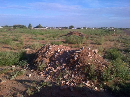

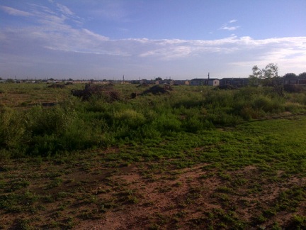

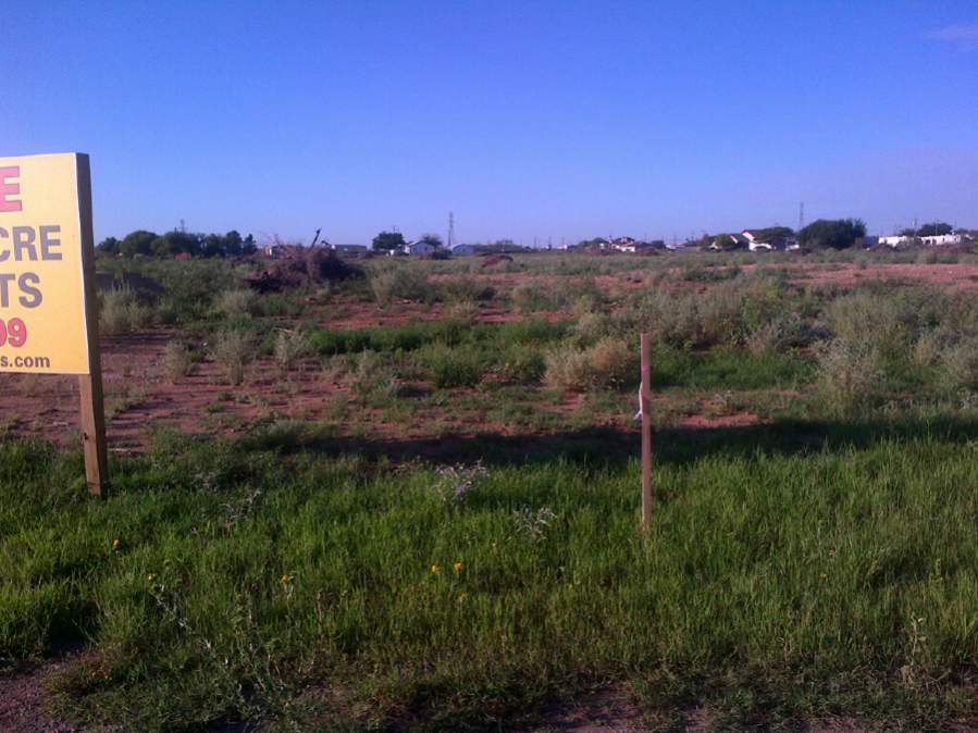

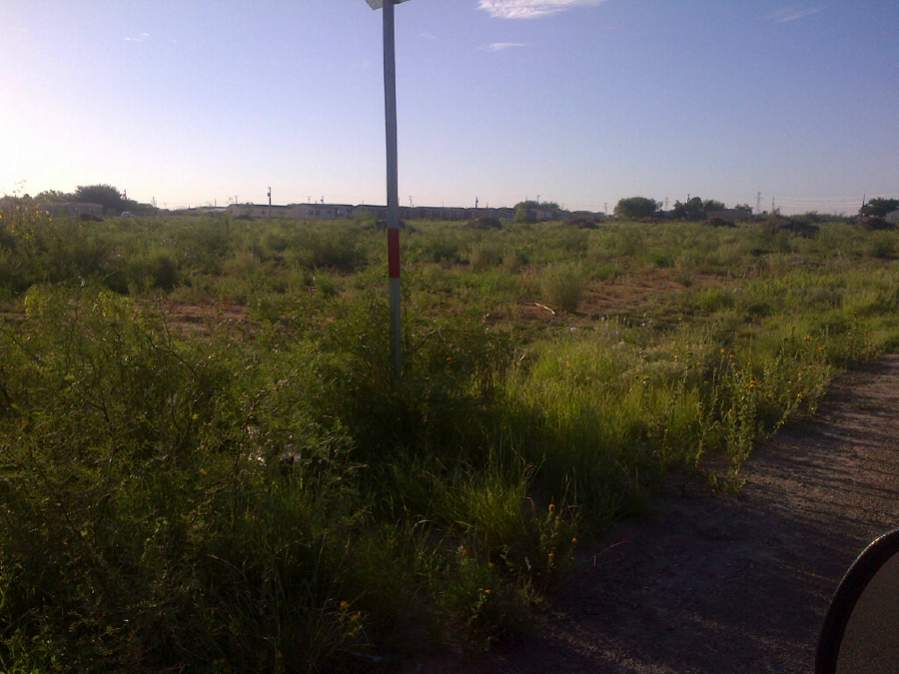

I am bidding a land clearing job out in far West Texas. The owner wants 8 acres cleared of a low scrub brush and the brush hauled off.
My plan is to use the dozer blade on my skid steer to scrape up the brush into piles and then use a grapple rake to shake out as much dirt as possible and load the brush into 30 yard roll-off containers.
How can I estimate the cubic yards and tonnage of brush that I will be hauling?

What about cutting/mulching up the brush tops with a rotary cutter down to 8-10" high then using your skid steer/dozer to remove the rest? From the pics it seems there isn't dense 2-3" thick stuff so a rotary cutter should do it?
This would reduce the mass of material to remove by at least 60% or more I would think and your cost and time too.

Good thought. that would sure help with the compaction. From what the pictures show (I haven't seen the site up close and personal yet) it doesn't appear to have a lot of woody material in it. Looks like mostly just weeds. I would guess that there is a little mesquite in it, but not much.
I am going to schedule a trip out there to take a closer look next week so I will have a better idea then.

After the pictures finally loaded (anyone else have trouble viewing pictures using the app?) I would rent a skid steer mounted hydraulic bush hog for that job. Nothing looks over 4-5" thick, couple passes and be done; if customer would be OK with that.

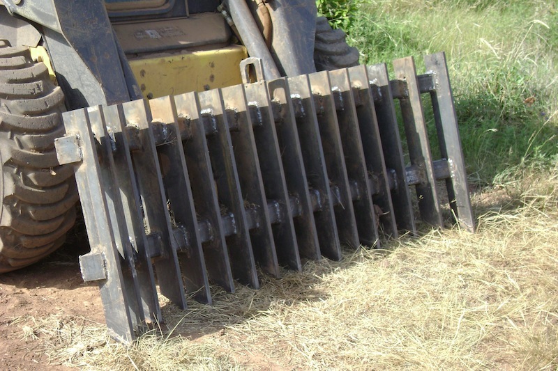

I am now thinking that my best bet is to windrow the debris. Then I can get a better idea as to how many containers I will need. At the end of the job I can call for the needed containers and load them out with a grapple fork on my skid. I can windrow with this:

I am still looking for a way to get a rough estimate of the volume of brush (in cubic yards) that will need to be removed based on the pictures I have provided and the acreage (8 acres) if anyone has any ideas.
