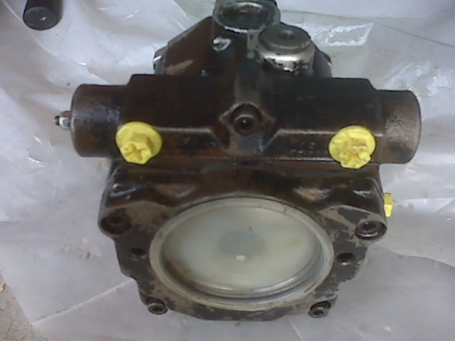

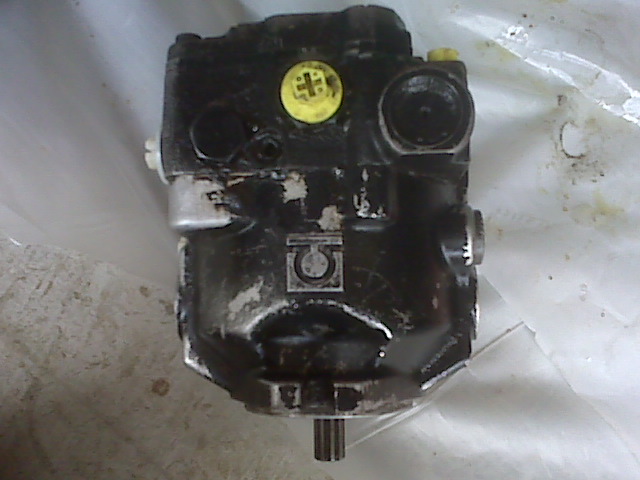

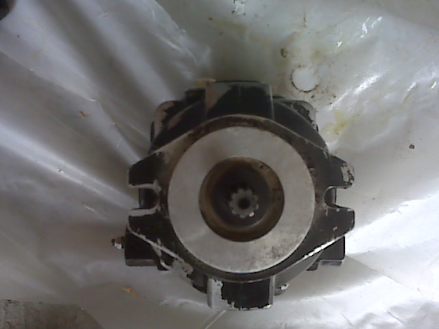

I would love to educate myself on this pump but I don't know the brand or model. From these picture can anyone here identify at least the brand so that I can begin the search?
If this is the same pump try this link. Bondioli & Pavesi
Hope it helps. I think there is a US distributor in Ashland, VA.
Thank you, this indeed looks like the brand of my pump. I'll contact them directly to get more information!
