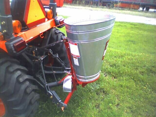

I did end up buying the M96.
I've not tried it on the TC24 yet, but since I have Pat's Easy Change and since that extends the lower links out a few extra inches, I may be able to get by without cutting the PTO shaft?
Attached is a photo of the Herd spreader for anyone interested.
As they are the only American made spreaders I found, I really am pretty happy I got it. I don't mind buying foreign, but if I can I like to actually support our own economy!

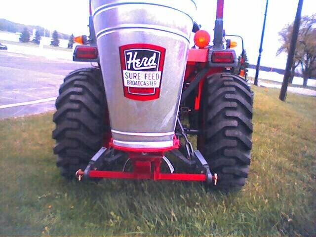

Here is a rear view of the Herd seeder.

Bob, that looks real good.
I think I may buy the same one. Looks like a well made unit and after doing a couple searches I don't think I found anyone who did not like theirs...
Look forward to hearing a report of how well it actually works for you. Should be pretty good I am sure.
Thanks for the pictures... /forums/images/graemlins/smile.gif
