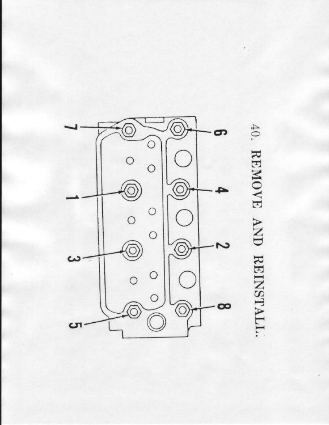

Mar 5, 2006 / HELP YANMAR YM2610 #1 L lynn_florida New member Joined Mar 4, 2006 Messages 11 Can anyone help me out with the torque settings on the head bolts and tightening sequence on the 3 cylinder in my 2610 thanks /forums/images/graemlins/confused.gif

Mar 5, 2006 / HELP YANMAR YM2610 #2 L lens12 Veteran Member Joined Apr 7, 2000 Messages 2,127 Location Dixon, Il Tractor ford 9700, tw30, massey, jd2030 jd4010, yanmar F60d, ym330d, ym276d,ym226d,ym186d, ym2000, ym155 Start at the middle & work your way out. I don't have the specs , but they should be the same as JD950.

Mar 7, 2006 / HELP YANMAR YM2610 #3 1 1danny Platinum Member Joined Jul 12, 2003 Messages 617 Location Thorsby Alabama This is what I have for the Yanmar 3T80 engine. Three steps. 1st 45ft lbs 2nd 88ft lbs 3rd 118 - 133ft lbs. See attachment Danny Attachments 838631-Scan10005.JPG 96.1 KB · Views: 463

Mar 7, 2006 / HELP YANMAR YM2610 Thread Starter #4 OP L lynn_florida New member Joined Mar 4, 2006 Messages 11 Thanks Danny that was what I was needing was the torque specs for the head bolts appreciate the help LYNN /forums/images/graemlins/cool.gif
