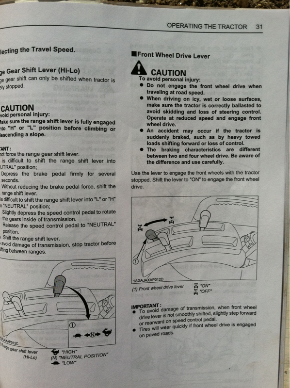

Make sure all levers are fully moved to proper locations and speed set is in unlock position.

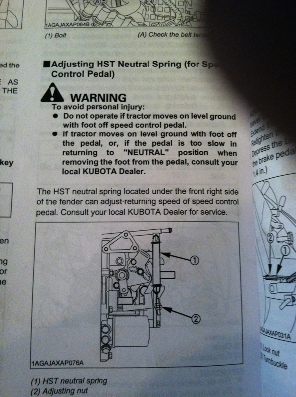

DIAGNOSTICS COMPLETE: I figured out what is wrong..now how to fix it. I raised the tractor up by the FEL, put blocks under the wheel and locked the FEL (just passing along my safety procedures :D) and could thus get the guts to REALLY inspect the linkages, and sure enough, way toward the back, there is a little bolt that attaches the linkage to the rotating arm that engages the tranny. Looks like that nut can just rattle off over time, which it did, and the linkage is no longer connected - explaining all the symptoms. Thanks to all for all your ideas. The first reply ended up being the correct one.
NOW - how to reach up there and reconnect. there is almost no room to work with.

Normally a neutral spring attaches to adjusting nut. Is this the one missing?
