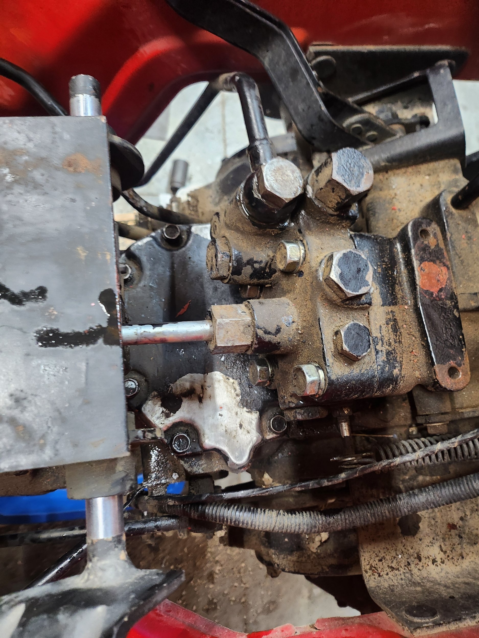

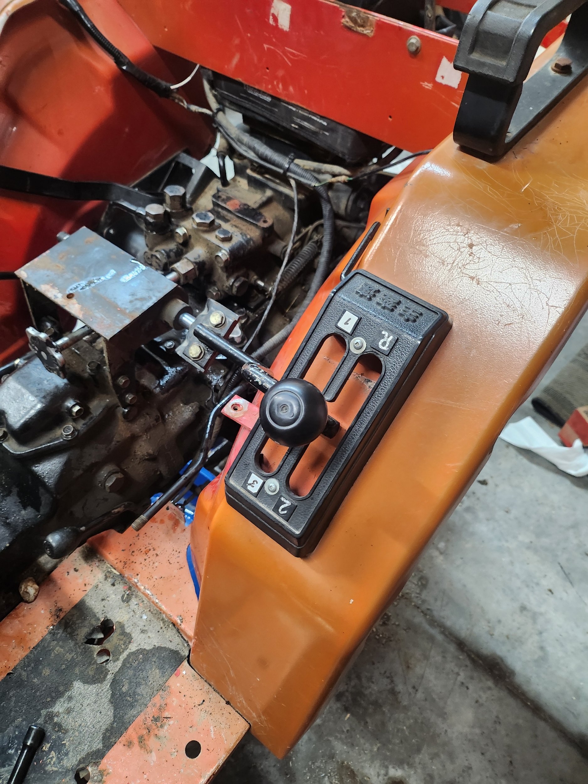

Hi,
I have a f16d tractor was using it today and switched between reverse and 2nd and it kept going backwards.
If it try to put it in 1 or 3 it will stall out if i out in the 2nd spot stays reverse.
Is there a linkage between the pin the shift moves and a gear somwhere?
Any help sith a transmission diagram or manual would be awesome.
Thanks

Tractor data says it's Gear! I have nothing on that setup with the shifter on the fender. I do show a YM F16D 4Wd. 19 Hp. 3 Cyl. But list it Gear Drive. The F1610D 19Hp. 3 Cyl. Power shift But the Shifter is on the Transmission between your legs. Nothing on my Org. parts for a F16D. Find a number on the Trans and try to Identify it?

Yea just trying to figure out what the pins under the coger the levers acuatlly move. I opened up the top fo the trans cover and couldnt see much.
Going to drain all the fluid hoping i can see a gear and pry on it or somtbing. I will look for a transmission identification

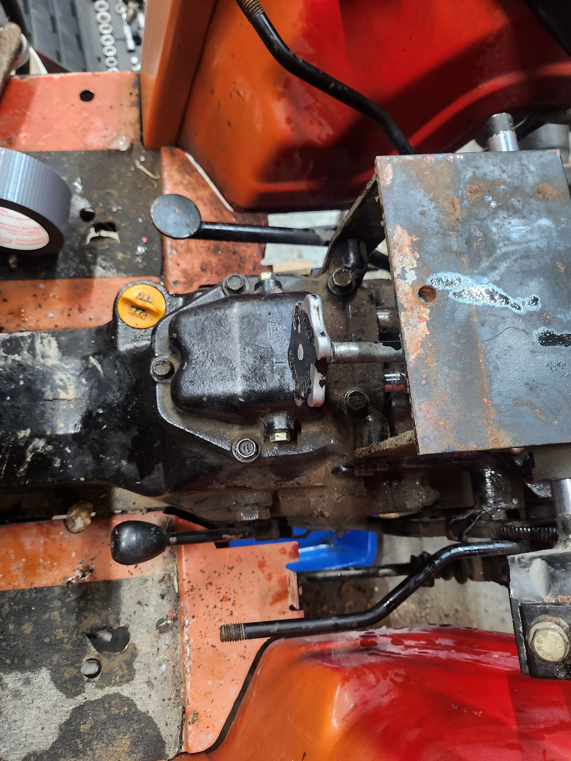

Well as expected the shift fork is broken, i was able to us a inspection camera to see and i can to the linkage which I noticed I cannot on the other side 1/3 shift fork. is splitting these tractors apart to get in there to replace this piece pretty self explanatory? any specials tools needed? I'm going to see if i can et the fork back together to get it going or find the replacement part.
thanks for any info i get.

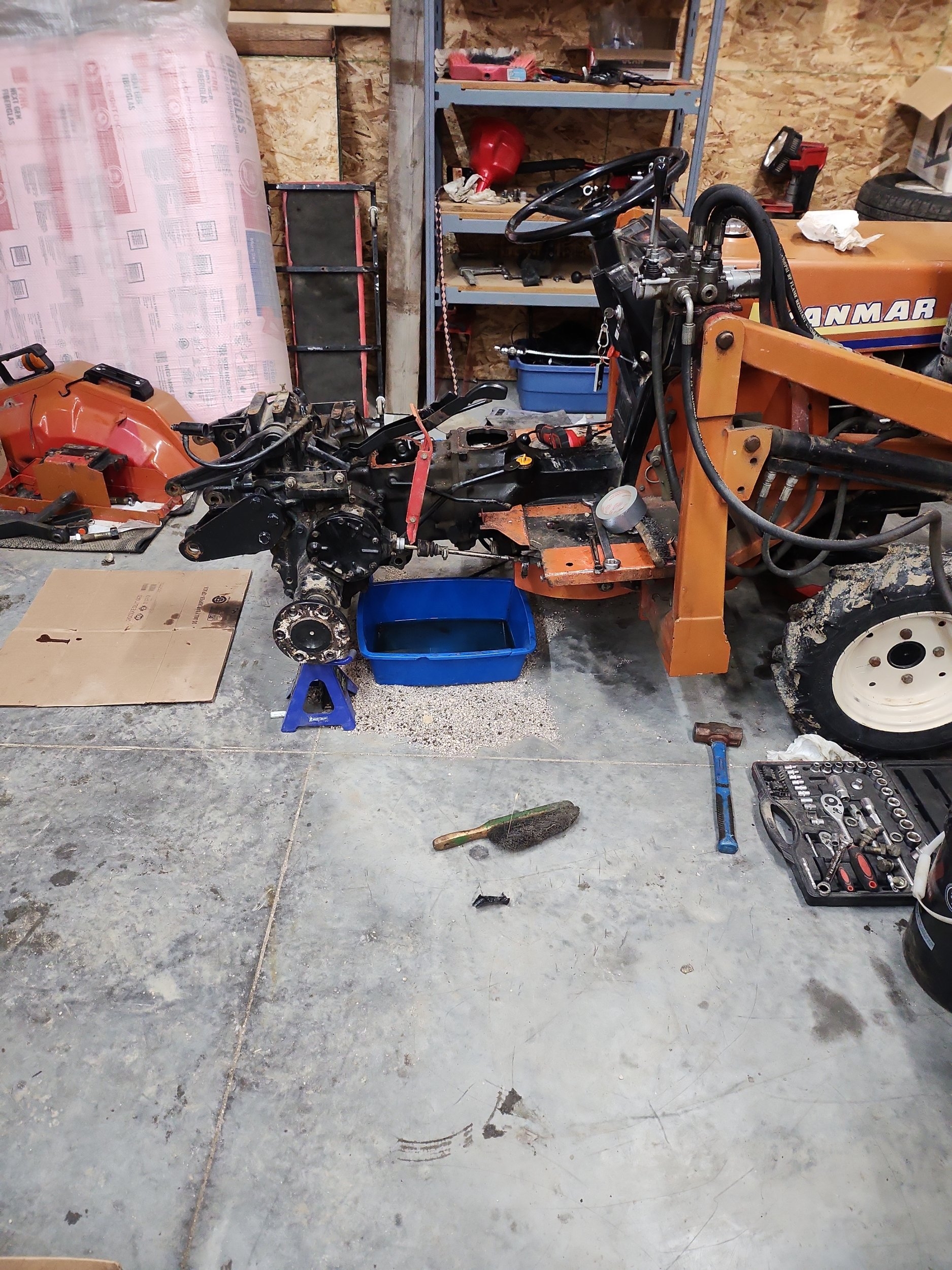

I got this far taking stuff off.
Can i break the tractor right here to access the transmisson? Does the clutch plate come with the back half?
I have a engine hoist i can borrow so will be using that to help remove this piece.
Thanks

I'm not understanding where you are talking about splitting the tractor but normal procedure would be where the bell housing (clutch housing) bolts to the engine.

I didnt want tk mess with bellhousing or any of the stuff close to m engine. I took apart the tractor here right in front of the transmission gearing and all the shafts that need to go either way were just in the bearings with no snap rings.
Was able to get my broken shift fork out. Now waiting to braze this piece back together unless anyone has one they want to sell me
