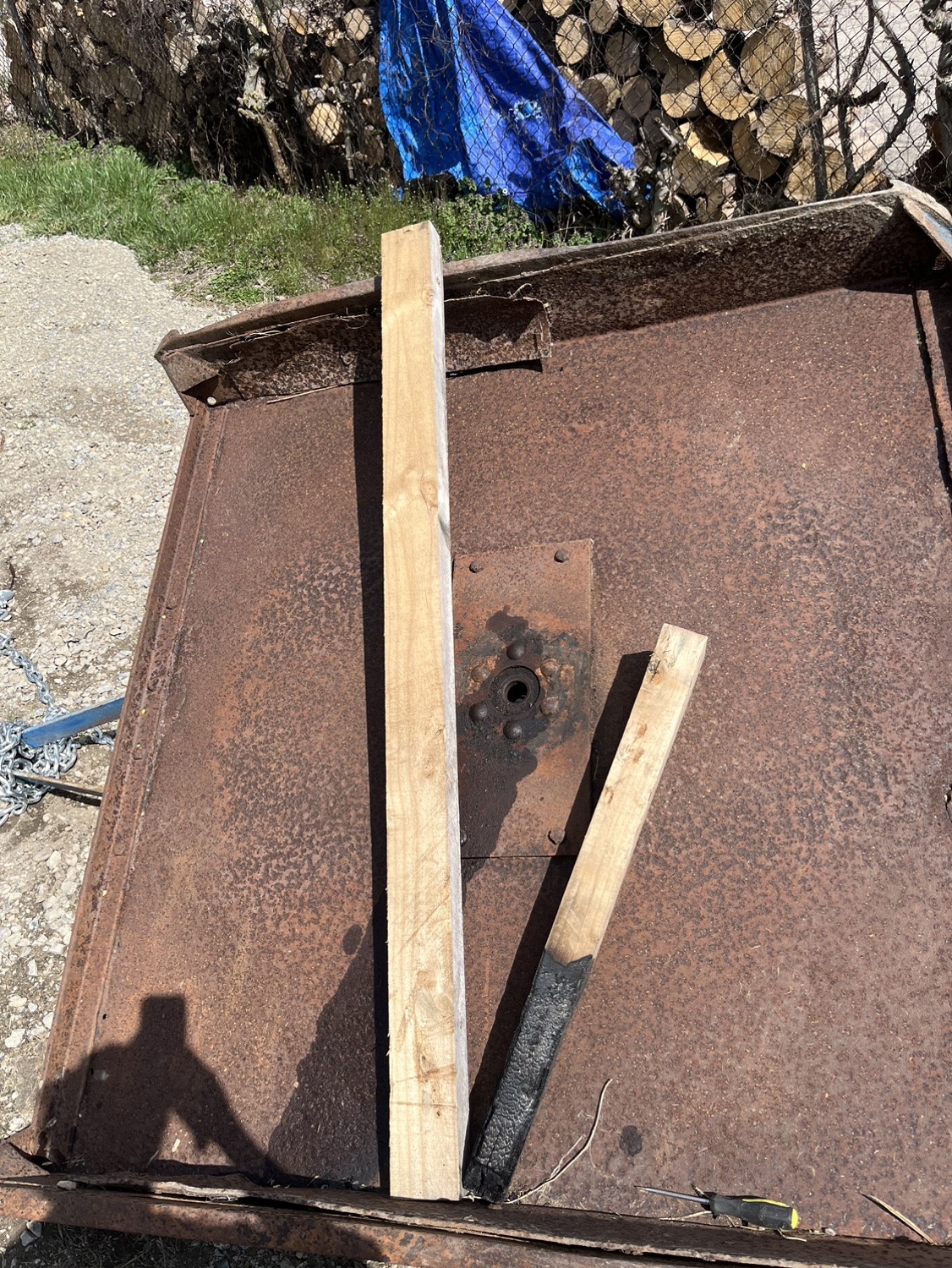

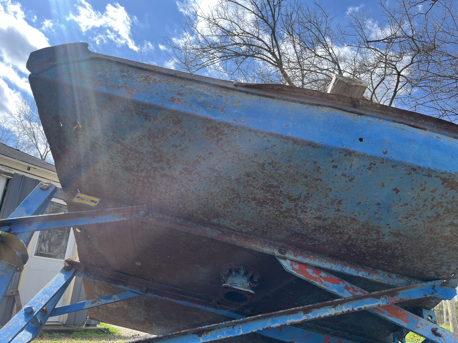

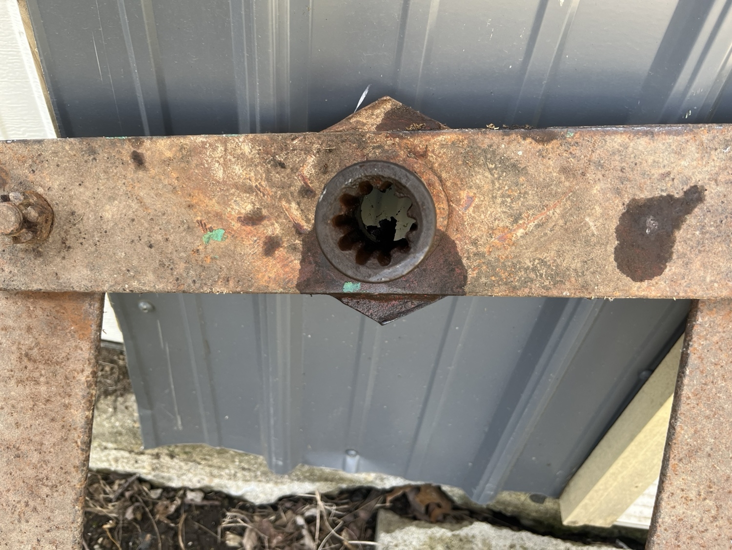

I just bought an older ford rotary cutter. It is missing the top half of the gearbox and the pto shaft(I bought the thing for $60). The best I can tell the model number on the tag of the whole thing is 22-151. I’m having trouble finding the correct gearbox for it. The output shaft is 10 spline. All I am finding is 6,12,15 spline with bolt on blade. My blades are on the splined shaft with a shear bolt and no threads for a nut. I’ve not dealt with any bush hogs before. Just recently bought a new place with 4.5 overgrown acres I’m trying to clean up.

I’ll take some pictures tonight and post them. I’m pretty sure I’ll end up replacing the gearbox, I’m just trying to reuse the blade mount and haven’t found one with the correct spline
/ Help with rotary cutter gearbox #7
Yeah, I'd assume replacing the blade/jumper assembly with whatever comes on the replacement gearbox. Especially if you go with something super common (eg. Woods or King Kutter), then blade availability becomes no problem.

So the spacing between blade hub is 16.5 and the blades measure 20.5 tip to hole

First off, as I see the pictures, this would not have been the brush cutter that I would have picked in order to do a 4.5 acre overgrown lot that I just purchased and wanted to clean up! There are way too many hidden obstacles in newly purchased lots that are unfamiliar to the new owner, and finding some of them with a cutter bar like you are trying to use is probably the reason the gearbox is missing parts. The splined fitting welded to a cross bar that holds the blades has no provision for things like hidden rocks, old engine blocks, well casings, (do I need to continue or do you get the picture?) The flat side tends to hit the hidden object and stop the swinging blades and something in between the engine and the blades has to give. Slip clutches, shear pins are typically the weak link, but old gears can only take so much before they give way.
Since you are replacing the gearbox, I would seriously consider looking for a rusted out deck with a gearbox and stump-jumper still intact, hopefully with blades that will fit your deck. Blade length can be adjusted a little, but usually not enough to go from a six footer to a five footer, etc, so look for rusted out decks in the size range you currently have.
