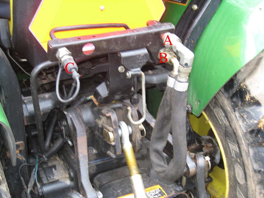

Folks,
I'm looking for some guidance on hooking up a 3PH log splitter to my JD4300. The previous owner had a back hoe and I believe had the power beyond kit installed. I've attached a photo of the back end of the tractor.
My log splitter mounts to the 3 point hitch and has two hydo lines, one supply, one return. Where should I hook the log splitter lines to? I've labeled the tractor hydraulics as A, B and C.
Thanks.
Mark

Hi--I believe that you should connect to A & B as C is used when the BH is on (disables the 3PH). If you connect to A & B then you can use the 3PH to raise the splitter to a comfortable working height.

B8FISH is absolutely correct, happy splitting:D
/ Help with power beyond and log splitter #5
They are correct, but you should make sure you connect the hoses correctly. In other words.. make sure the flow is going the correct direction from the tractor to the splitter and then back to the tractor. You will need to have hydraulic hoses made. You can get the correct ends for the hoses from your JD dealer and then have them attached to hoses from someone who makes hydraulic hoses... you also need to make sure you know what size the fittings are for attaching the other end of each hose to your splitter.
/ Help with power beyond and log splitter #6
Having the same setup on my 3120, I'm curious about the direction of flow and how you detemine which direction other than trial and error. Would it be out A and in B, or are there markings at the fittings that I haven't seen?

OK guys, this is simple...
The fluid flows OUT of "B", the fixed hose. And can flow IN to either port "A" or "C". But as B8FISH already said, Plugging into the "C" port will disable the 3PH, while the "A" port will not.

KennyD--are you sure that it doesn't flow out of A?? At my dealer I saw a 3520 set-up with the BH on and the "hose" was not connected to anything. Dealer said that you needed to connect the hose (B) to get the BH off and on and use connection C to operate. Looked at JD Parts and it seems to confirm my suspicipion as well. A seems to be the "main" supply.
B8FISH,MLIP, and Hankus:
I stand corrected, I jumped the gun on this one... The main supply line is "A", with "B" going to the 3PH, and "C" going directly to the tank, bypassing the 3PH.
So "A" should go the the "IN" of the LS valve, then the "OUT" of the LS valve goes to the hose "B".
Also remember to match the hose and QD size to what you have on the machine now, this hose has the hydraulic flow of the whole machine going through it, you do not want to restrict it.
I sincerely apologize for any inconvenience I have caused...

Thanks for the guidance, got it hooked up and running today. Works great, now We went through almost 5 cords this winter, now its time to stock up for next year. I just need to keep those boys working on the woodpile and keep their fingers away from the nasty bits of the splitter! I really like this set up since I can lower the 3ph to roll big logs on that are too heavy to lift.
